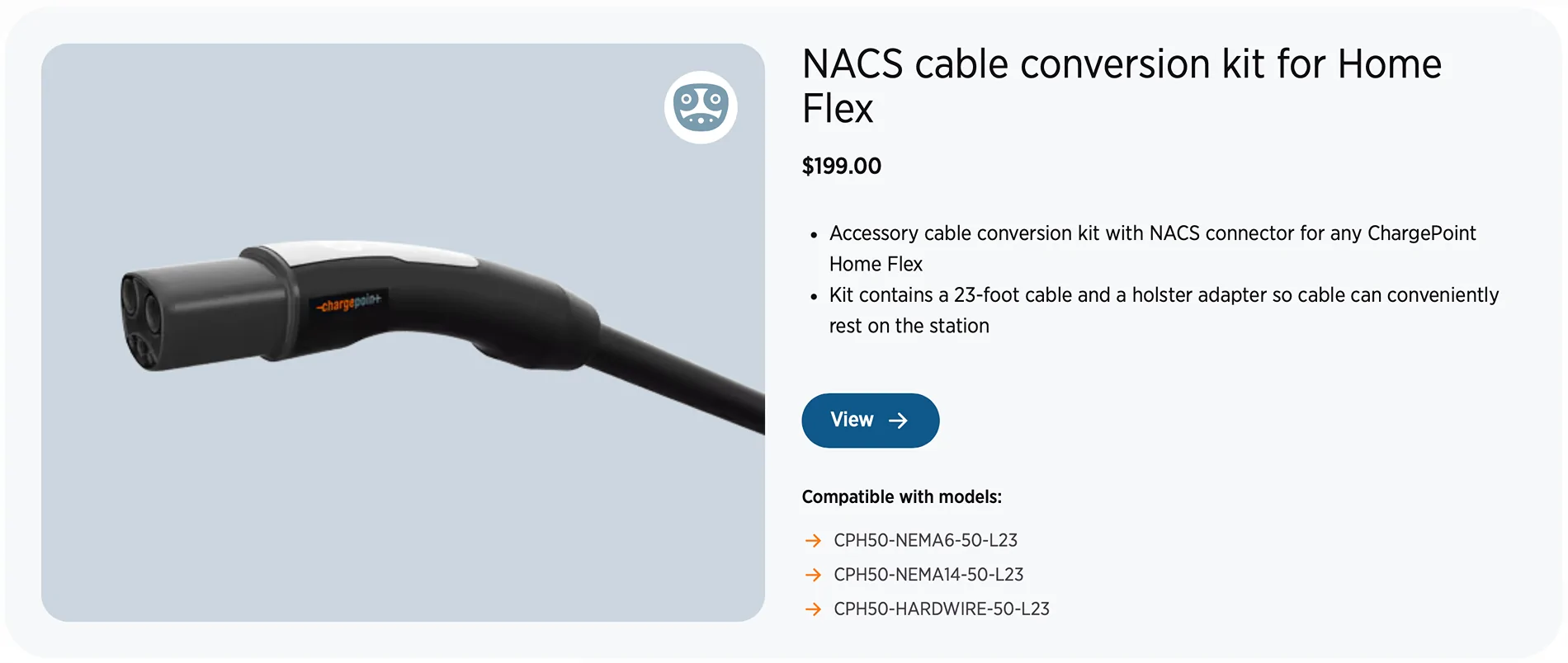

How long until you get your next EV? If the answer is longer than about 3-4 years, then I would get a J1772 charger. You don't want to use an adapter long-term. After 4+ years, you can sell the EVSE and get a new NACS one (or just replace the cable, depending on model) with your next EV.
When I get my next EV with NACS, I plan to replace just the cable on my ChargePoint (they sell a NACS conversion kit):
Ford Mustang Mach-E Which Standard for Home Charger Screenshot 2026-06-17 at 5.23.57 PM
