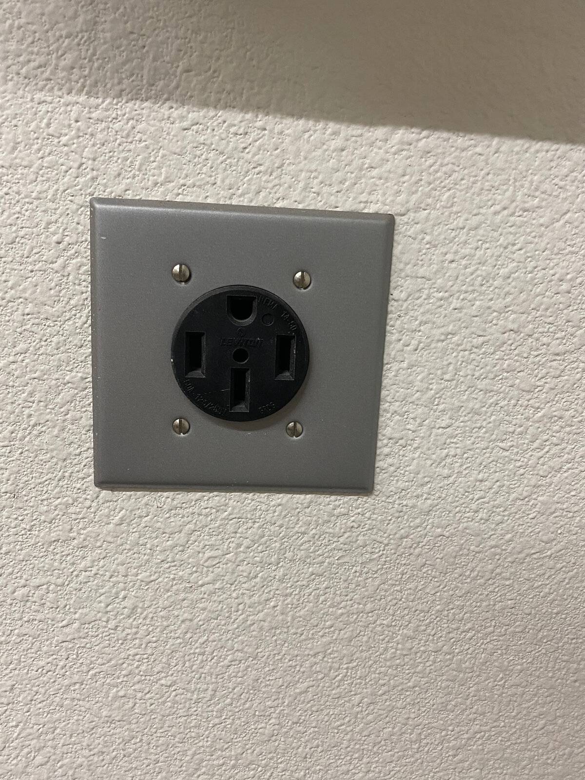

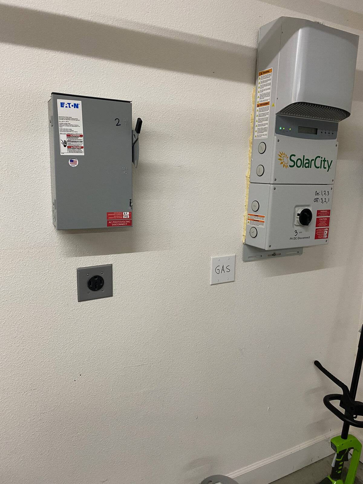

Shouldn't typically be any cost savings from an electrician for wiring a 14-50 outlet vs a hard-wired EVSE. In fact, the outlet probably costs a bit more (the cost of the outlet/box/plate, although that's just a few bucks). Terminating the connections to an EVSE is no more work than terminating the connections to an outlet.
Interesting points on my home EVSE choices, FWIW: I had only 120V in my garage so I had the electricians install a 14-50 on a 240V 50A breaker and 4ga. I am plugging the Chargepoint Home Flex into the 14-50 for now to maintain the ability to use a different EVSE (or the outlet for something else), but the 4ga gives me some future options. It was only a buck a foot more than the 6ga.
The 14-50 installation was slightly more costly than the direct wire (about $25), but it also saved me the trouble of making a decision about how to change gauges since I believe the Chargepoint accepts 6ga maximum when direct wiring.
The 14-50 accepts 4ga maximum, and it was fine except the bend radius/geometry of the 4ga wire entering the back of the 14-50 was such that the electrician had to install a larger box than a normal double-gang.
