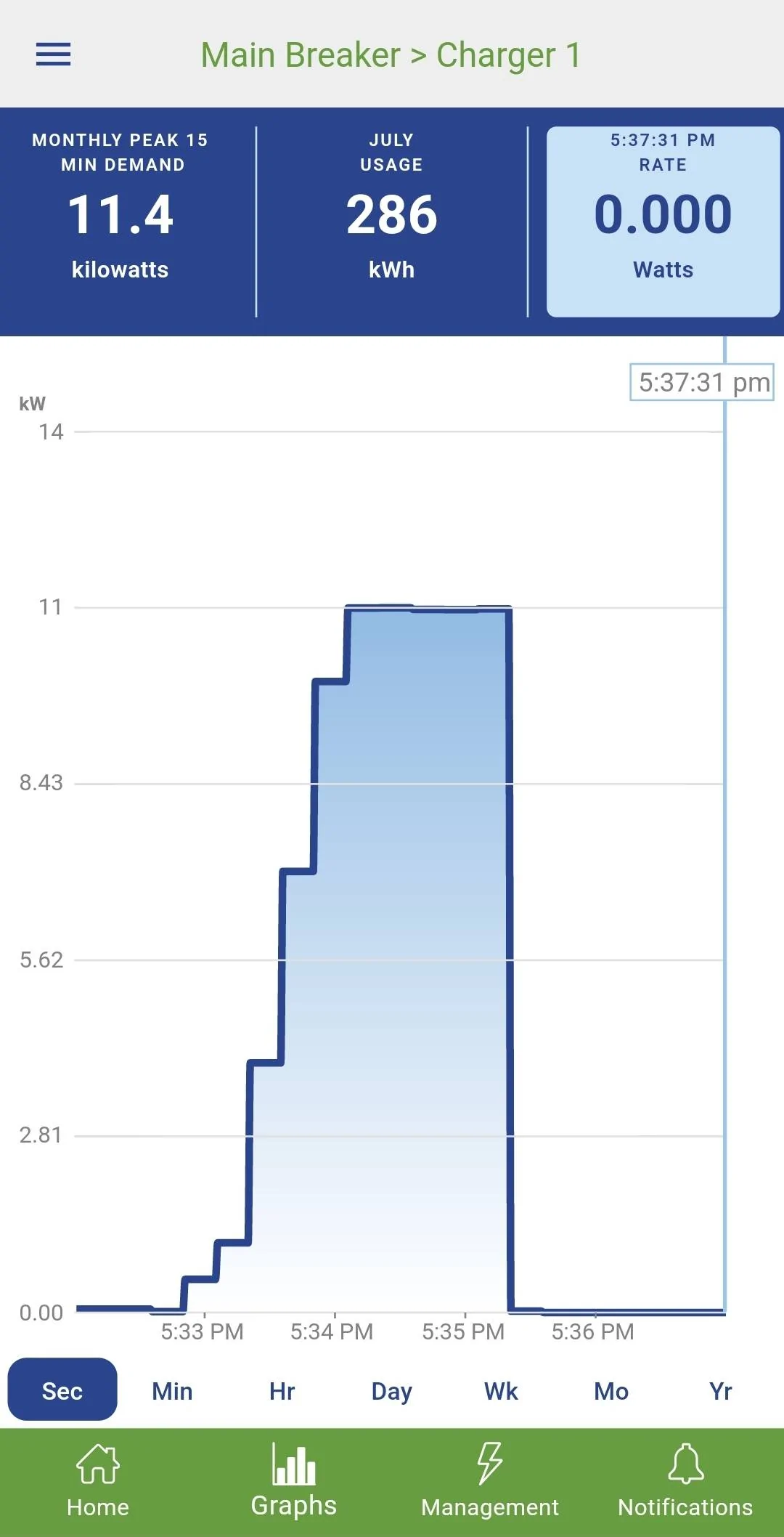

So the update competed successfully this afternoon. I planned to start it right after the charge finished, but I was in meetings and could not. So it sat for a couple hours, connected to the charger, fully charged.
I left the car connected to the EVSE, and selected "update now". I turned off the car, turned off the headlights, and exited the car. While it did the update, the car pulled some decent power from the EVSE:
Ford Mustang Mach-E Priority Update 23-PU0110-RAD-PS just dropped Screenshot_20230804_201924_Emporia Energy
If you are having trouble getting an update to complete, try charging your car and keeping it connected after it finishes. It worked for me.

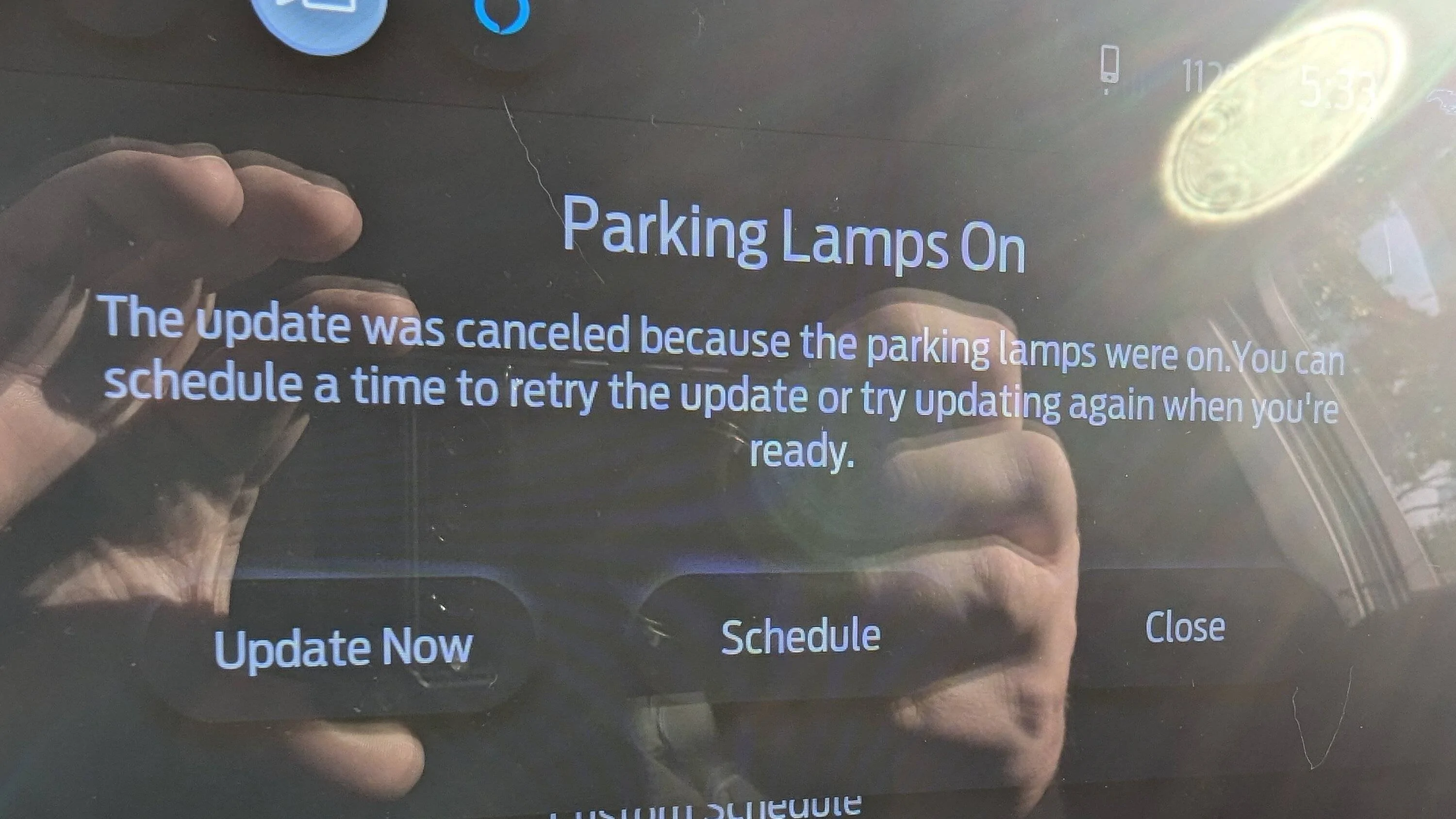

Mine failed because of the stupid headlamp switch that's defective. I had to go into the car and turn the knob to get it to get out of it's funk. Yet Ford refuses to replace my headlamp switch...
That's why I turned my headlights off before getting out of the car. It is very interesting you were notified regarding the reason for the failure.

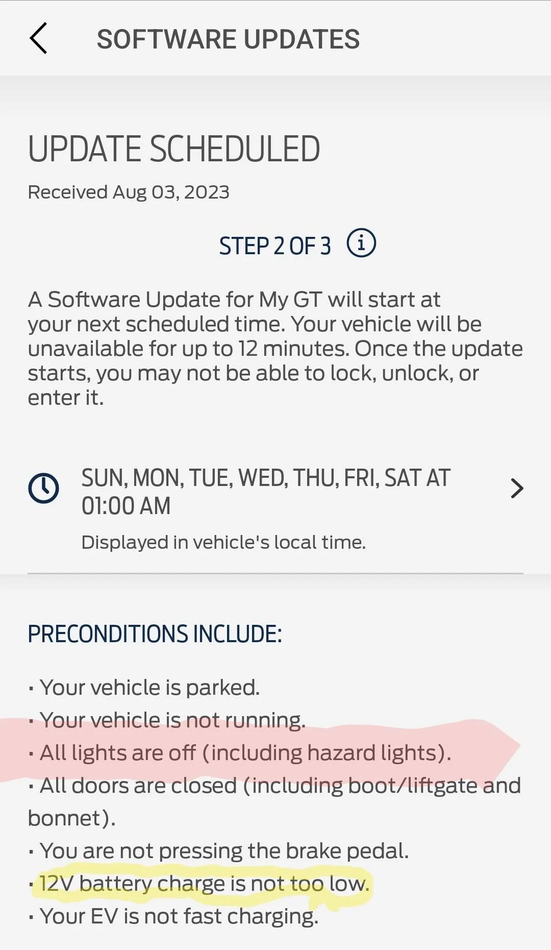

I know it seems funny and it is but with Fords systems, having to turn the headlight switch off in the first place is crazy.
but it’s a Ford.
Headlights off is a precondition for applying an update.
but it’s a Ford.
You don't have to turn it to the off position. It's just when it gets into it's funk and acts up that it causes issues. Some of us have defective headlamp switches. I turned it to auto and it updated after that. I never turned them off.
