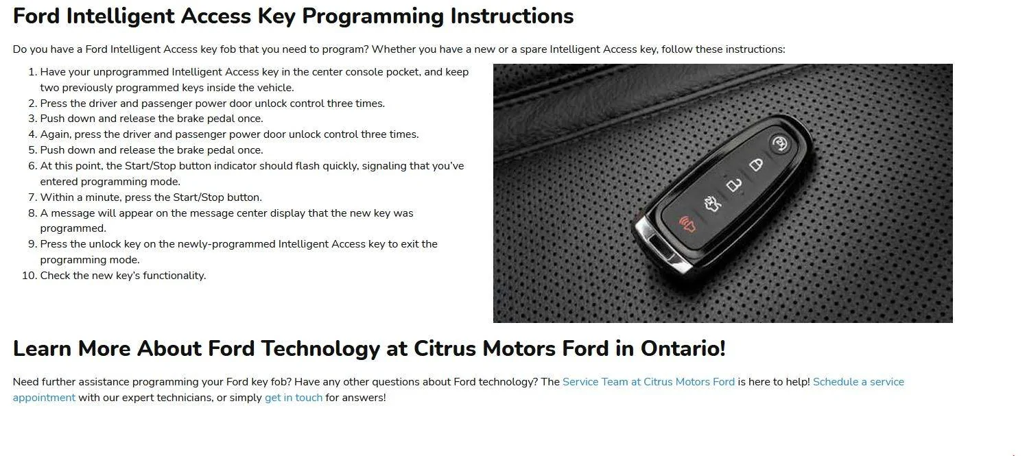

dw0095
D
May 26, 2021
46
46
Upstate NY
MME Premium
He spent a half hour trying to figure out where to insert the (uncut) backup key because that's how you program every other Ford. LOL!
Granted these instructions say you need 2 keys but I don't see anyplace where you need the physical key
Ford Mustang Mach-E Purchasing and Programming another FOB Captur
BMT1071
Mar 21, 2021
3,197
4,377
Glendale, AZ
21 MME SR RWD, 23 MME GTPE
EV Technical Trainer
I'm really hoping @OlyPen was kidding about that part.
