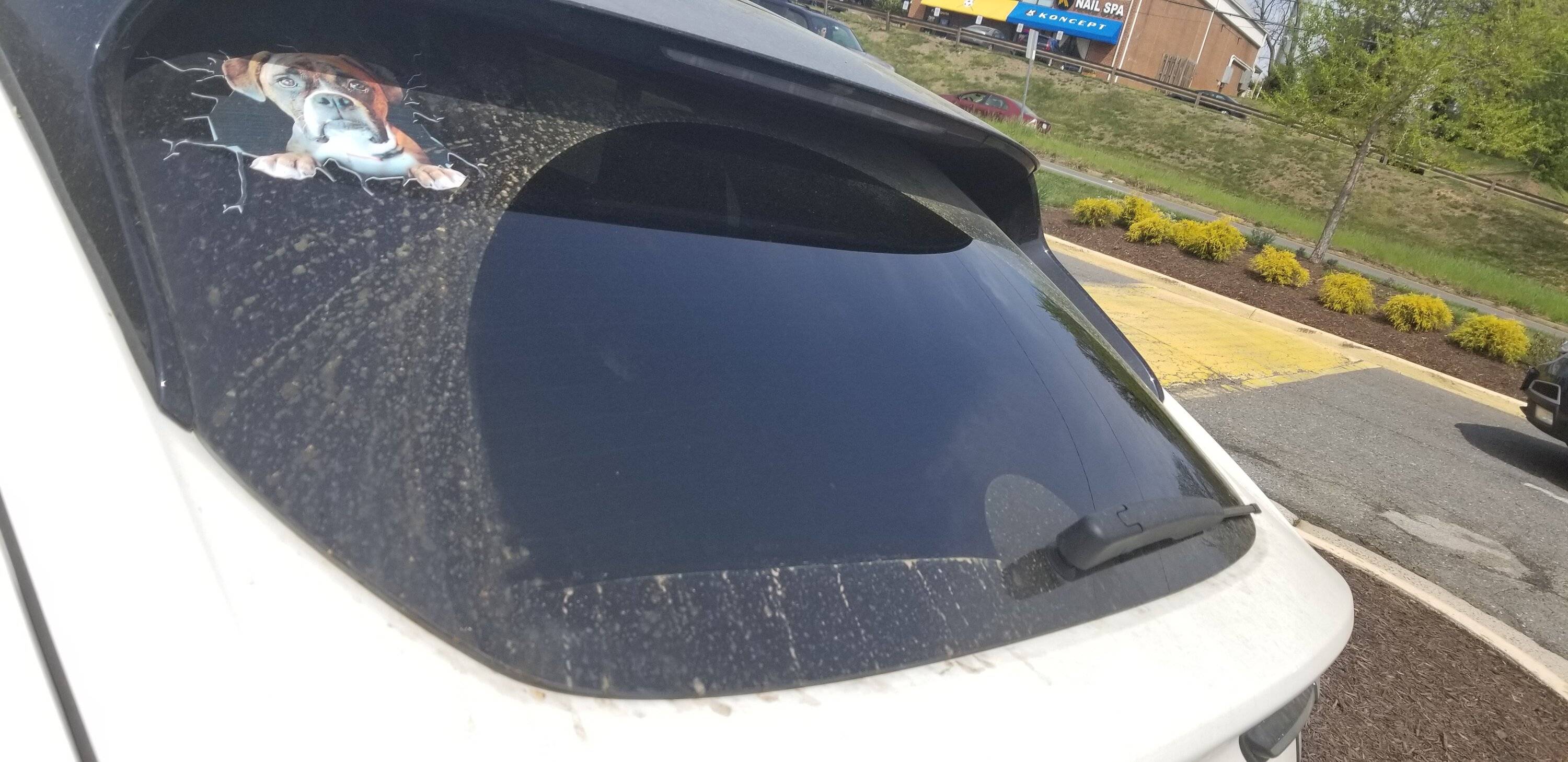

It's pollen season here in Virginia. Walking by my car yesterday, I noticed the 16-inch Bosch A 401h wiper blade sweep line, both on the top and on the bottom by the wiper arm pivot point. IMHO this pic speaks for itself.

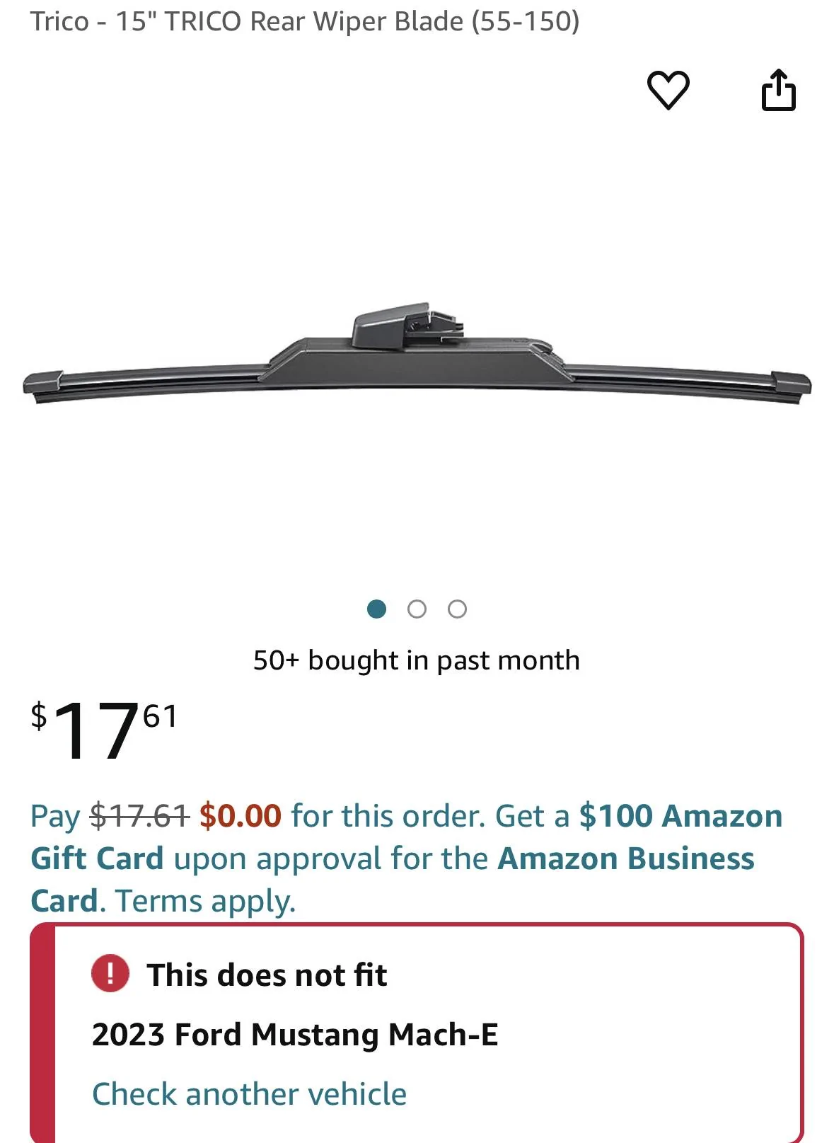

Amazon says the A401H doesn't fit the Mach-E. Of course, I trust users in this forum over some algorithm any day ?. Ordering....

was going to order but saw this warning?!? So
It’s going to tell you that, since this is not a direct-replacement part. Kind of like putting a 7 liter engine in where a 5 liter originally resided (or in my case a 7.5 where a 6.6 was). ??

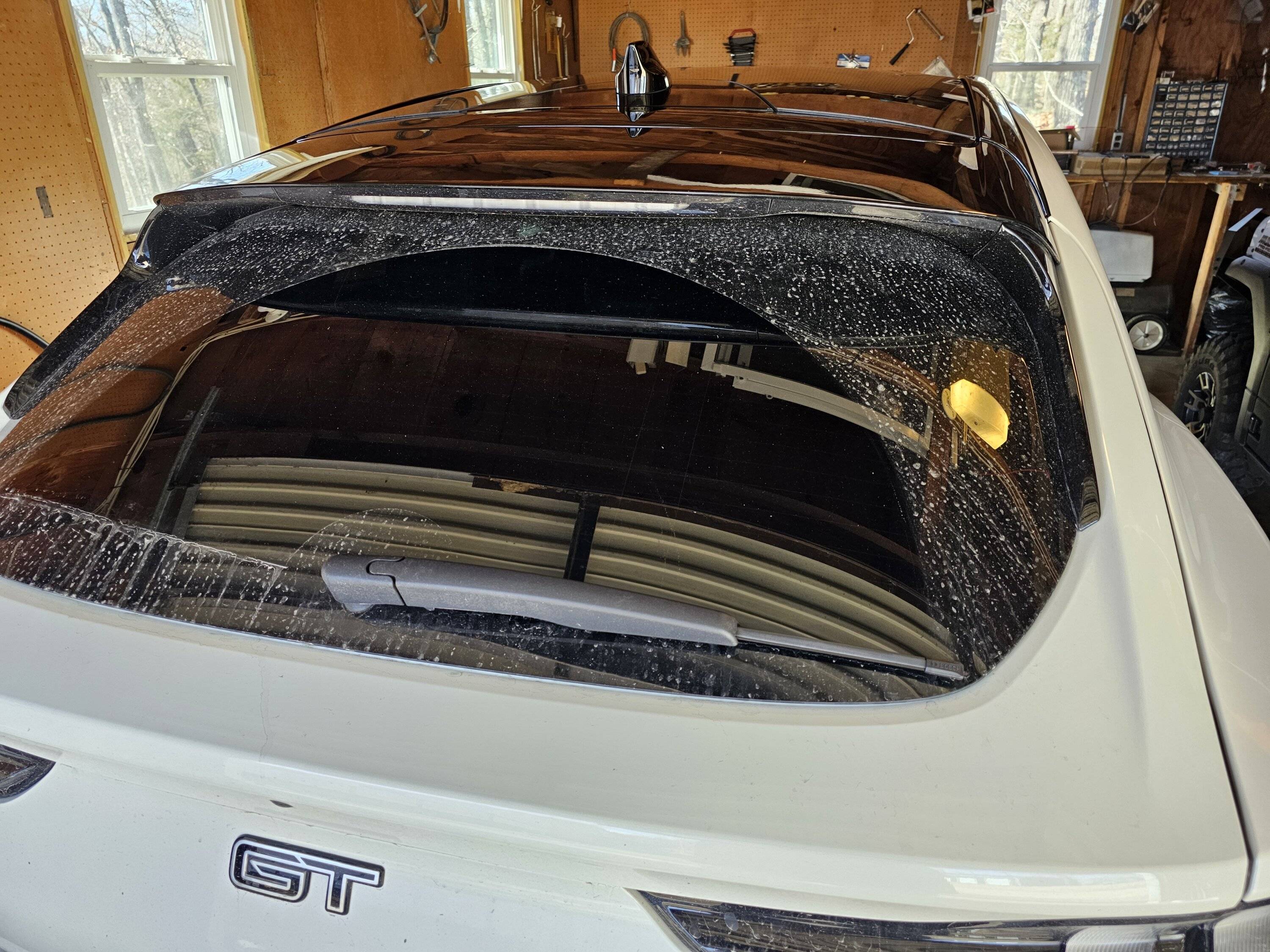

I was having a hard time finding the specific blades mentioned in this and similar threads in a store anywhere. My local O’Reilly’s Auto Parts had a Bosch Spectrum Direct Fit R1521 that works perfectly. Full contact with the glass along the whole blade, and goes right to the edge of the glass at the bottom. It has a little plastic locking cap that comes off easily, then it snaps tightly into place.
Ford Mustang Mach-E Rear wiper blade - longer replacement? 20240110_133154_Original
Ford Mustang Mach-E Rear wiper blade - longer replacement? 20240110_134901

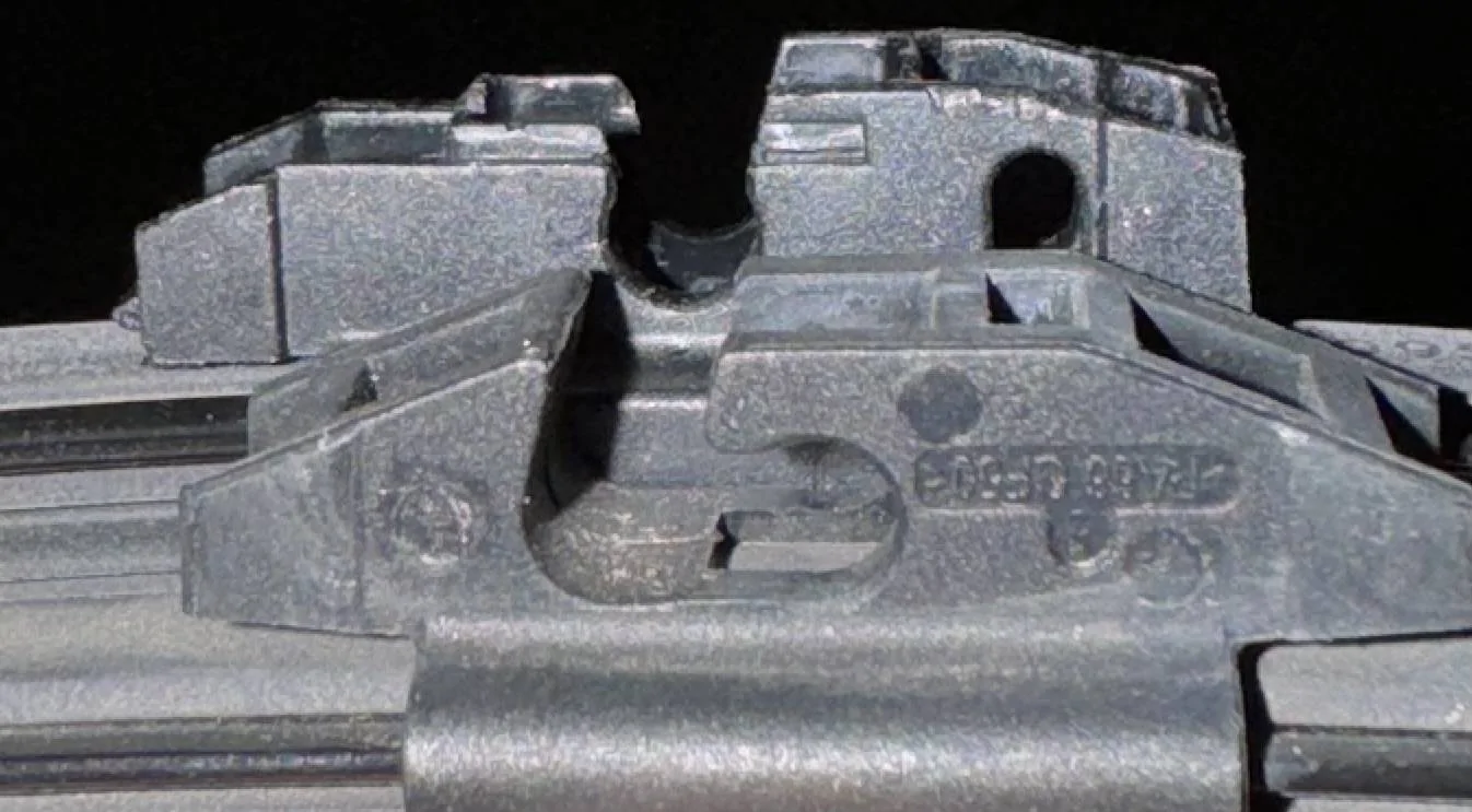

For those who have used Bosch replacement wipers, have they stayed on well? I decided to try a Bosch A351H, it is a 14 inch wiper. The wiper clicks in fine, but the Ford OEM wiper seems more stable because the connector is L shaped, whereas the Bosch just pops in and out.
Comparison pic of the connectors below - the Ford OEM is in the foreground while the Bosch A351H is in the background.

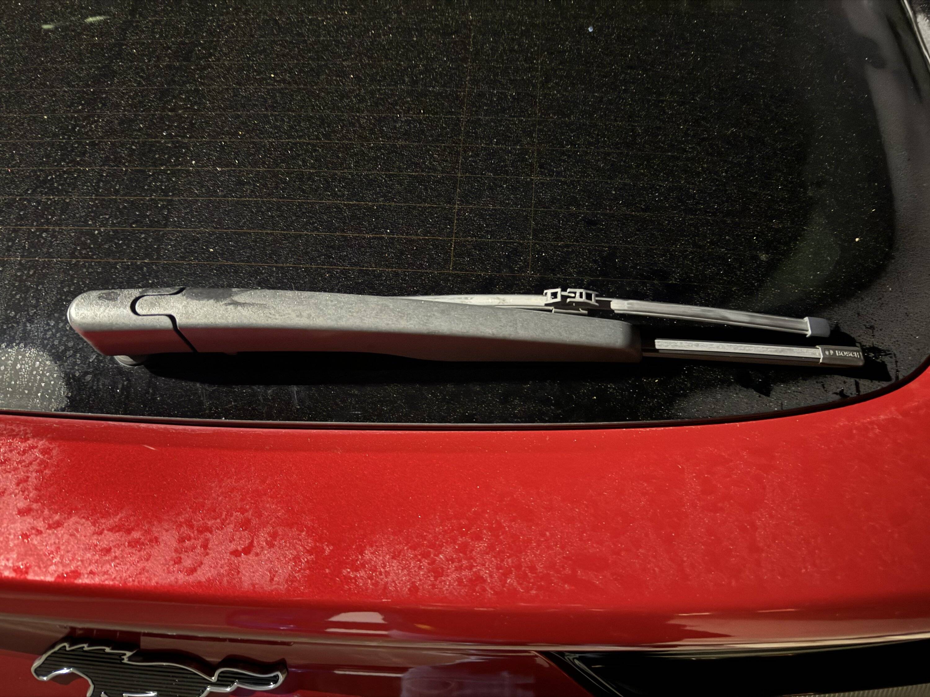

My 16-inch Bosch works great, even with occasional ice on the hatch
