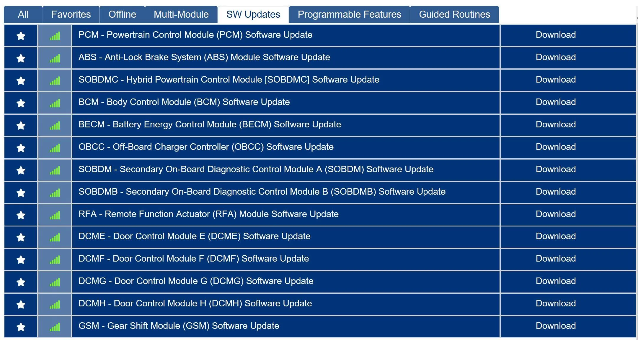

What updates have you had done on the car? Since it looks, by your profile creation date, that you have a Job1 vehicle did you get any of the 12v battery TSBs done?
If you want me to check, send me your VIN via DM and I can see what updates you got and haven't gotten.

Yup I got it.
So your vehicle was built after the 12v issue. But you still have a number of updates that need to be performed, many of which are part of 21P22 and it won't cost you anything.
Since you are having issues I would call and schedule a service for 21P22 and tell them of the faults you are receiving. Many of the updates in the below list are battery management updates.
I'm not claiming that these will magically fix everything, but since your car is 8 months old and never had any updates performed I would get these done.

Thanks so much for your help. I'm having problems with the doors taking multiple button pushes to open, so hopefully this update will will help with that too, since I see DCMs listed. You've helped so many people on the forum Ford should put you on retainer. Thanks, again, Paul
