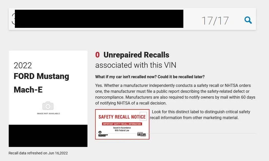

My apologies if this has been addressed already, but there is no way I can read through 75 pages of posts.
Can someone tell me if the NHTSA has been notified of all affected VINs yet? As of today my 5/25 build date car still shows no recalls, so I'm curious if its too soon to get my hopes up.
Ford Mustang Mach-E Safety Recall 22S41 - 2021-2022 Mach E - HVBJB Recall [high voltage battery main contactors may overheat] 1655422834990
