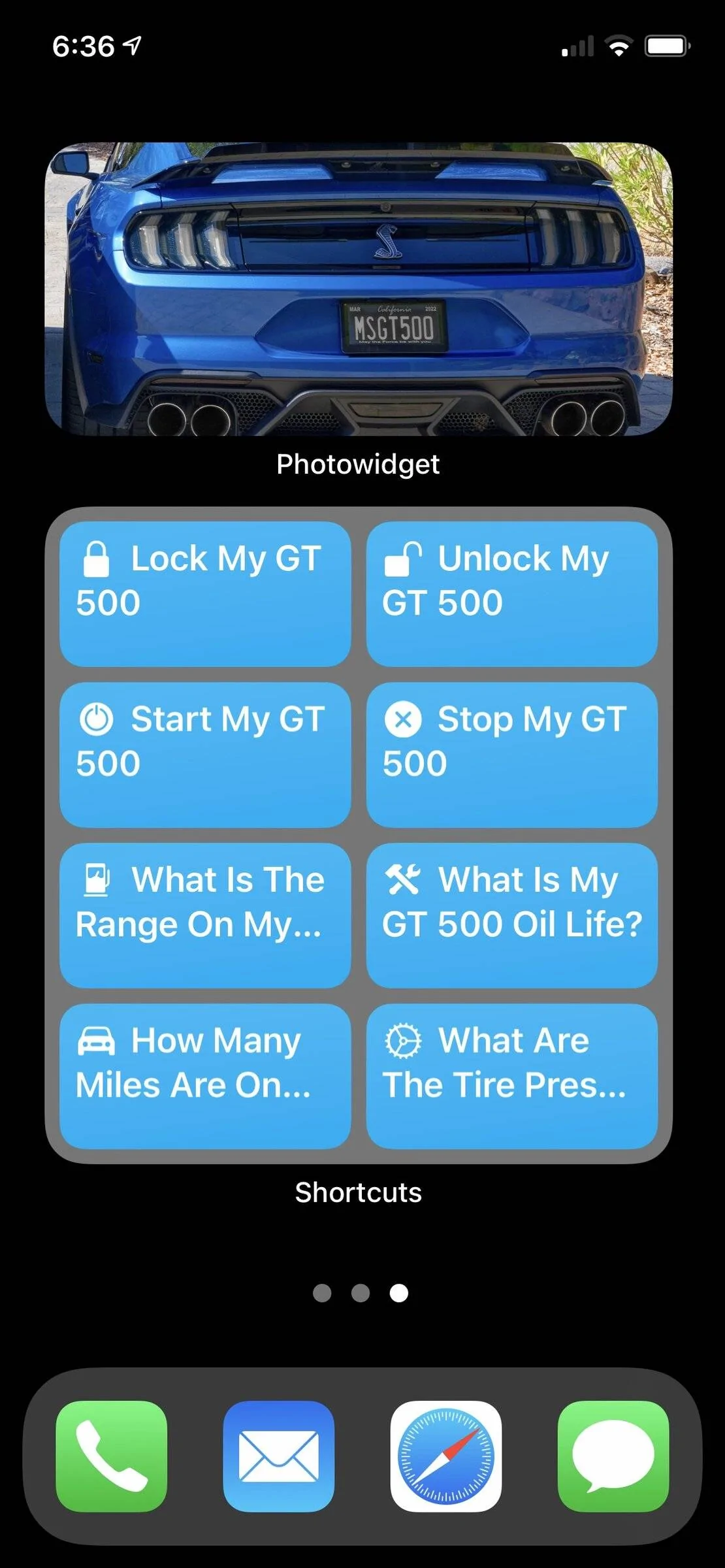

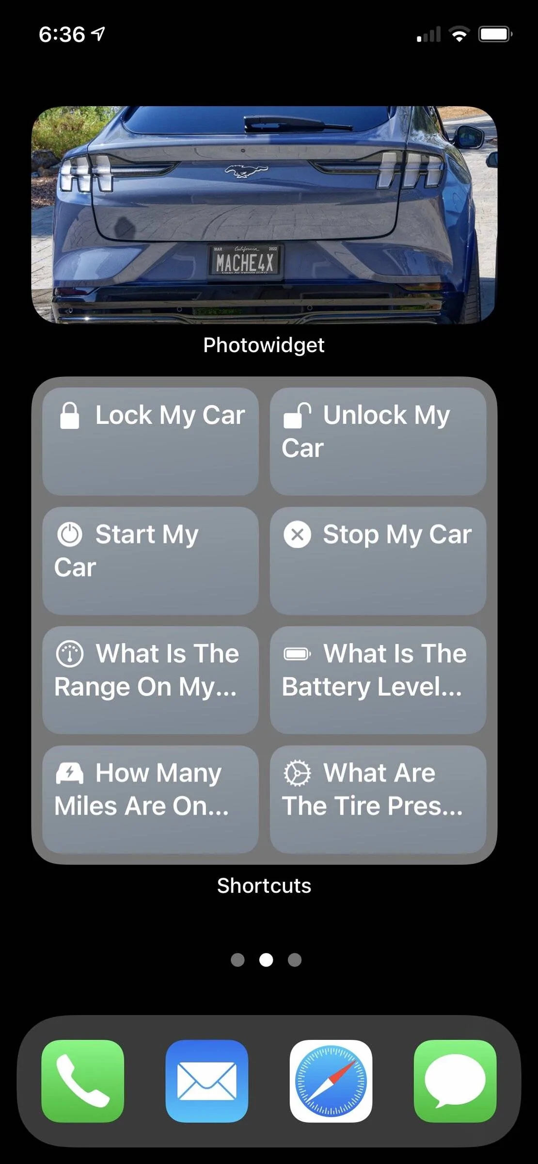

I know this thread is about the FordPass Widget, however I would like to ask tonesto7 about FordPass shortcuts which is kind of similar.
Below are two of my home screens (have not updated the photo to Mach-E GT yet). I have more shortcuts that aren't shown here (Where is my Mach-E, Is my Mach-E Locked?, Is my Mach-E On?). The same shortcuts are on my watch. Even though I do have these shortcut home screens, I Siri 99% of the time to execute them so I don't have to take the phone out of my pocket. All the shortcuts work perfect and give accurate info on the Mach-E including Range, Battery Level, tire pressure, etc.
Earlier this summer, I tried to create a shortcut to open the lift gate (and more recently the frunk) now that these buttons are on the FordPass app but have not been able to figure it out. Was wondering if you would be able to look into creating a shortcut for these when you have time. I have talked with several other members but none of us came up with anything. I can supply you with any of the Status or Settings info on my car you may need. Thanks, Mark

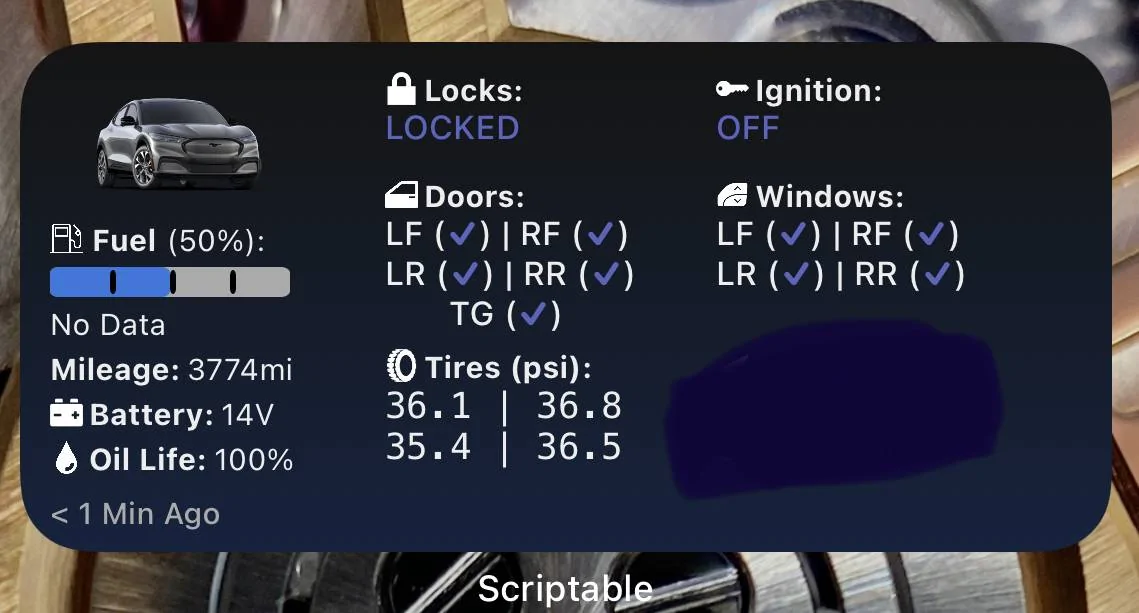

Ford Mustang Mach-E ? Scriptable FordPass Widget (iOS, iPad, MacOS) BF8C6384-BC31-4364-80E9-F8ACB5CB44EF
super cool! I hope we can get an accurate “fuel” gauge soon! I need to fill up my tires!
I just PM'd someone to get the data from their car... I should be able to get the fuel gauge working with EV in about an hour.
I suspect tomorrow at the latest.

I haven't looked into this widget but I once made a Python app that reads the FordPass data, the result is a JSON record that contains the following fields that you probably want to use to update the widget for the MME.
# 'chargingStatus' is one of
# 'NotReady', 'ChargingAC', 'ChargeTargetReached', 'ChargeStartCommanded', 'ChargeStopCommanded'
'chargingStatus': {'value': 'NotReady', 'status': 'CURRENT', 'timestamp': '12-13-2021 23:49:29'}
# 'plugStatus': 0 - Not plugged in, 1 - Plugged in
'plugStatus': {'value': 0, 'status': 'CURRENT', 'timestamp': '12-13-2021 23:49:29'}
# DTE (distance to empty/GOM) in km
'elVehDTE': {'value': 164.900009, 'status': 'CURRENT', 'timestamp': '12-13-2021 23:49:29'}
# Battery fill level (SOC)
'batteryFillLevel': {'value': 55.5, 'status': 'CURRENT', 'timestamp': '12-13-2021 23:49:29'}
The F150 widget fuel gauge likely uses the 'fuel' entry, this is not defined in the MME results so shouldn't be used. The MME 'oil' field returns results for 'oilLife' and 'oilLifeActual' but mine are still at GOOD/100% so don't know if they will ever be useful.

Thanks for the info.
Oil life is basically irrelevant with EV's right? I ask because I have limited space in the widget and if I need to put charging status and plug status I would like to eliminate oil if it's not useful
