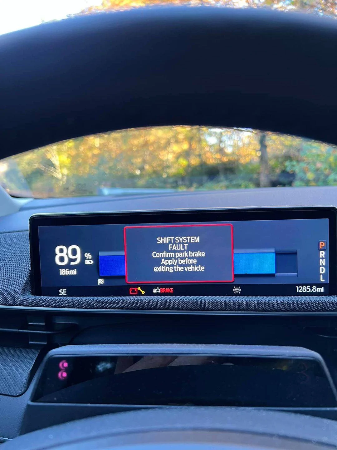

Yesterday I was driving, heard a loud clunk, and then I got this message. The car made it as far as a parking area alongside the road but I could not get it to move after that. Would not shift (shifter was flashing), couldn't get it into Neutral, couldn't release the parking brake and therefore could not roll it out of the way. Initiated Ford Roadside Assistance via the FordPass app and an hour and a half later the tow truck operator called and said he did not have the right equipment (wheel lift and dolly), he called his dispatcher and no luck. Several phone calls to Ford and got hung up on at various stages in the process. Another 20 minutes and connected to someone, she made it through the whole process, scheduled another tow company. They cancelled. I was close to home, my wife walked backed and got her car and it was starting to get dark so we both went home.
Rinse and repeat 3 more times with Ford. She called to tell me she was still working on it, then nothing. My wife has AAA so I initiated that. Another hour, Ford calls back and a different person says they found a tow truck but I would have to pay them upfront! Sorry, no, AAA only wanted an additional $3 and change for an extra 3/4 mile.
AAA says up to 3 hours. After an hour and a half, I went back to check on my car with a trouble light and some wrenches. Tried to start the car, started right up, no problem indicated. I made it back home to my driveway, got my wife and we were going back to get her car. Dead again, same fault, can't shift or release the brake. At least in my driveway for now. Cancelled AAA and will try again today in daylight but will get it towed to the dealer in any case, I don't need to be stranded.
(Side note: the first time using the automatic parking was on Friday. I wonder if it's related?)
Is this the same error as the original thread? Any hope my car will ever work again?

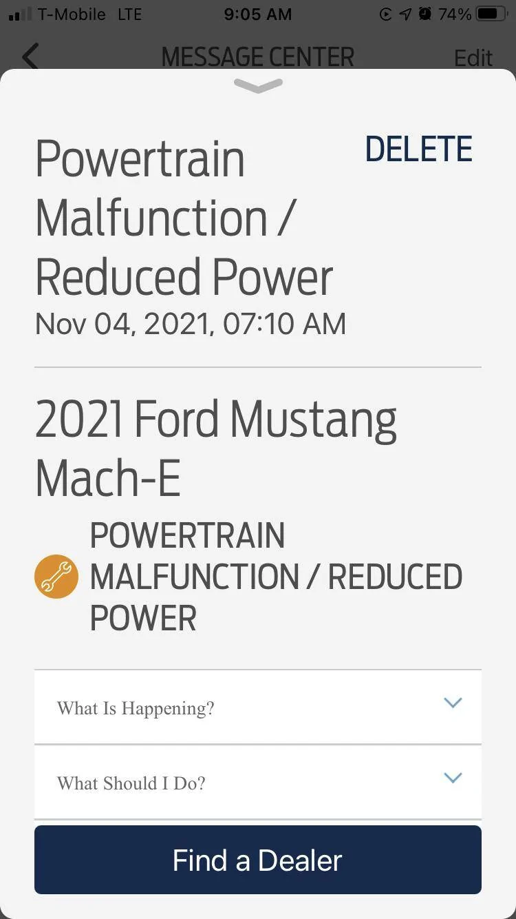

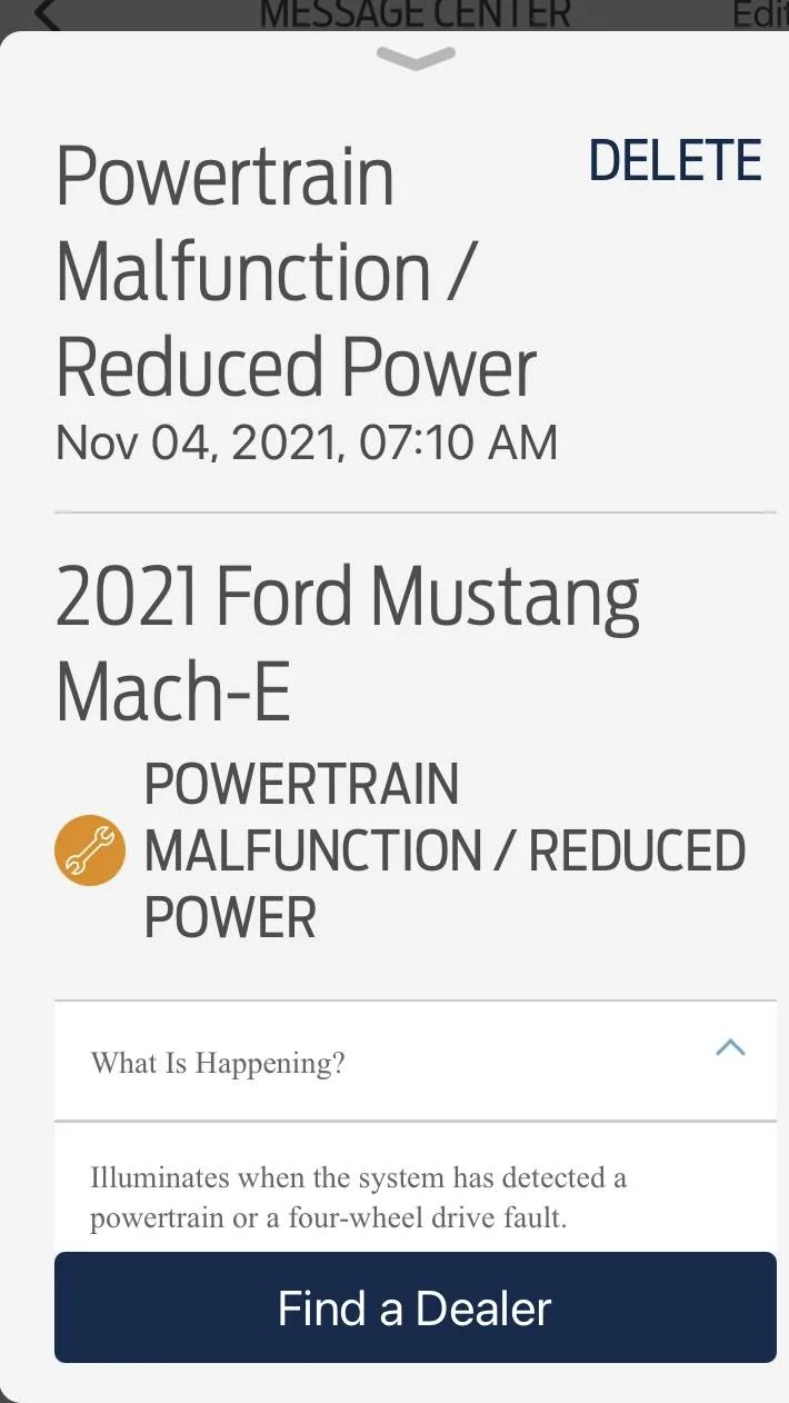

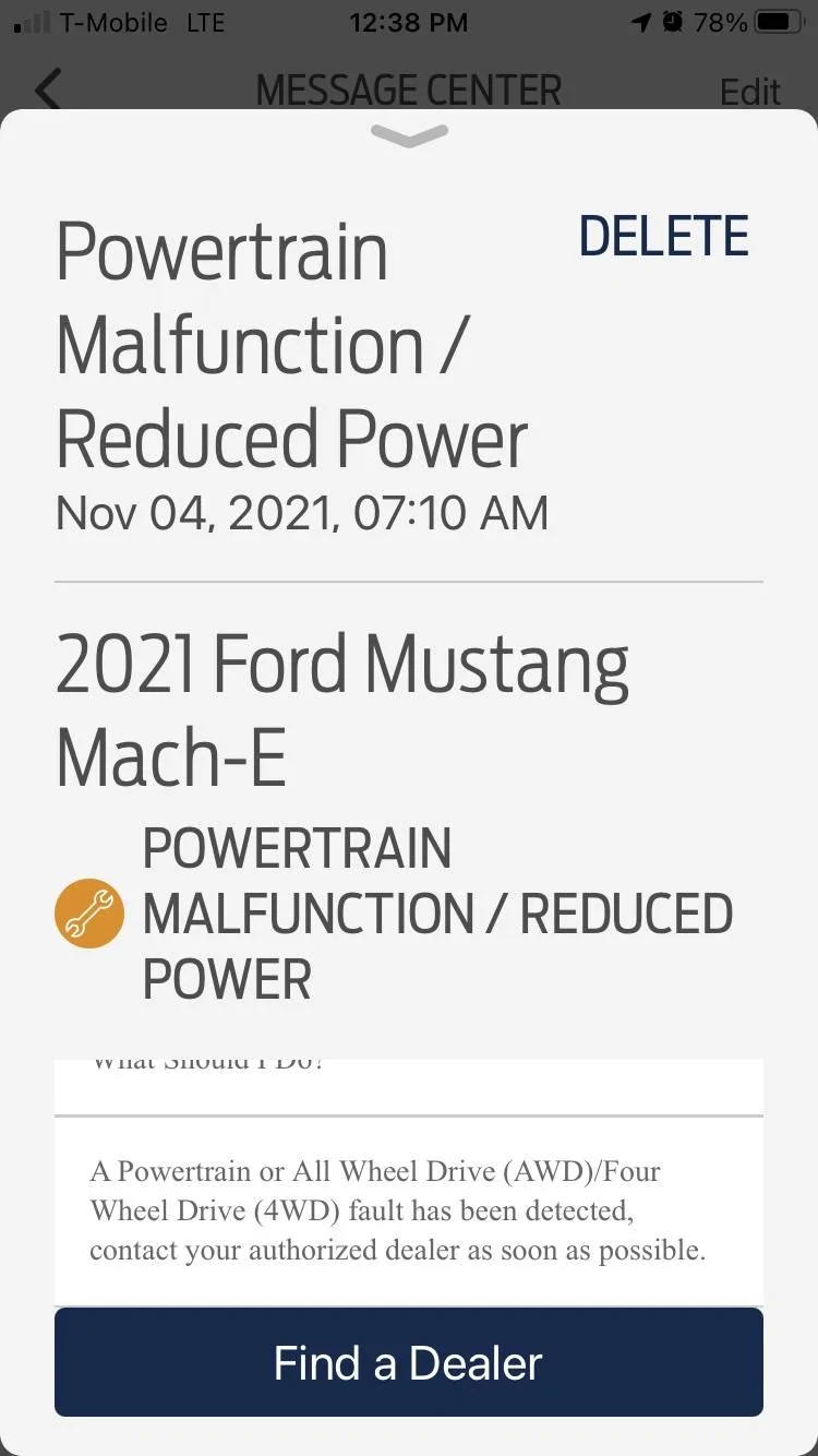

Turned on Mach this morning and have the same issue. I drove the car for 10 miles and had no issues. When I called the local dealer, (I am 600 miles from home), he seemed to have no idea and suggested I have it towed in. Flatbed just picked it up, I will update this thread on my experience.
That sucks! Sorry you had to experience that. Would you update us here when they find out what it was please?
Not to downplay or make light of your terrible event, but does anyone else find it hilarious that the screenshot says "What is Happening?". I'm really curious to see what it says!
That's what happened to me. I was unable to drive - might be because I have one-pedal drive enabled? Make sure the dealer installs TSB 21-2244 which includes a bunch of module updates. Also seems to fix PaaK issues.
