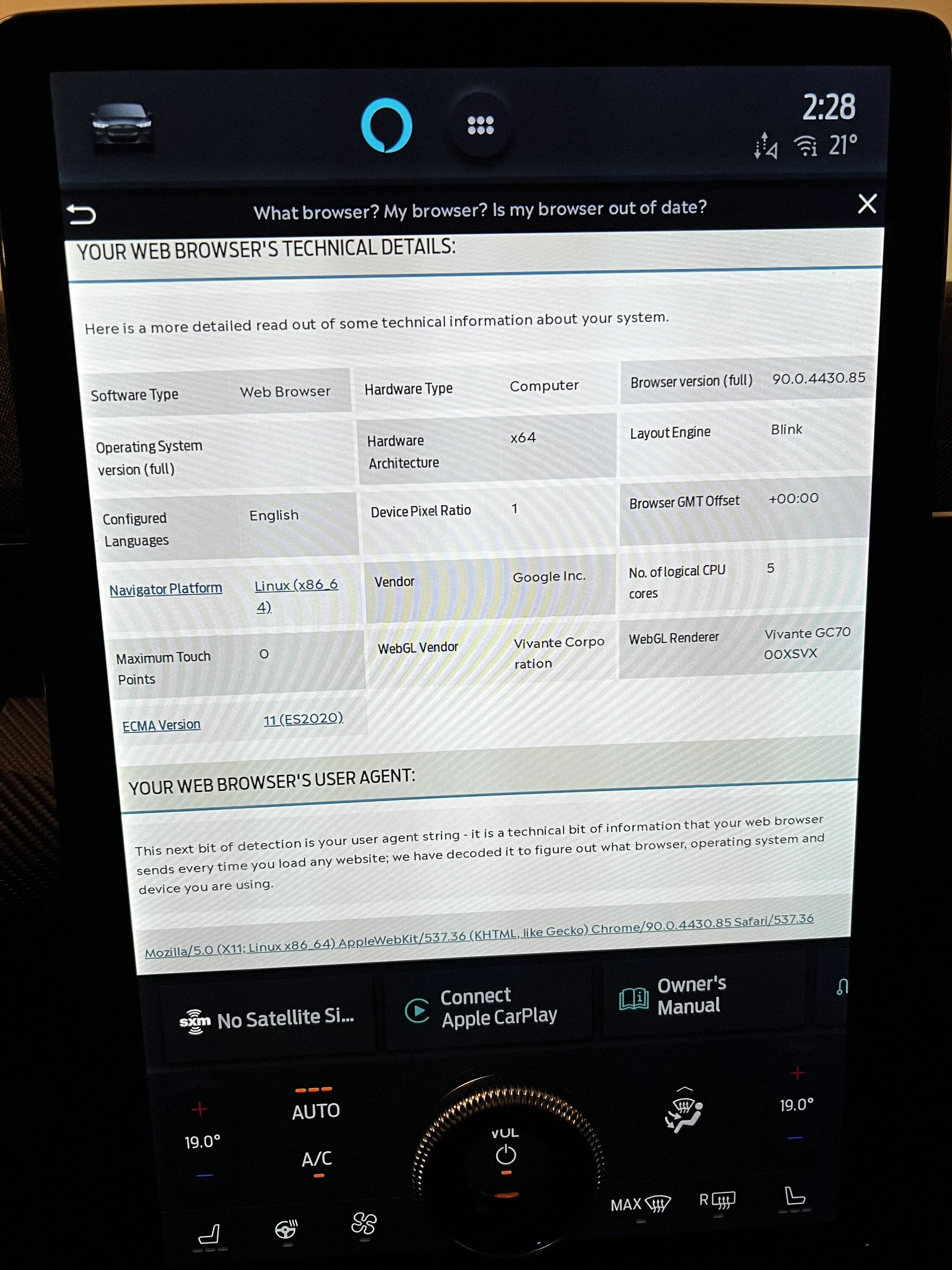

Just curious - why do you keep insisting that we're using x86 for existing Sync 4A?
When we had that workaround to load any page using the built in browser I was able to get details about the platform Sync4A is running on. As you can see, it’s a x86_64 system. Probably an Atom based one.
I believe there should be a hypervisor in it so you're not actually looking at anything besides the emulation. The chip should be qualcomm which is ARM.
Browsers lie in their UAs all the time. It even says it's running "Linux" when QNX most definitely isn't. Sync 4 runs on ARM, and I doubt Ford would run two totally different CPU architectures for their infotainment.
https://www.nxp.com/company/about-n...-NXP-AND-FORD-COLLABORATE-TO-DELIVER-NEXT-GEN

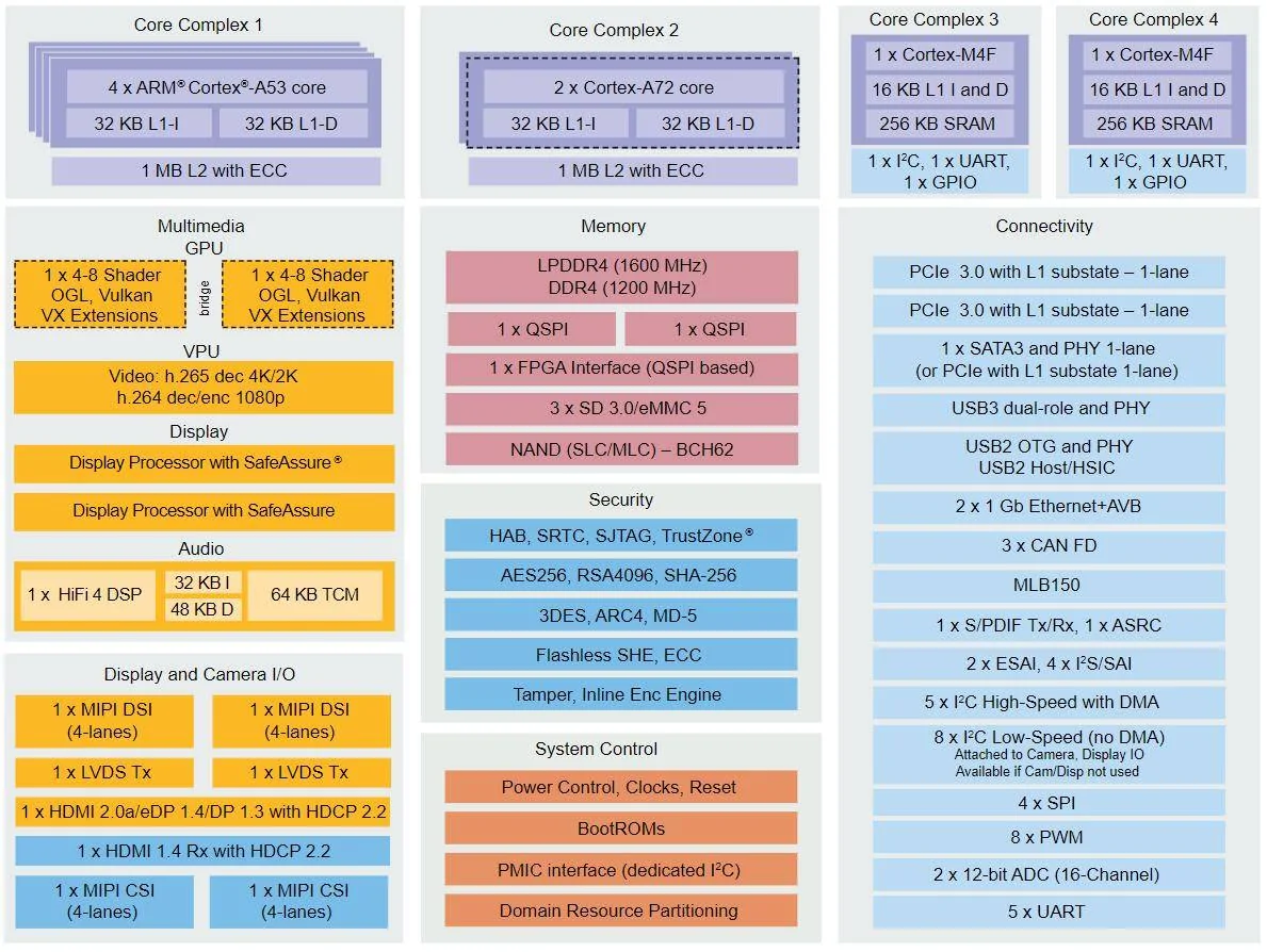

Here's the SOC block diagram at the heart of sync 4. Keep in mind that not all features are utilized
