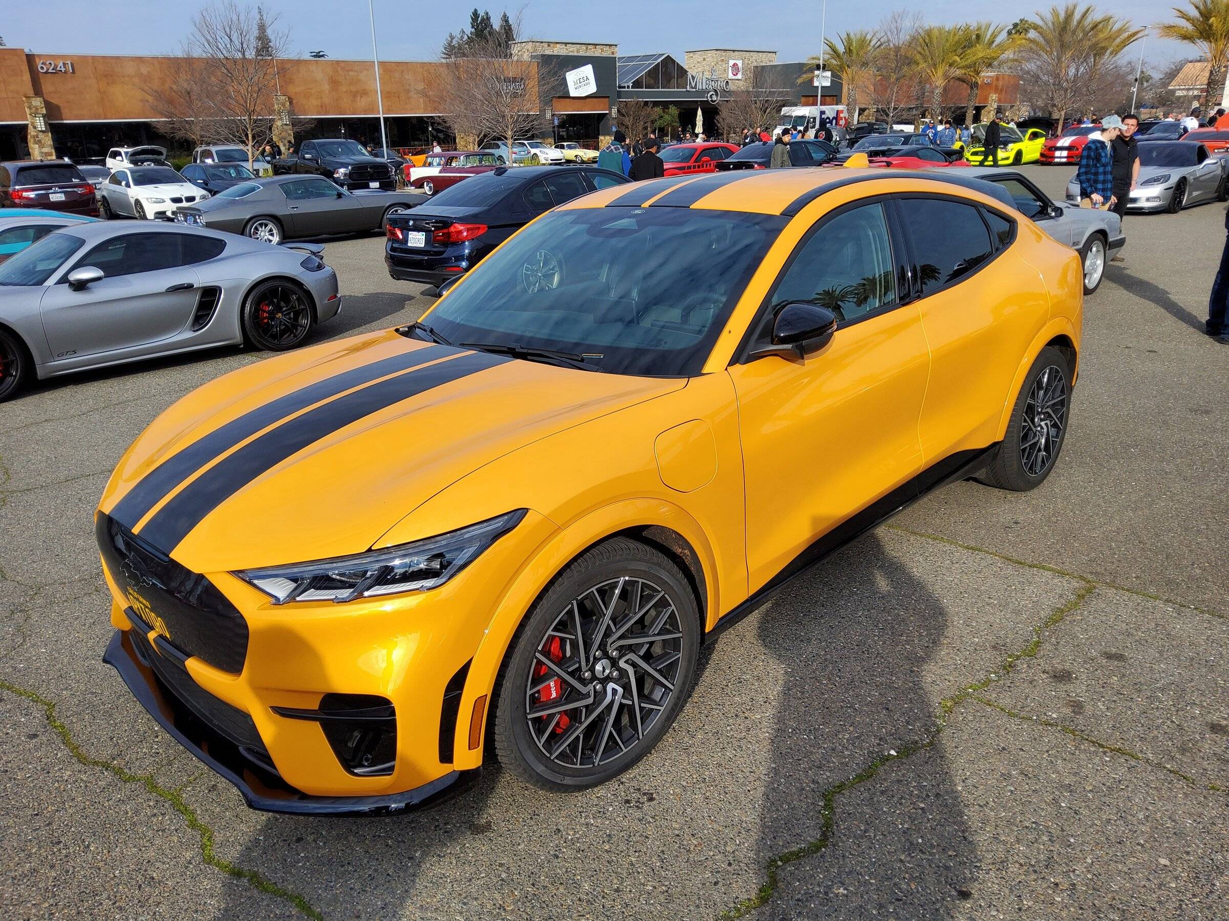

I'm not the OP, but what questions would you like to have answered? When I drove BACK from Pasadena to Camino (up the hill from Placerville 5 miles), I drove through a light ice/snow storm (at the legal limit of 25 mph), my GTPE reported a range of 256 miles, driving 74-77 mph. Running 245/45R20 Michelin CrossClimate2 snow tires, running 41 psi hot (39 psi cold). Very occasional 90 mph bursts to pass people. No heater/fans on, but seat heater/steering wheel heater on when needed.
The 256 is real good considering how you drove. Snows, speed, eHeat and temp kill range.
