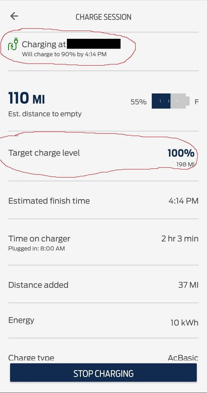

Hello:
I am having a heck of time getting my maximum charge level of 90% to actually stick on my new Mach-E. I've been through the various threads, saved the preferred charge location, set both the FordPass app and the car's main screen to "use preferred charge settings," set the charge limit to 90% (on both the app and the main screen), but it still blows past 90% and goes all the way to 100% each time. It appears the app recognizes I'm at a saved location (evident by the top of the screenshot that shows my setting of 90%), but the "target charge level" still shows 100%. What am I missing here?

Thanks for the response and the thought. I've set the schedule in the car for 12pm-12pm and the car's main screen reads "anytime" and shows a maximum charge level of 90%.

Well, I updated the charging window to 23 hours and still no luck. The car and the app recognize my location and it says at the top of the charging session when it will reach 90% (which is what it is set to), but the target charge level is still showing 100%.
is it just a visual bug? i think i've encountered this before and i restarted the app and it fixed itself. But it sounds like that isn't the case for you. the main question is: does it stop at 90% or continue to 100%?
I've never used sync4 for setting up charging. Does your sync 4 reflect the 90% you wish to have? I"m assuming the slider in fordpass app is set to 90%? This is really quite puzzling.
Have you tried setting your charging window to a shorter period, say 7pm to 6am or similar? on fordpass?
