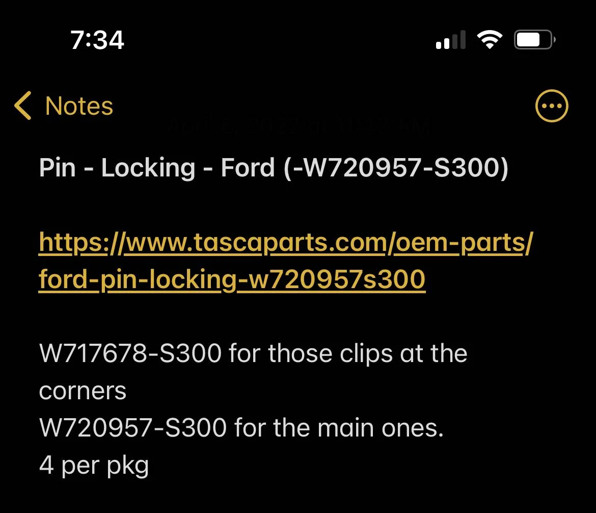

In prep, I installed the battery access holes this weekend... I was not surprised that the dealer had lost some. I was surprised that they lost 5 of them.
do you know where these can be had online?
People have posted links to Ford part numbers, but I don't know off hand.

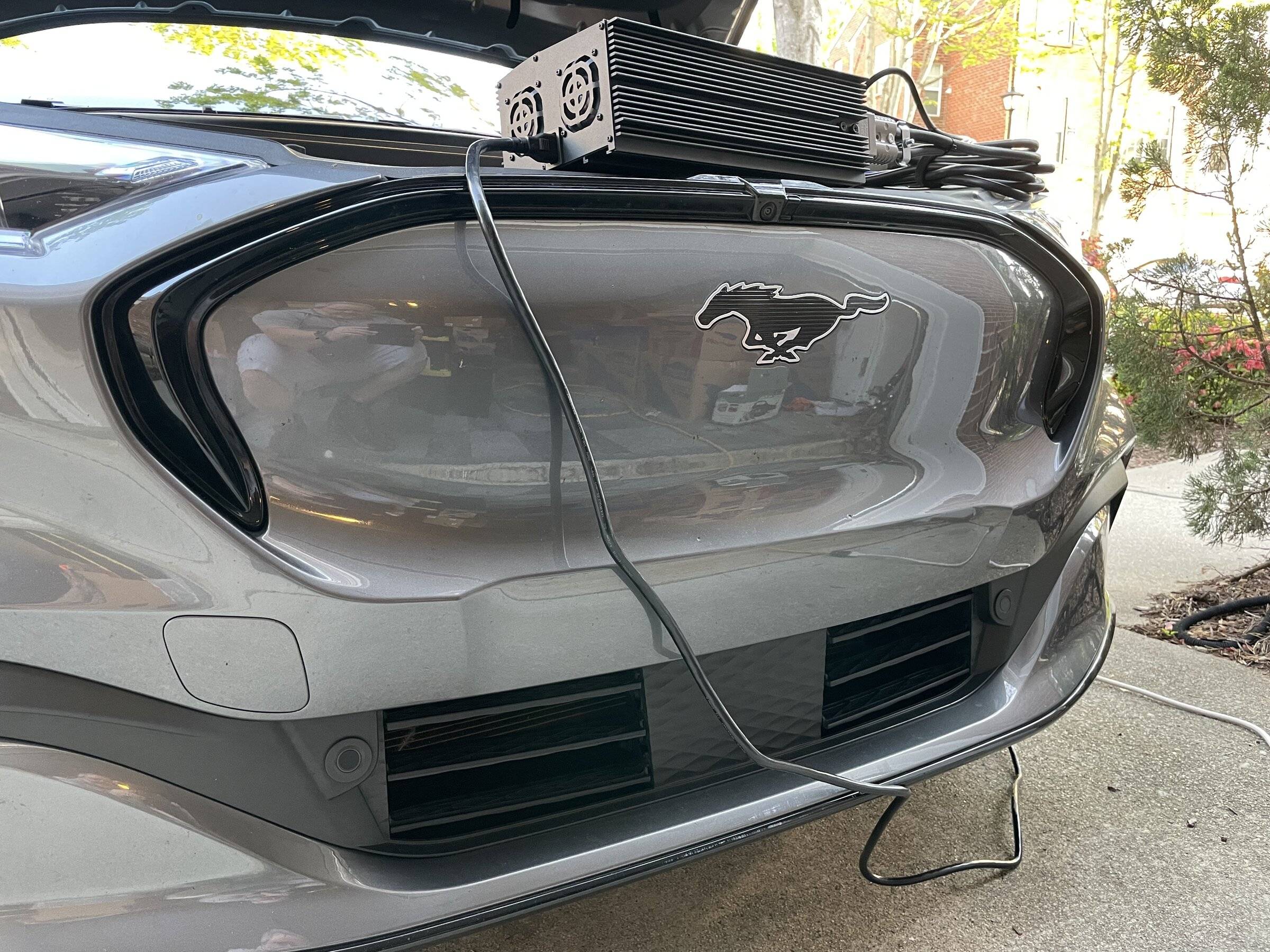

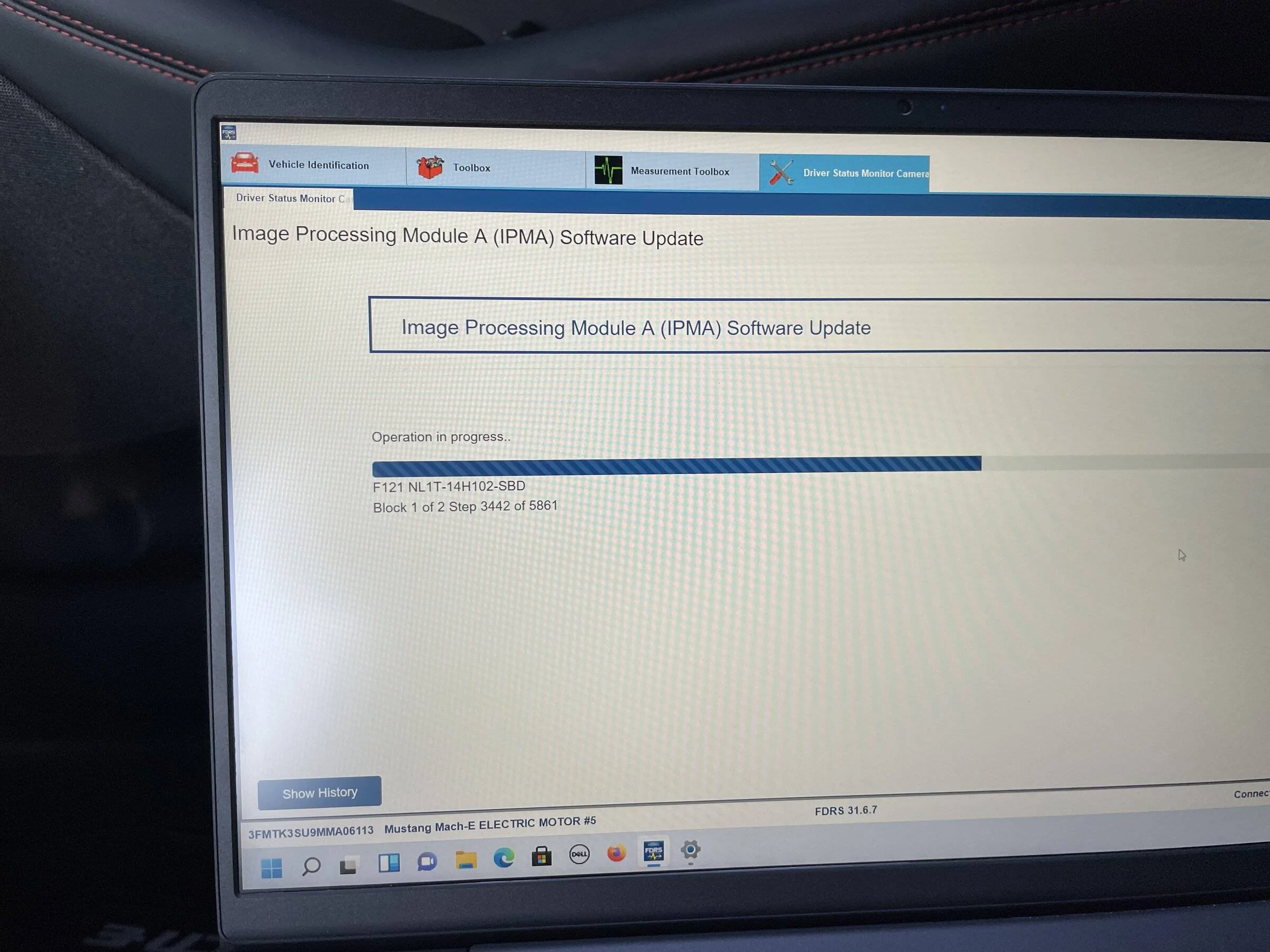

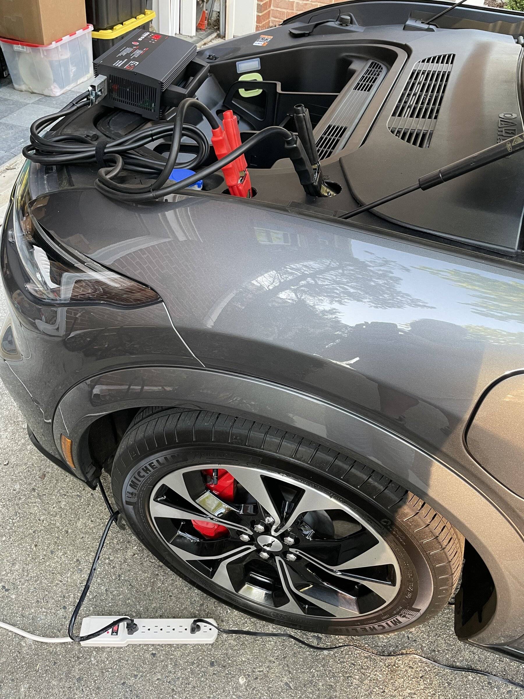

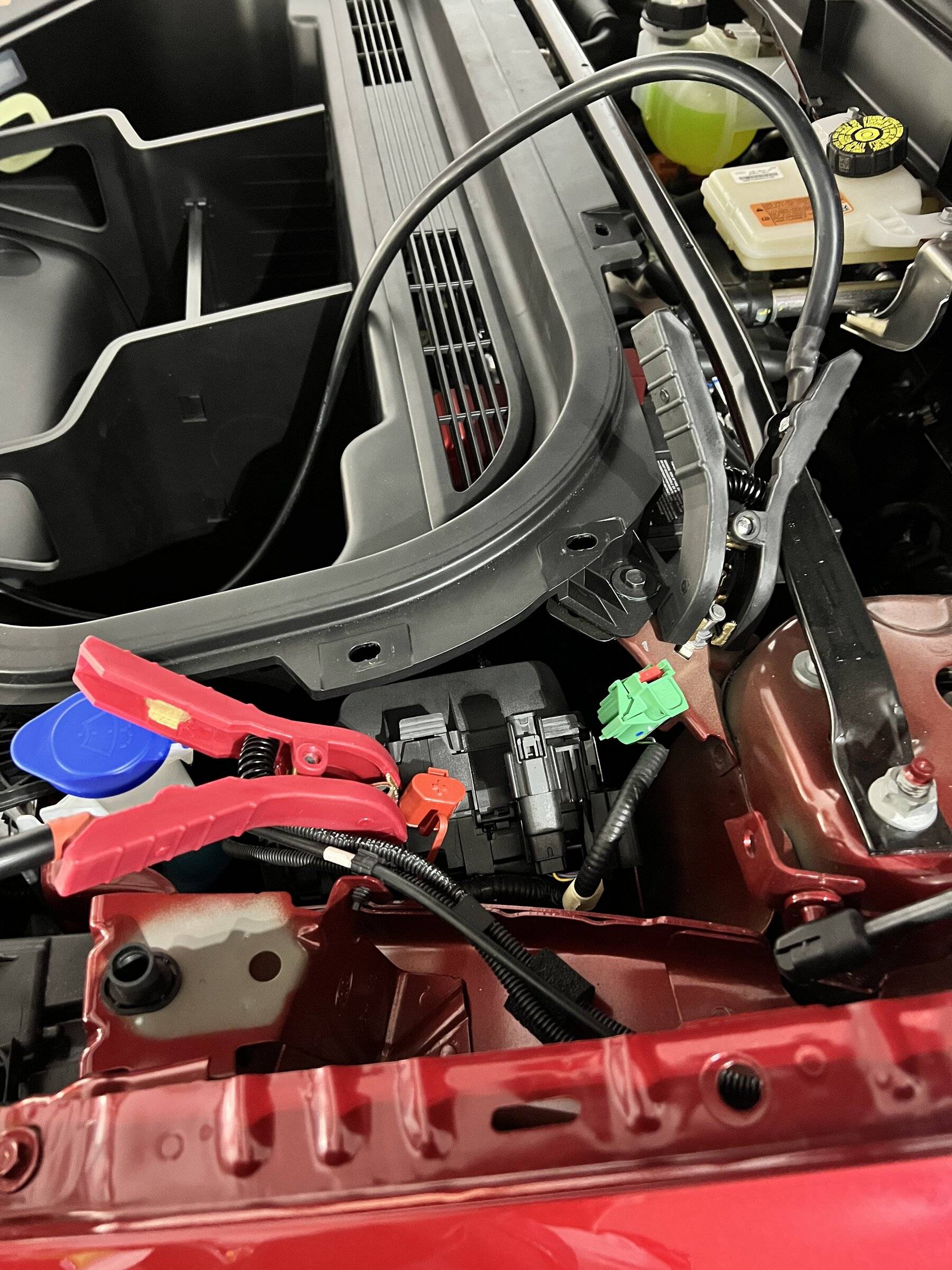

Three hours in and some observations….
The various (erroneous) alerts during the process from the car’s displays aren’t for the faint of heart.
High amperage external power is a must - the car’s coolant system is currently running.
Process is quite straight forward on the laptop. Pleased with the original post’s documentation and the YouTube video - Thank you! The car has been restarting itself followed by a flurry of alerts before the app prompts to shutoff the ignition.
This is on a first batch FE built 1/21 for which OTA only got it to 2.4.4 as of yesterday.

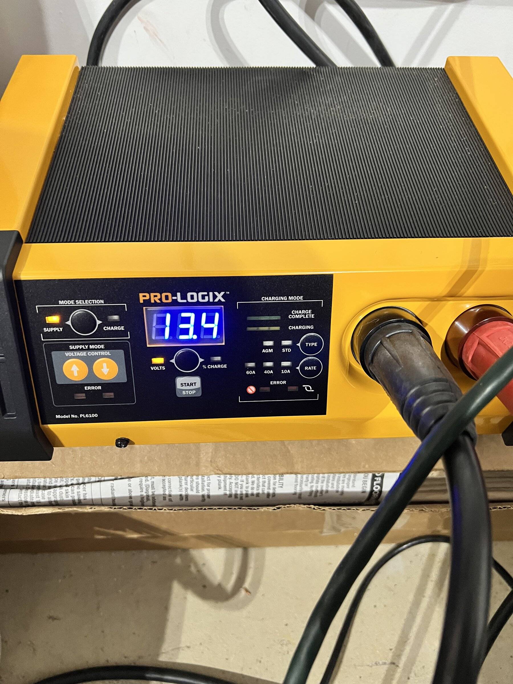

FYI: the IPMA is VERY picky about power during an update. Make sure you have a good power supply to your 12V
My coolant pump(s) has been running throughout the two hours and counting on that update. Very glad I went with the 100A 12v flashing supply.
Same here when I did the updates.

I have that same unit. It is rock solid keeps the 12v battery right at 13.4 volts regardless of what is running. Definitely worth the expense.
I have question for you, does the LCD go dark when power / operation is maintaining the car after a while?
or does you LCD stay infinity on
Takes about 10 minutes I think.
thanks

I buy these clips two bags of four at a time, preferably with other stuff I need to justify the shipping cost. Last order was:
W720957S300​
$ 8.75​
Pin. Panel. Cowl. Clip. Cover. (Rear)
I just google around to find the best price at the time. My last order was from Roesch Ford.
I had put some small strips of gaffers tape around the ends which helped, but some strips came off in the winter, and last dealer visit they broke one tape strip with the fastener gone.
There was a solution with wire like paper clips. But, I keep hoping for some kind of black plastic pin solution to hold them in, or maybe some kind of end black clip to retain them in the slot.
thanks
It goes dark but if you hit one of the voltage up or down buttons it comes back on. But the unit is working as expected.
Perfect and thanks!
