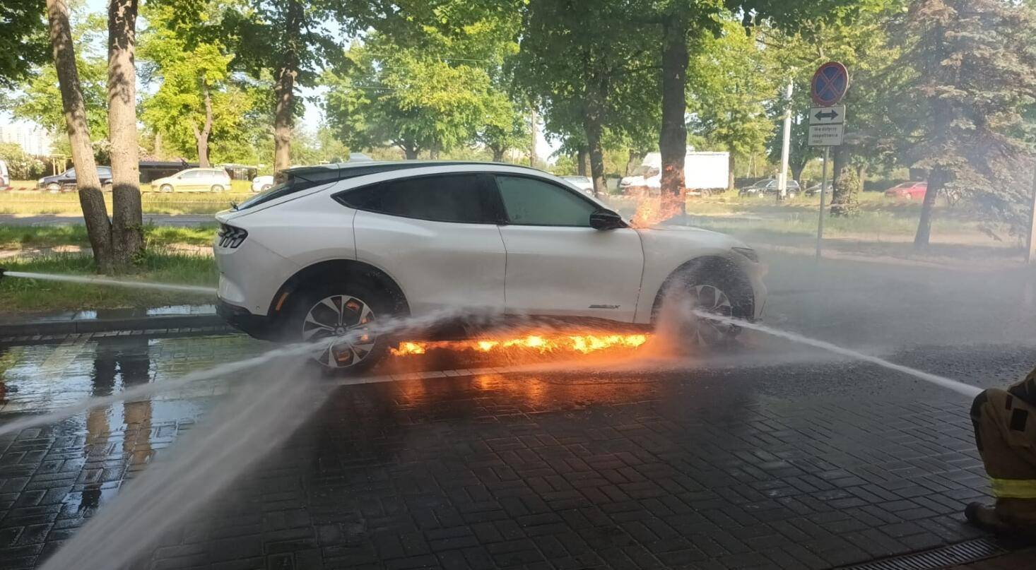

THAT WAS NOT A MAIN BATTERY FIRE. That's the case in Gdansk, and was widely understood not to have been main battery, but something under the car that caught fire. It was put out by fire personnel with usual stuff, so very clear the main battery didn't go up. The fact that the main battery *didn't* catch fire when parts around it did, also speaks well.
It was a battery fire and took 2 hours to put it out. Tons of pictures, news story etc on this thread:
https://www.macheforum.com/site/threads/mach-e-caught-fire-in-gdańsk-poland.28340/
Do you have some other evidence that proves otherwise?
Regular fires go out when you put water on them…… battery fires on the other hand:
Ford Mustang Mach-E Tips or thoughts on fire mitigation strategies IMG_2565
That thread. 2 hours *of water* for cooling isn't much at all, and wouldn't have normally been used if it was a main battery fire.
Look on the second page of the thread, where the fire is out. The battery is intact. I found believable the people commenting on that thread said if it was a true thermal runaway main battery event, the car wouldn't have remained, nor would water have extinguished it, nor would the battery pack have been intact afterward.
It even looks possible to me that the water put out the fire, or it was a plastic / electrical fire in some component, and they kept water on the battery for two hours out of caution. The picture when the fire is out doesn't look like 2 hours of fire damage.
On the other hand, word from the Gdansk people was that is *was* a main battery fire. But if so.... it sure didn't behave like main battery fires on other cars. Doing some quick research, the inital active burning stage is usually considered a 2-8 hour events (notice the Gdansk car was an ER, so likely not on the short end), with then days of reignition risk, for 24 to 72 hours. The Gdansk people said it "wasn't necessary" to submerge or isolate the car... a bit of evidence that on reflection if it was a main battery fire, it wasn't a thermal runaway like we've seen on other cars.
I'd say that thread gives no evidence it was the main battery other than the guys in gdansk saying it was, and significant evidenct it wasn't, because we have a picture the car was intact, and the battery was intact.
If you'd like to claim it was a main battery fire because there's a picture of fire near the main battery, OK. "battery involved" was used in that thread, but that's not what people think of when they think EV main battery fire - a thermal runaway that consumes the car and can't be put out with normal means.
here are some pictures of what people think of with an EV main battery fire, rightfully so:
https://www.ndtv.com/world-news/tes...ighway-photos-show-unrecognisable-car-3539969
https://insideevs.com/news/687302/tesla-model-3-destroyed-fire/
https://www.washingtonpost.com/nation/2022/06/22/tesla-fire-sacramento/
https://arstechnica.com/cars/2016/08/tesla-model-s-france-battery-fire/
The two cases we know about, Gdansk and america, the car was intact . The US one was road damage and fire while driving, person pulled over, got out of the car safely, the car never fully caught fire. We don't seem to know as much about the Gdansk one, but it wasn't sitting in a garage. Looks like it was out on the road, and it would be reasonable to presume road damage.
So, just to be clear, your position is that it took 2 hours to put out a fire that WASN’T a battery fire?
Those 3 fire hoses in the photo pouring water on the “not battery fire” must be deceptively small then. ?
When you put 3 fire hoses (or even just one) on a normal car fire, it goes out in seconds not hours. ?‍♂

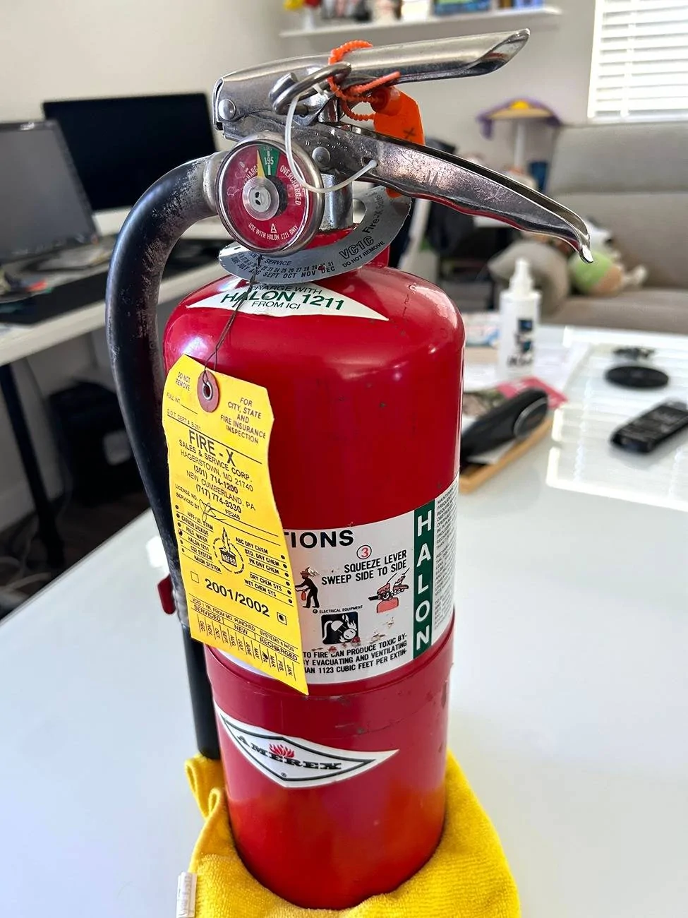

Seal the garage and put in a HALON system like they have in ship’s engine rooms?
100% what I have.
Halon extinguishers - automatic heat sensor built in my computer/server room in the event of a fire without leaving a residue and safe for electronics.
2x 10lb Halon manual extinguishers on hand in other parts of the house.
Here's one next to my Macs that I noticed needs re-cert and re-pressurization - not cheap to maintain Halon...
Ford Mustang Mach-E Tips or thoughts on fire mitigation strategies IMG_2636 2
