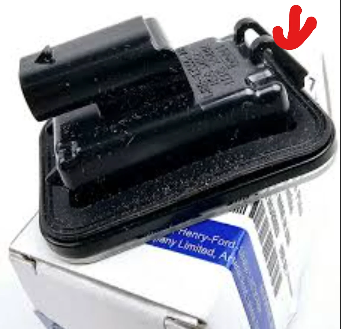

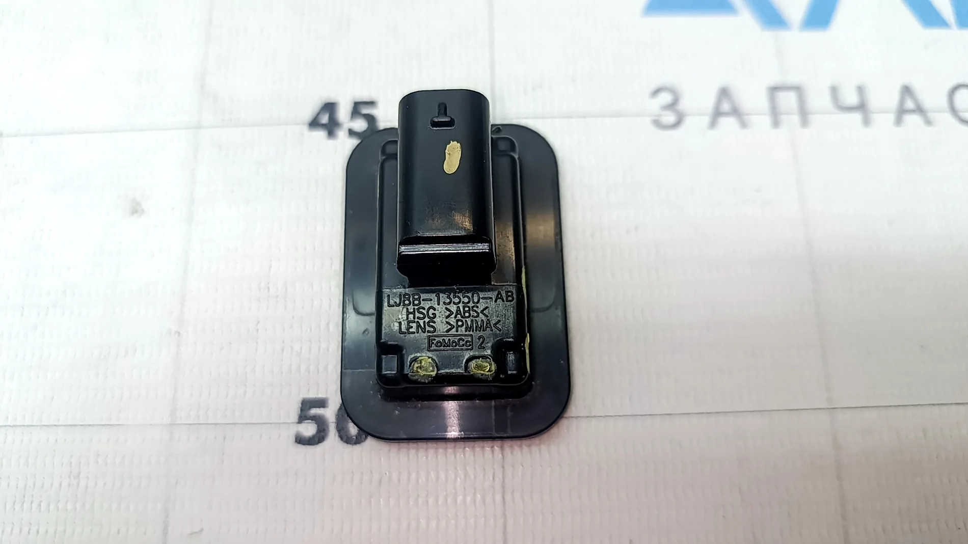

Well Mark, I had to give it a shot, I popped out the LP light, Don't do it from the outside! You must open up the liftgate trim and release from the inside. o_O
I tried with a little plastic spudge and it did give quite easily, but whatever little tab was there broke off...
Ford Mustang Mach-E Trunk button(s) 1787690426684-oq
If you see one that looks like this, don't buy it, the tab is broken!
Ford Mustang Mach-E Trunk button(s) 1787690670234-yj
