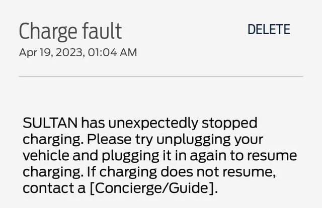

As an additional data point, I had this happen last night using the Ford Mobile charger plugged into a 120v outlet charging at a whopping 1K. Woke up to a charge fault, P0562, U3003, P0AA1, P0563, P1A10, U0253, B115E, B15E1, B15E2, U0100, and U0442. Got the dreaded Stop Safely Now message, and lucky me, everything cleared up using the reset method. Scary times there.

Just got this error/warning (SVS & HV Battery Warning) charging at home (Chargepoint Homeflex). Let the car sit for 30 minutes and the error cleared.

I just got this today using a chargepoint charger at work, cant try again until I get through the waitlist, but I am hoping it goes away later today.
I should add I am on 4.2.4. I had charged a number of times since this update was pushed and this was the first time with the issue. It charged about 1hr before kicking it back.

Just an update, after letting it sit it charged fine, hopefully ford fixes this with another update it was quite annoying

I received this message about an hour after charging while winding down from my late shift. I went out to garage and saw the LED circle still blue and blinking and the charge cable was normal warm to the touch. I have ClipperCreek HCS-D50 and I received the Ford 4.2.4 about 2 weeks ago with this being the first notification. After reading the threads, I performed the wait period (reset) to see if any service faults or anything displayed on screen but nothing was displayed. I plugged in charger and it started as normal again. Crossing my fingers for the future??
Ford Mustang Mach-E Try This First - Powertrain Malfunction / High-Voltage Battery Warning / Service Vehicle Soon While Charging IMG_3787
How is it going? Any repeats of the situation? The exact same thing happened to me last night, but with my Ford Connect charger. Now it's charging fine. Hoping it was an aberration.

Had this happen a 3rd time this year w/ home level 2 charging. The reset method in OP works.
