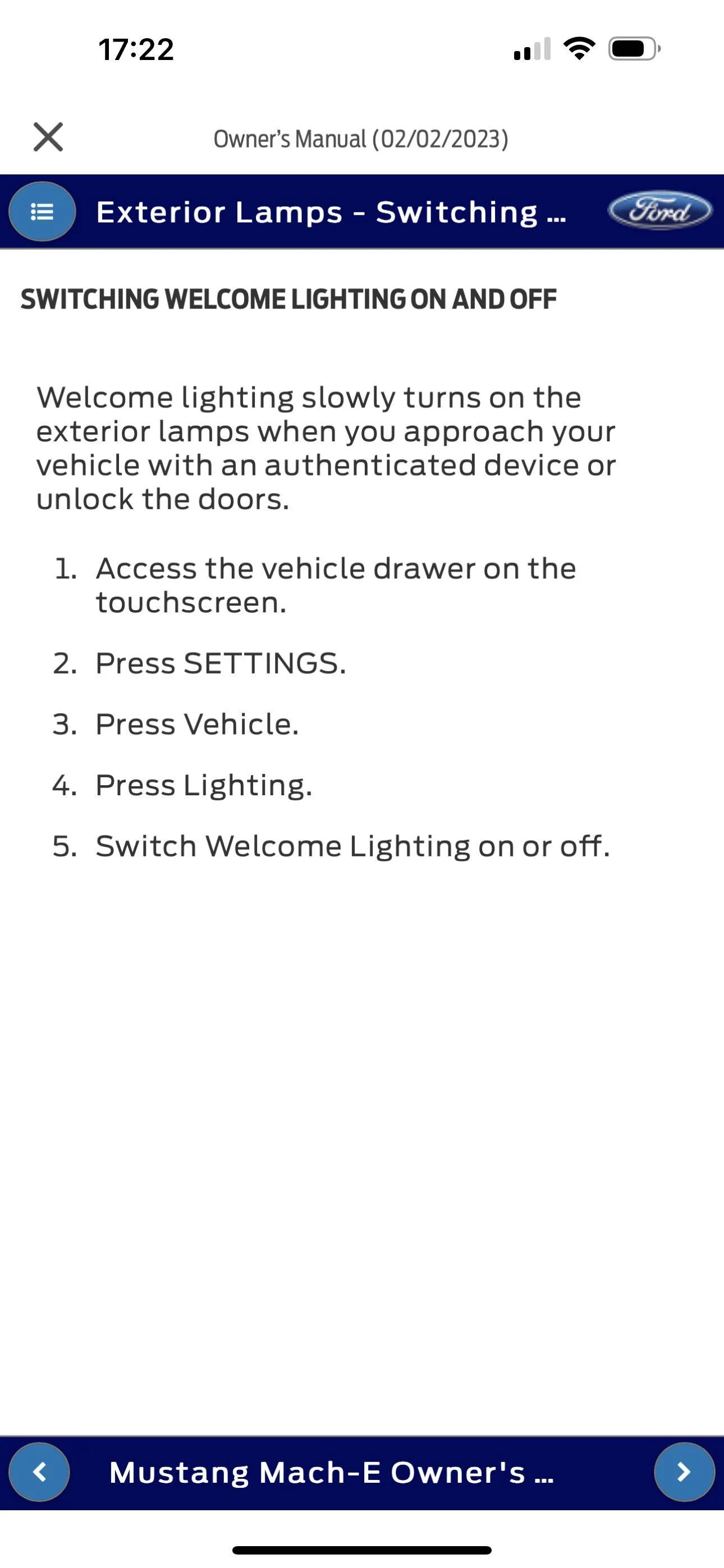

My car was built Dec 2020, delivered May 2021 and the puddle lights/welcome lights have NEVER worked properly. Mostly they don't come on when in my garage but will come on when key is in pocket and I just happen to walk past when car is outside work and I'm inside. My dealer had a Ford technician in one day and he said it is more than likely that if the key has been still for long time it takes a bit to "wake up" the movement sensor. Seem plausible. Still bloody annoying though.
Hi, I had a simular problem: at home the puddle lights were not working properly, but somewhere else they did work. I noticed that I kept my fob key to close nearby the parked car at home, the car doors were locking, lights went out, etc.. but no puddle lights. Now I put my fob somewhere else and it't working all the time, without any sw update. Try it.

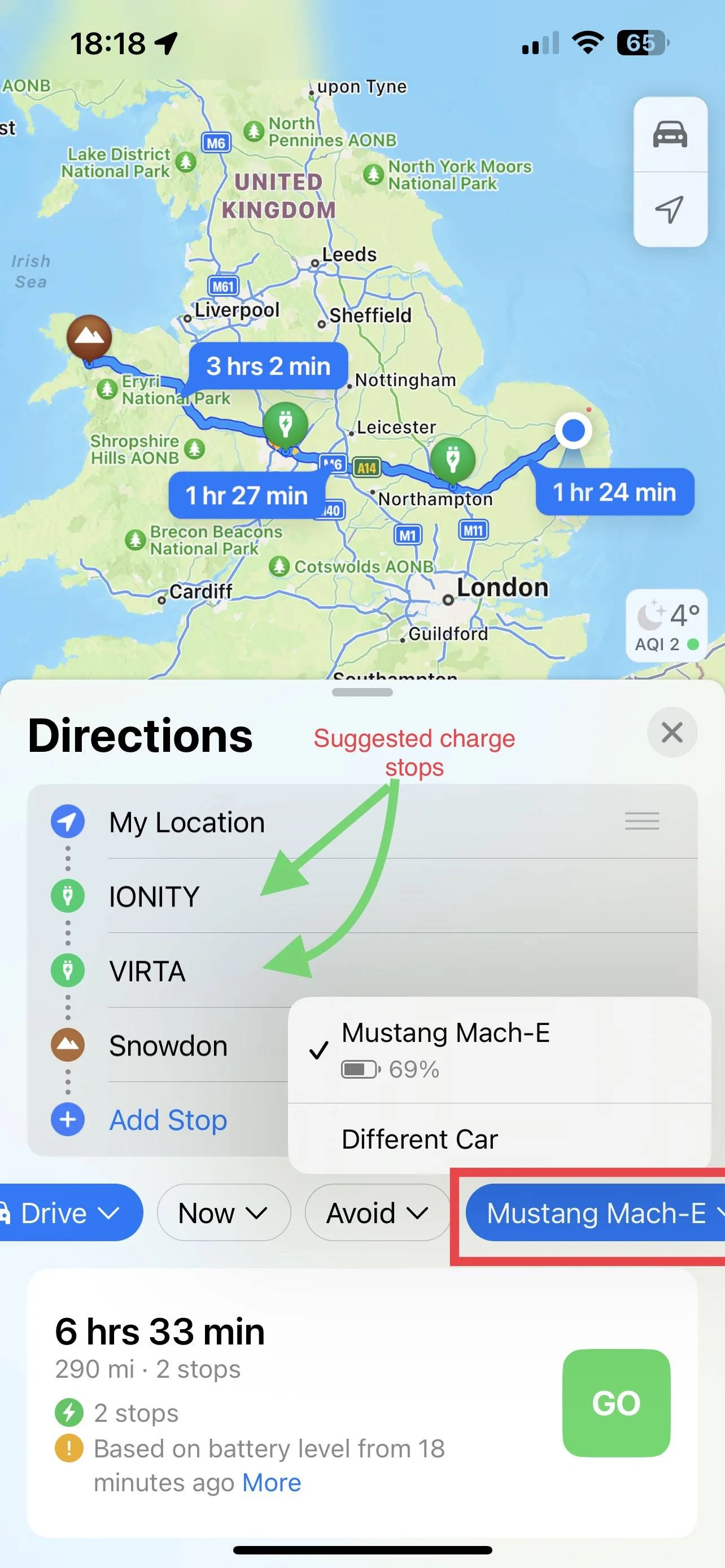

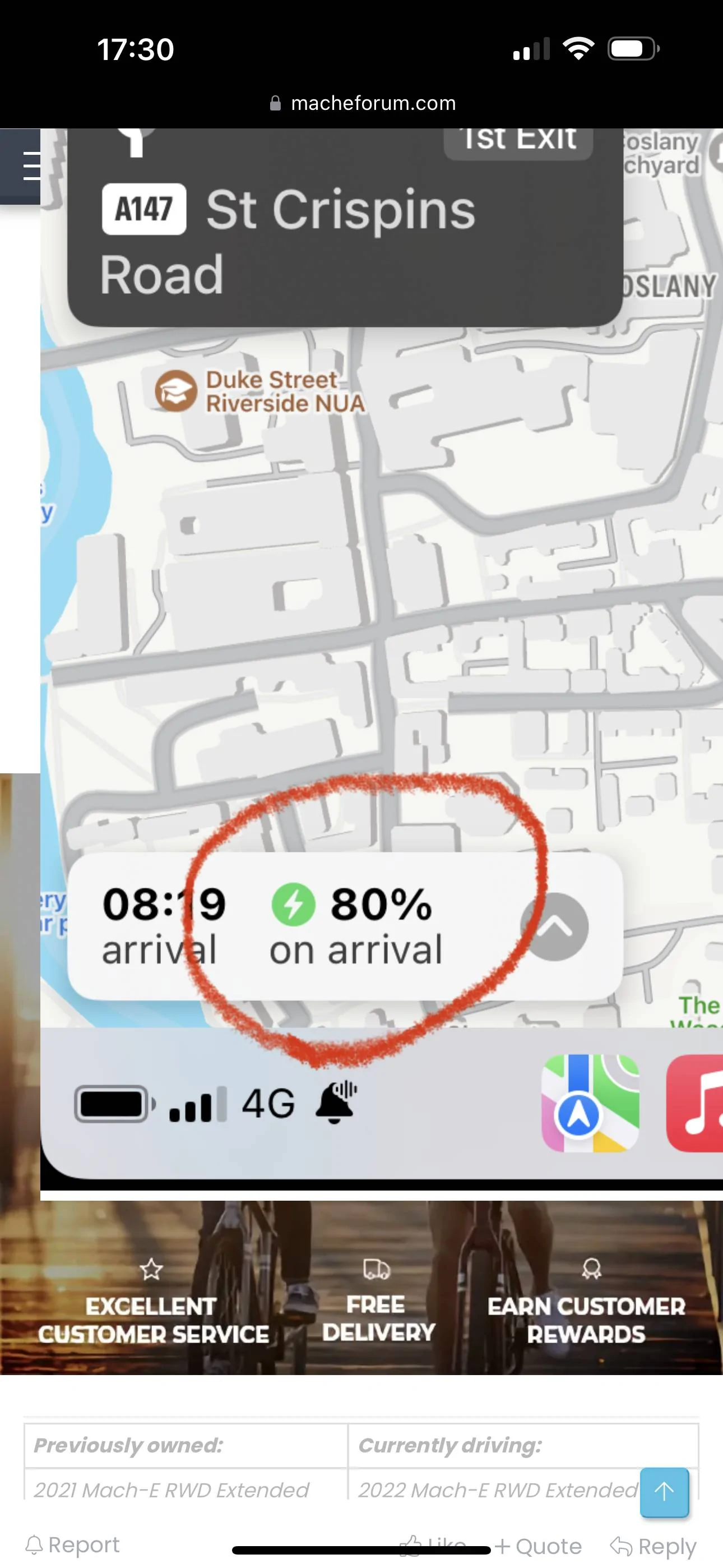

Hiya
Yes I do have FDRS - if you’d like me to look up what updates may be available for your car just drop me a DM with your VIN number and I’ll look them up.
It looks like your SYNC and iOS version should support CarPlay with EV routing - I’ll have to look into that a bit more for you.
I used it this morning … as you can see from the CarPlay screenshots from the Mach-E the battery integration all works.
Don’t think puddle lights are supposed to come on when you lock car, don’t think mine ever have done.
Aren’t they part of welcome lighting which turn on as you approach locked car and remain on until key is operated or door open button is pressed.
I reckon it’s the only thing on the ā€˜Stang which works same way every time, quite a boring feature really when everything else works when it wants, how it wants by some kind of randomising control??ā€ā™‚

Hiya

Hiya

Go on then, WD, spill the beans pls and tell me how you get this up on screen………
Hey
So - a long time ago in a galaxy far far away (well Norwich anyway) back in April Apple turned on EV routing for compatible vehicles. Check out my post back then (link) that shows it screen shot by shot what comes up on your phone when it detects a supported vehicle / iOS combo.
After that one time setup (where you plan a route using Apple Maps on your phone rather than through the CarPlay interface) it will read battery info etc and display it as part of your routing info. forever more.
Now whenever I plan a route using Apple Maps or CarPlay I see the following option to pick a vehicle from my list of setup cars. I did originally have both my old 21 Job1 and new 22 Mach-E on the list, but in the latest iOS update the finally made it so you could delete unwanted entries on the list.
You can select ā€œDifferent vehicleā€ if you are in a friends car and it won’t suggest charging points and will offer petrol stations on the in car map Search function

So if this option has not become available for you I can only assume that maybe the version of SYNC on your vehicle is not supported (ie an older version), but as I mentioned I had this running on my old Job 1 car with Power-Up 2.3 installed so it’s not something that only works on newer cars.
I am sorry, I did not express myself very well, English is not my native language. I mean, with the fob key stored in my house to close to the car, everything looks very normal, the car is locked, etc.... But I notice that the puddle lights do not work when I approach the car later on with the fob key. When I put the fob key further away in the house, it works ok when I approach later on.
Ah, that’s reassuring, your puddle lights have TST syndrome - Tesco shopping trolley syndrome - like every other system on a Mach-e has, does what it likes goes where it wants? I bet WD can tell us if there’s a software update to randomise how my puddle lights work!
