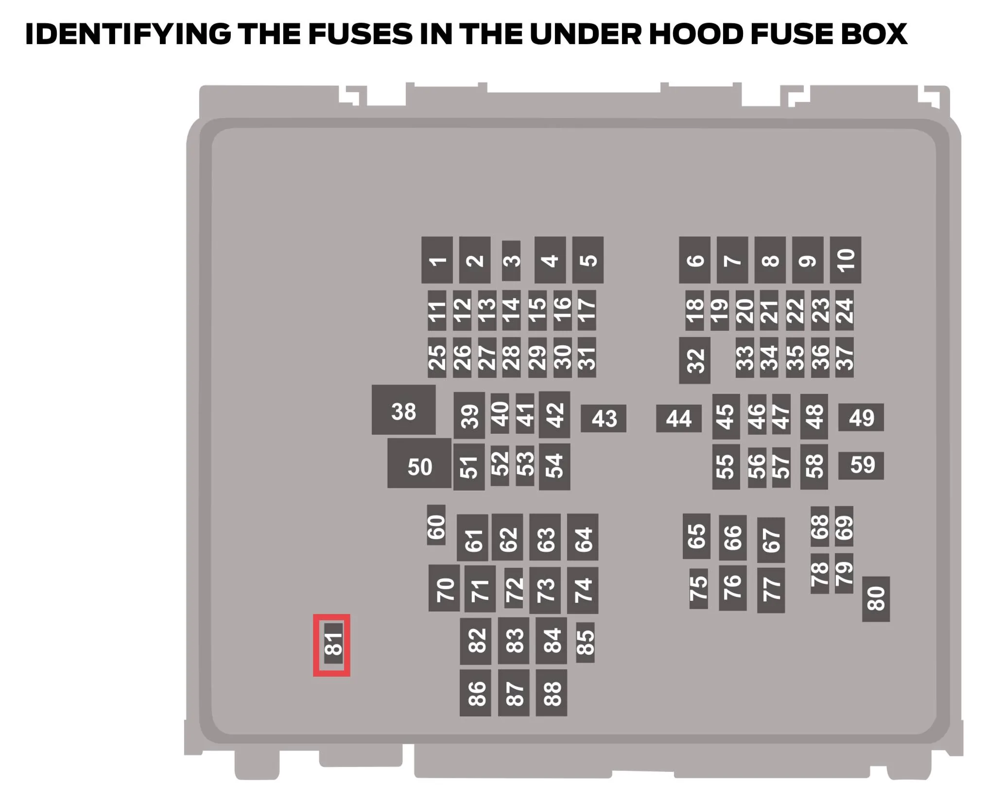

I now have the rear washer fault Wonky had! The exact same issue, it sprays into the boot vent!
Oh no - was it the result of recent dealership work or has it just popped off on its own?
SteveUk
Nov 10, 2020
2,112
1,575
Warrington
Mustang Mache with crap keys
It appears to have started out of the blue as it hasn't been into the dealers for months!

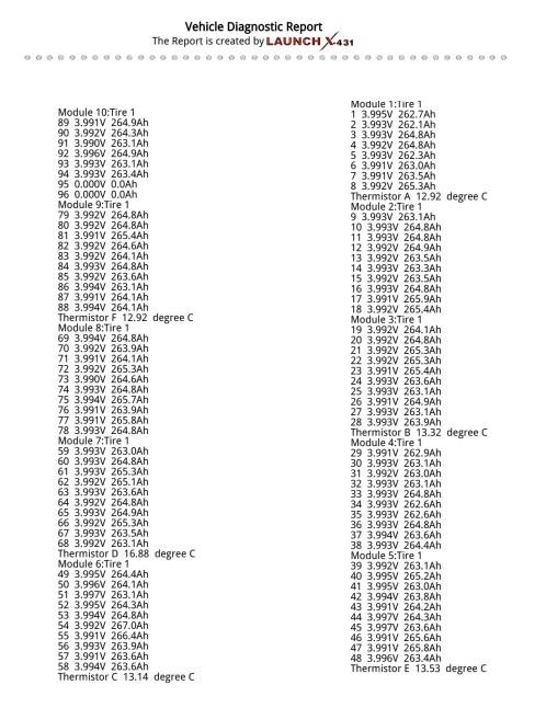

Go on then, WD, spill the beans pls and tell me how you get this up on screen………
Just had a sneaky peek at battery health, the health of each cell is pretty consistent with the rest so no apparent dramas in there……….
When you had this, was it easy to spot? My rear wiper is working but no water and no pump sound, wondering if it's this but I can't see of smell any wiper fluid?
Yes it was easy to spot as I had a bubbly soapy froth coming from the boot side vent on the passenger side. I could hear the pump running but no water appeared on the rear screen.
From what you said in your post you say you can’t hear the pump running? That could indicate a fuse has blown rather than a hose disconnection.
I have the same problem. Does anyone know what fuse it could be and where it is located (frunk or under passenger seat)? Thanks.
Edit: rear fog light and reverse light does not work either. Could be the same fuse.
Bad news is Rear Window Washer Pump fuse is located in the under hood fuse box (requires frunk removal to access it)
If you’re feeling adventurous it’s fuse location 81 - 10A fuse
Looks like mines going in to the Dealer then..... hopefully it'll take weeks and I'll get to drive an ICE loaner!!!
