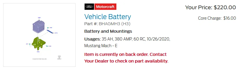

Official response from FordEv
”I hope you are well, thank you for your previous email. Sorry that I didn't follow up this case was closed as we were unable to reach you. I'm sadly unable to provide any part number these are only used internally and can only recommend that anyone experiencing issues should contact us for assistance should they need it.
We do not currently have an ETA t this time and continue to chase.”
I wouldn’t mind but i told them I was on holiday for two weeks,
Here in NA there is just one battery for both the MME and the Lightning:
Ford Mustang Mach-E UK Customers Battery-Mach-E

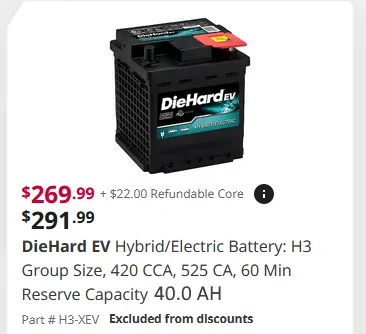

But there is an aftermarket battery that's sold by a large auto parts chain here called Advance Auto that I will probably buy instead when mine go bad. It's the same size but is a 40AH battery instead of a 35AH. That little bit of extra staying power helps.
Ford Mustang Mach-E UK Customers MME_Lightning_Diehard_EV_Battery_H3

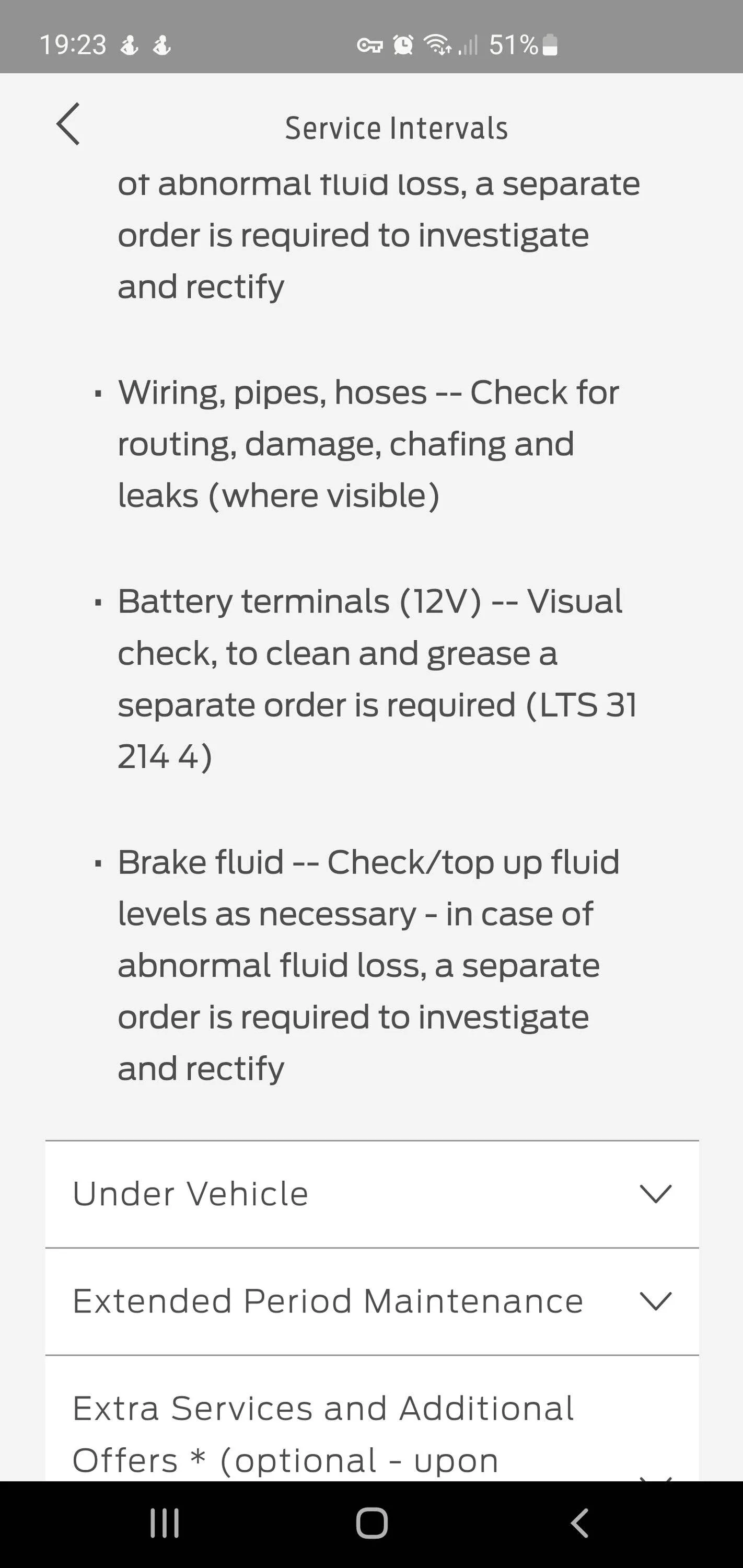

Does anyone know what's included in the service plan that was sold with the car? Dealership wants to replace the brake fluid saying its not covered at its 2 year service
This is what it says on the service tab on the FP app
Ford Mustang Mach-E UK Customers Screenshot_20231006_192319_FordPass
