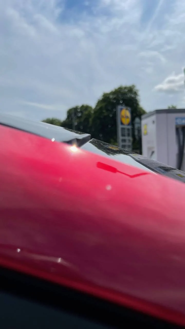

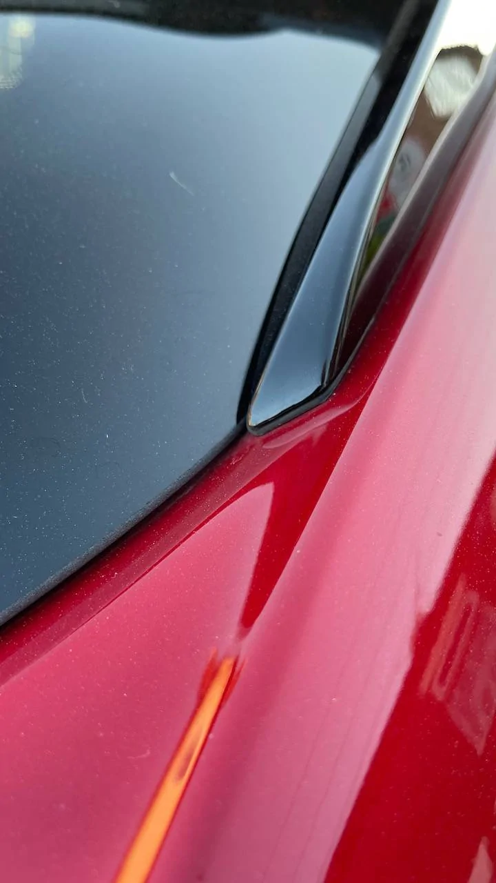

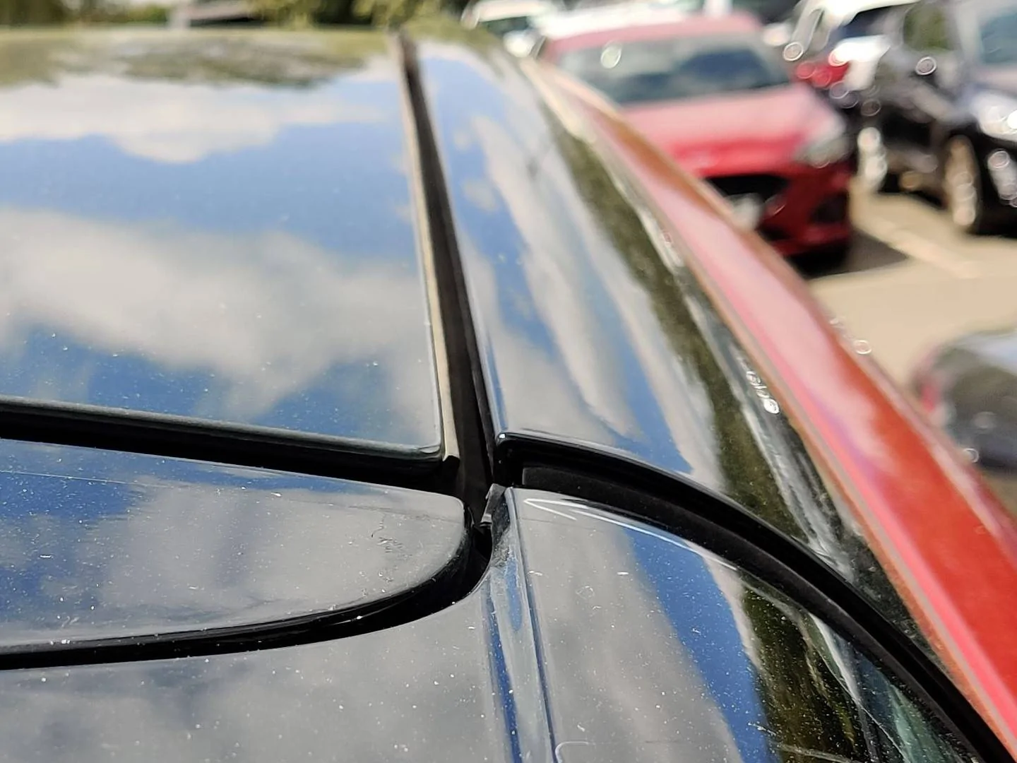

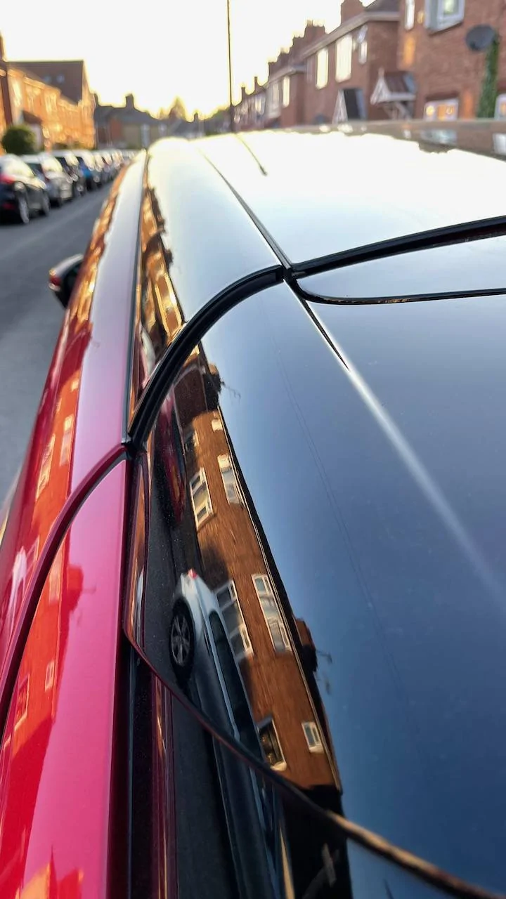

Pano Roof alignment (rear):
Ford Mustang Mach-E UK Customers IMG_6092

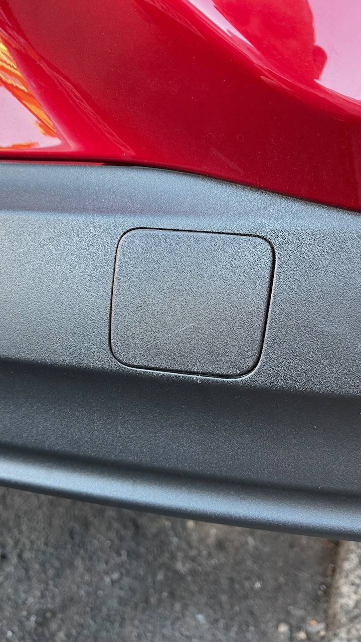

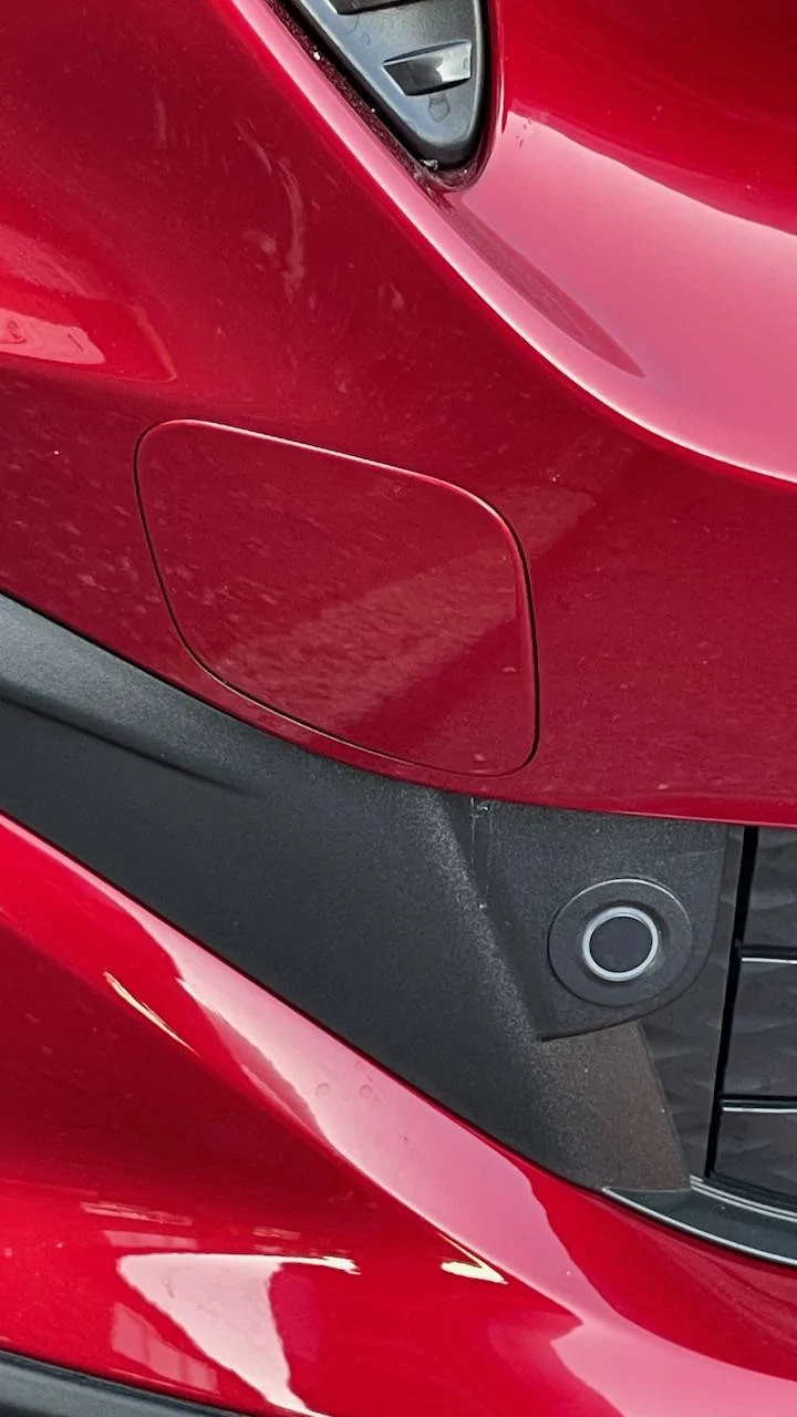

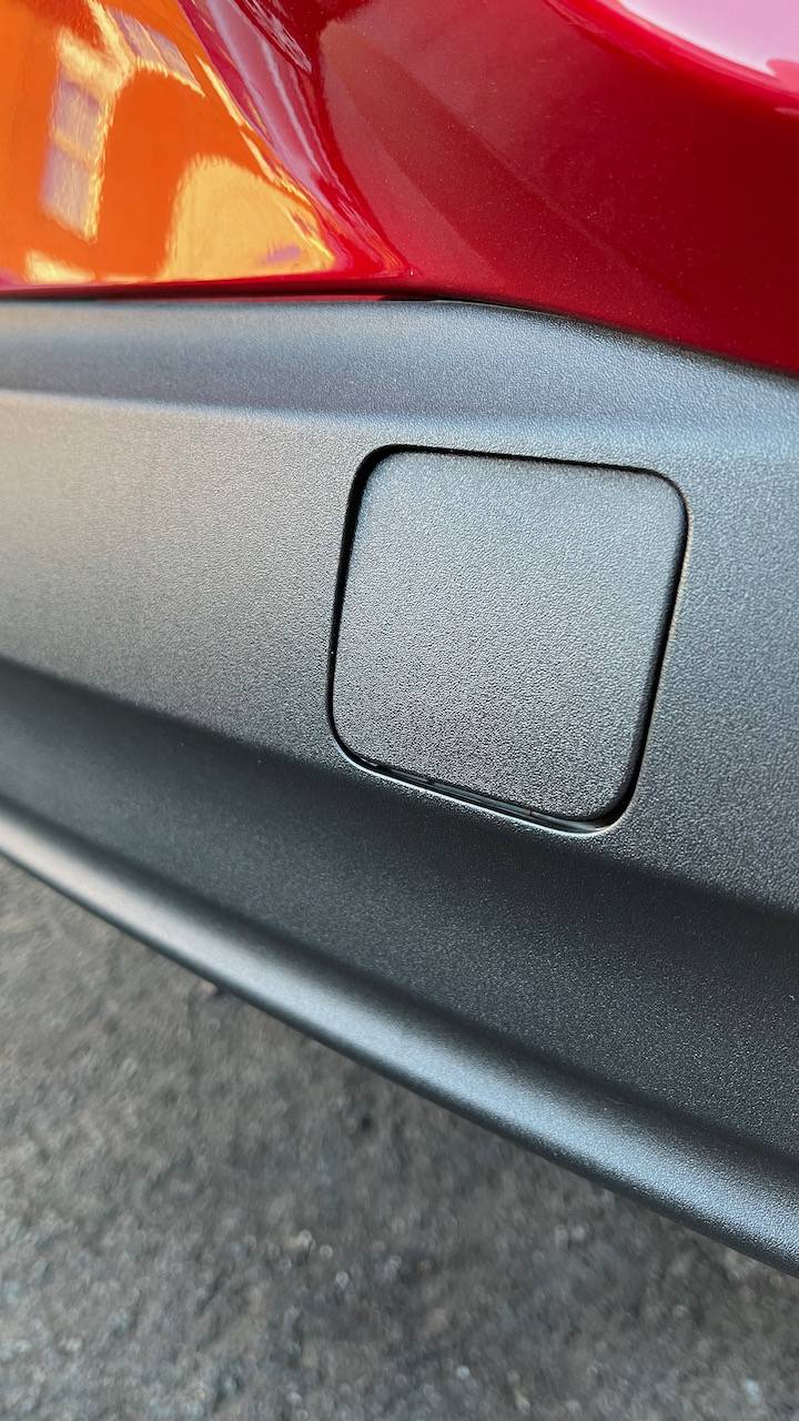

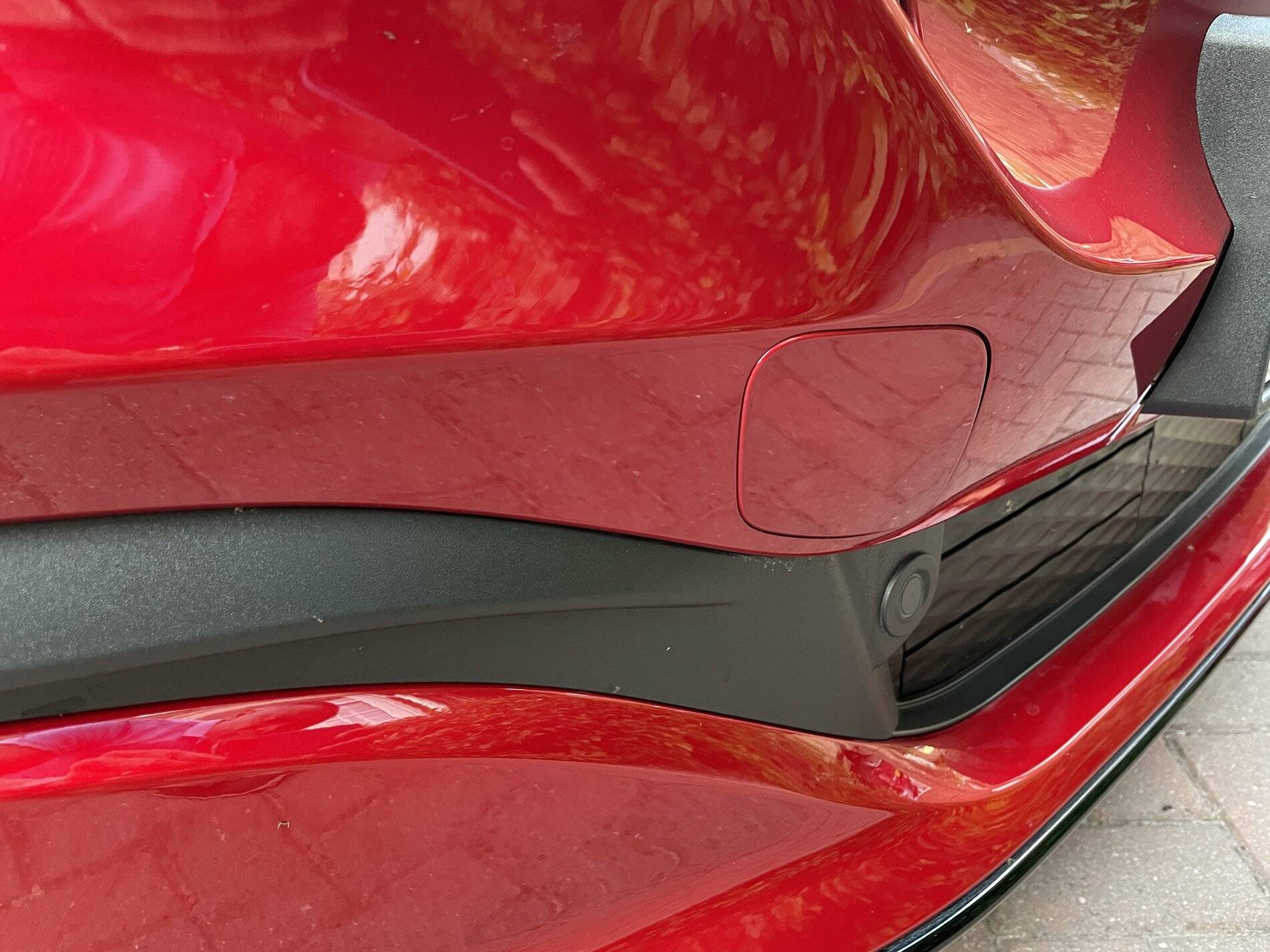

The front tow hook cover - the tow hooks are used during shipping to secure the car to the boat. Quite often the load/unloaders just shove them back. I hadn't paid much attention to mine, but on closer inspection the front one looked fine, but the back one was all over the place. I popped it out and re-seated it properly and it lines up like a dream. I imagine any misaligned flaps like these are just due to not being put back right after shipping.
Photos below....
BEFORE ADJUSTMENT:
GIVING IT A POKE TO OPEN IT:
AFTER PROPER RE-INSERTION:
FRONT ONE:
Thanks so much for doing this dude ??
Knowing it is a tow hook cover makes me feel better. Was worried it had a 12v issue fixed in Ant. Dealership should hopefully flush it up. Thanks again!

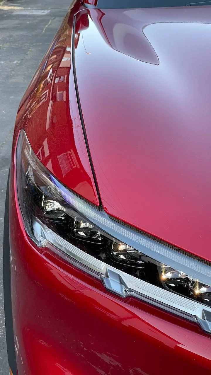

Front trunk alignment:
This is mine...

Regards David's panel fit, I think the problem isn't so much Frunk lid alignment but front wing alignment- especially the NS wing. I assume the wings are bolt on? If so the mounting bolts need to be slackened and the wing eased outwards. There's always 'wiggle room' built in. But don't try this yourself as I gurantee that a silicon or mastic type sealant will have been used.
Throw it back to the dealer as that fit is not acceptable. Wonkey's looks pretty well perfect to me. Is there any evidence that the car has been 'leaned' on during transit? Just thinking out loud as it were...

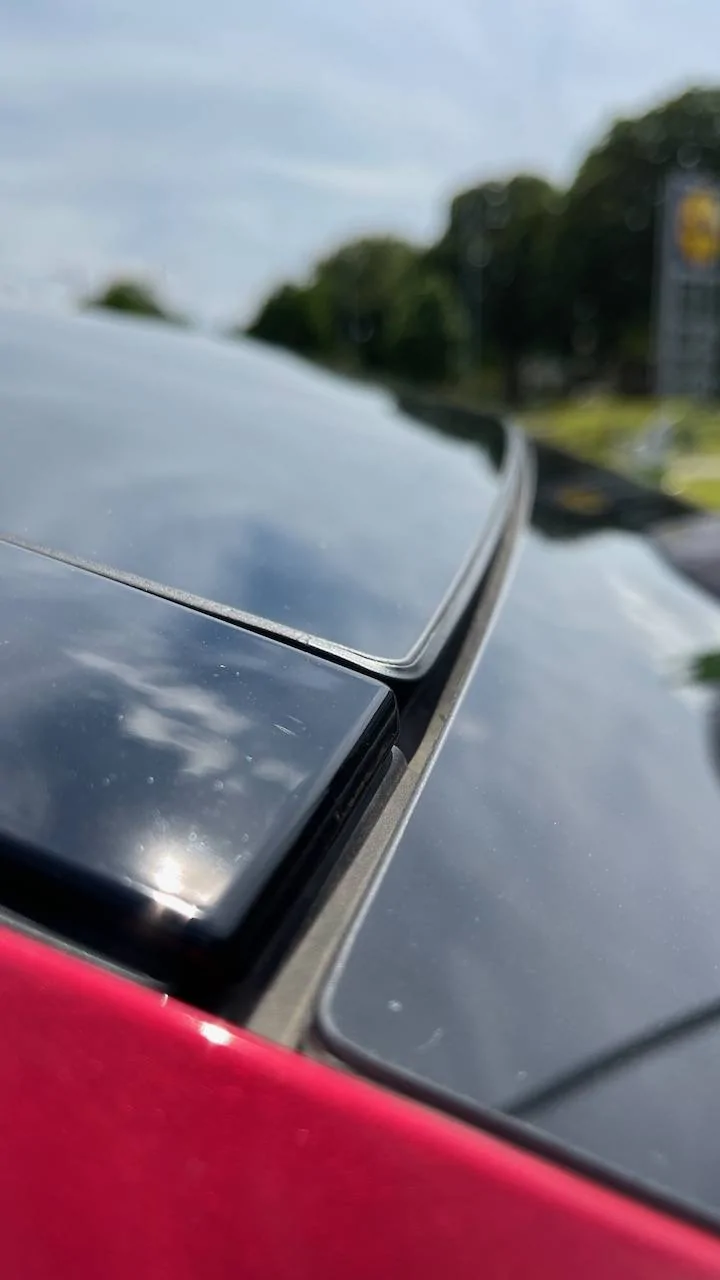

Part 3:
@David-HC - these were the rest of your queries...
Pano Roof alignment (front):

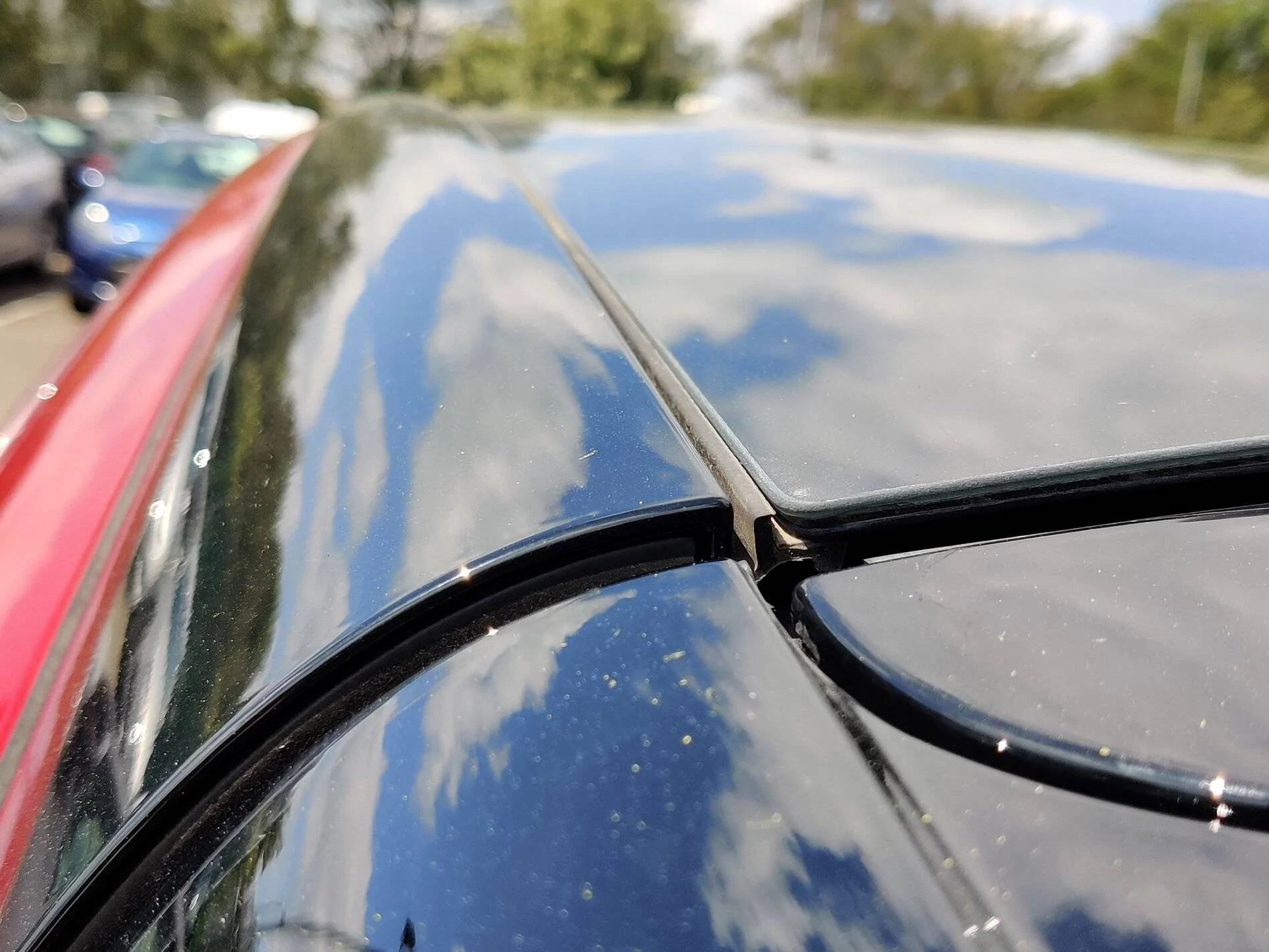

Many apologies, the issue with the pano roof on my car is more between left-hand side and right-hand side ....... sorry, I'm not sure my pics were very clear ?
Broadly the gap/channel running the length of the left/near side is significantly less than that on the right/offside. I tweaked the pics a bit to hopefully make it clearer ? (how do you align them side by side?)
Left/nearside
Ford Mustang Mach-E UK Customers MME Rear Left Roof v2
Right/offside
Ford Mustang Mach-E UK Customers MME Rear Right Roof v2x
Please don't worry about further pics (it's a bit dark now ?), but would be helpful to know how your car compares, if you are able to.
Thanks also for the date of build - much the same as mine ....... although perhaps mine was a Friday ?
I don't expect there is any adjustment possible with this, and the main concern is potential wind noise (as @SteveUk mentioned), but I guess they could insert an additional rubber strip to mitigate this? ?
Your help is much appreciated
PS: hope you are really enjoying the car!

Ah whoops - I did do an all round photo shoot - but the unpublished shots are not quite from the correct angle to see the left / right roof alignment gaps - I'll do some for you in the daylight :)
In regards to pano roof wind noise - I'll be honest I do have some even with what looks like a relatively well aligned roof. Weirdly though some days I notice it from about 30mph +, but other days I don't notice it until 50mph +. It's similar to the noise a side gust makes on a windy day, so more of a whooshing noise than a whistle. I'm in the process of ordering some different sized foam rods to see if that helps reduce the noise at higher speeds. It's one of those noises that is difficult to describe. It might be normal - it might not be, but it's not so bad that you'd get upset about.

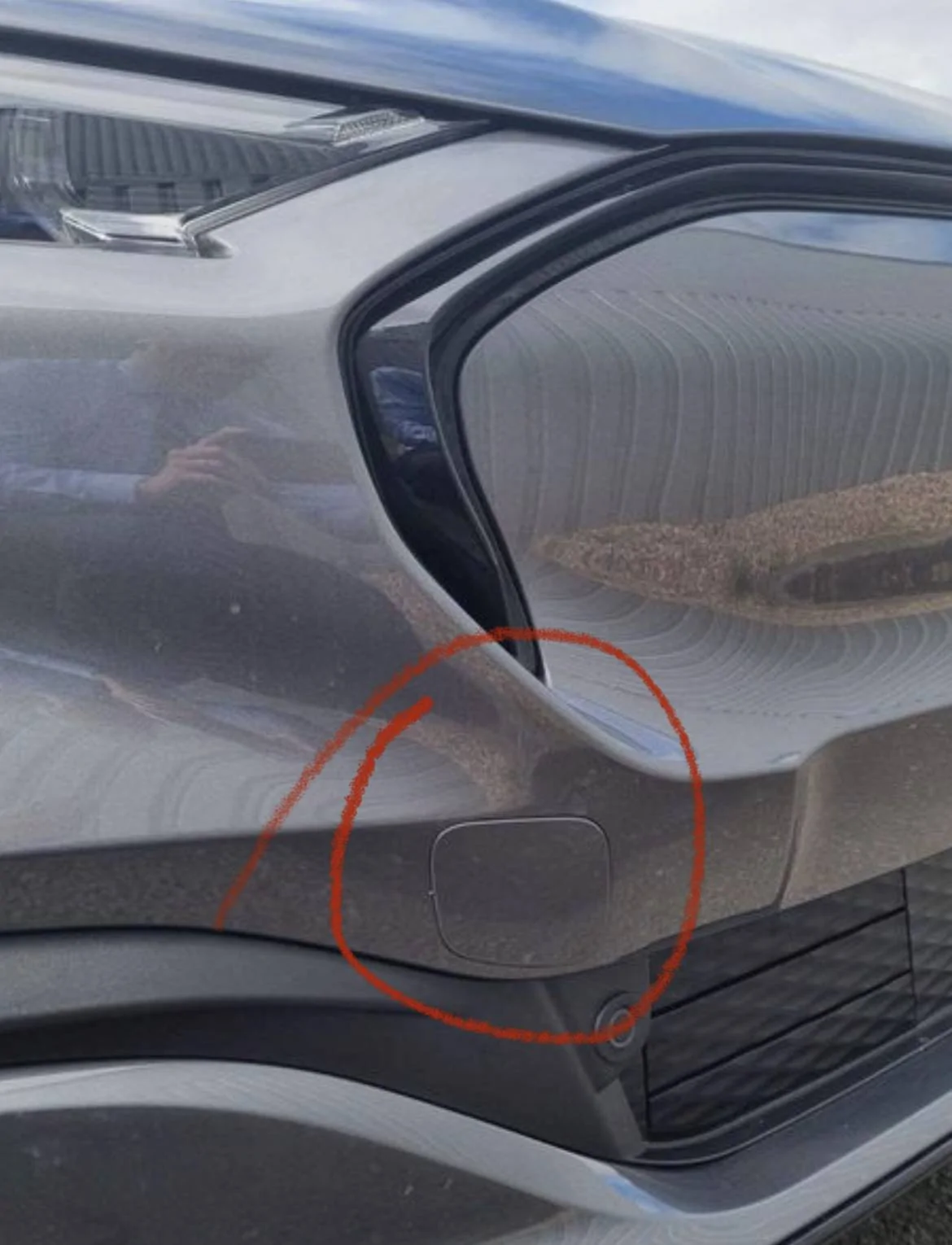

Ive not had a chance to inspect mine but I did notice from the dealers photos that the access port to jumpstart to 12v isn’t sitting flush with the rest of the body work… I’m wondering if you, or perhaps @Wonky_Donkey @portlandg or @Smoothbond have noticed something similar? If not, I’m hoping it just needs a firm push back in.
Mine's fine
