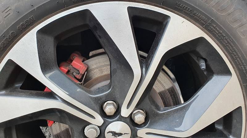

Hi all, my car is booked in tomorrow for the 'AWD Drive Fault' again & for any outstanding software updates not done last time it was in, I'm still on on 1.6.0 so if anyone has had theirs updated recently at a dealers which is the latest I should expect.
I know Wonky-Donkey had his updated to 2.1.0 last week, so anyone had a newer one yet.
Another quicky, I have had to put a lot of welly to overcome my brakes sticking recently how do you know which set of brakes is sticking & to confirm it (they both have a small amount of scoring).

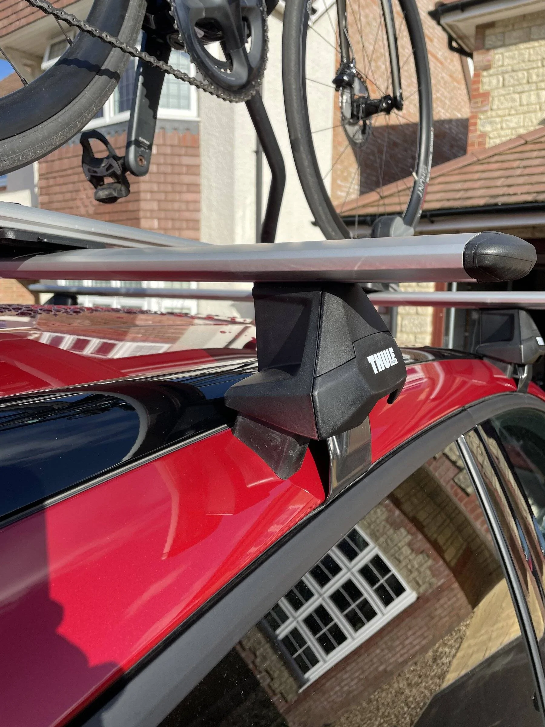

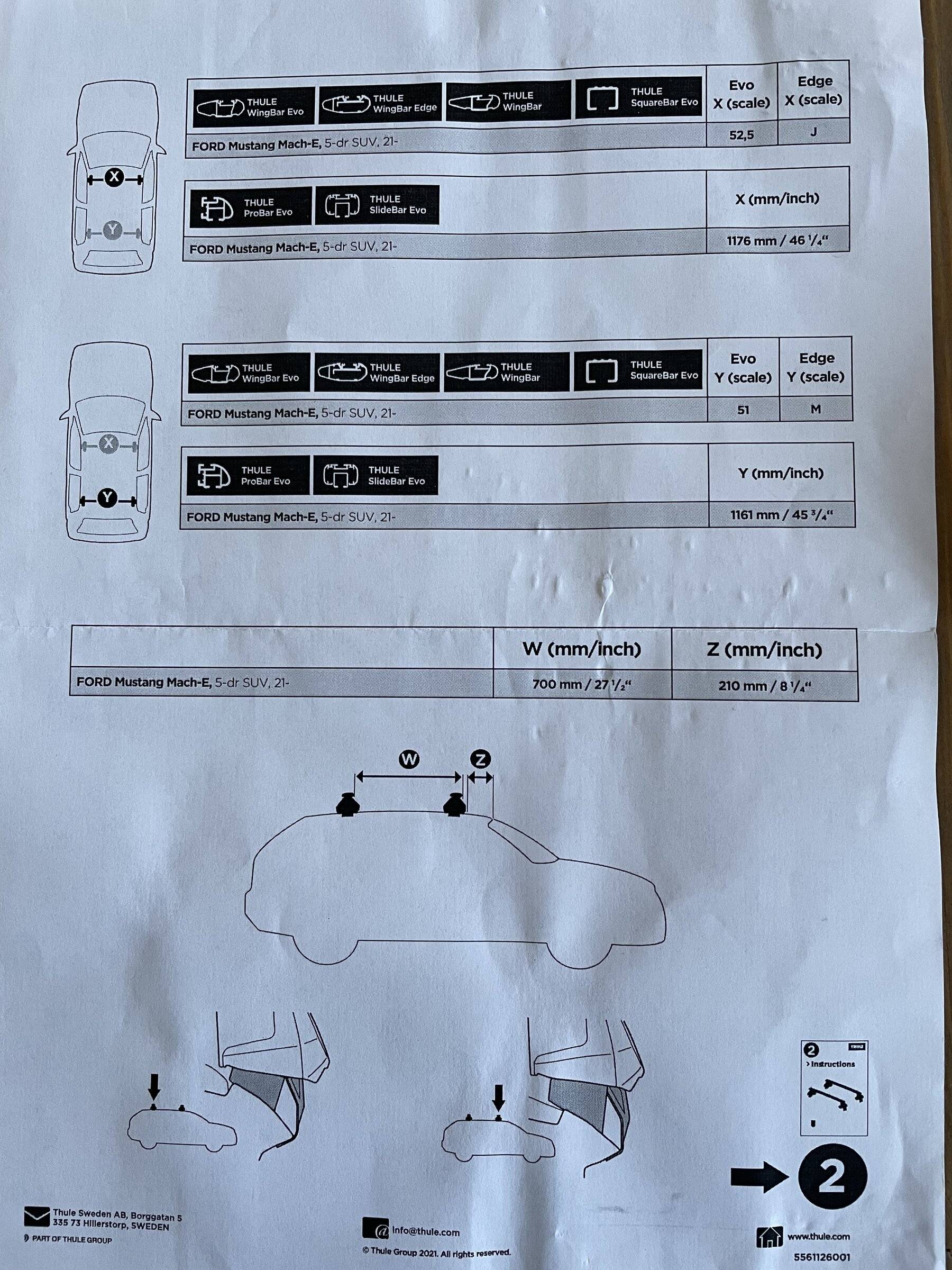

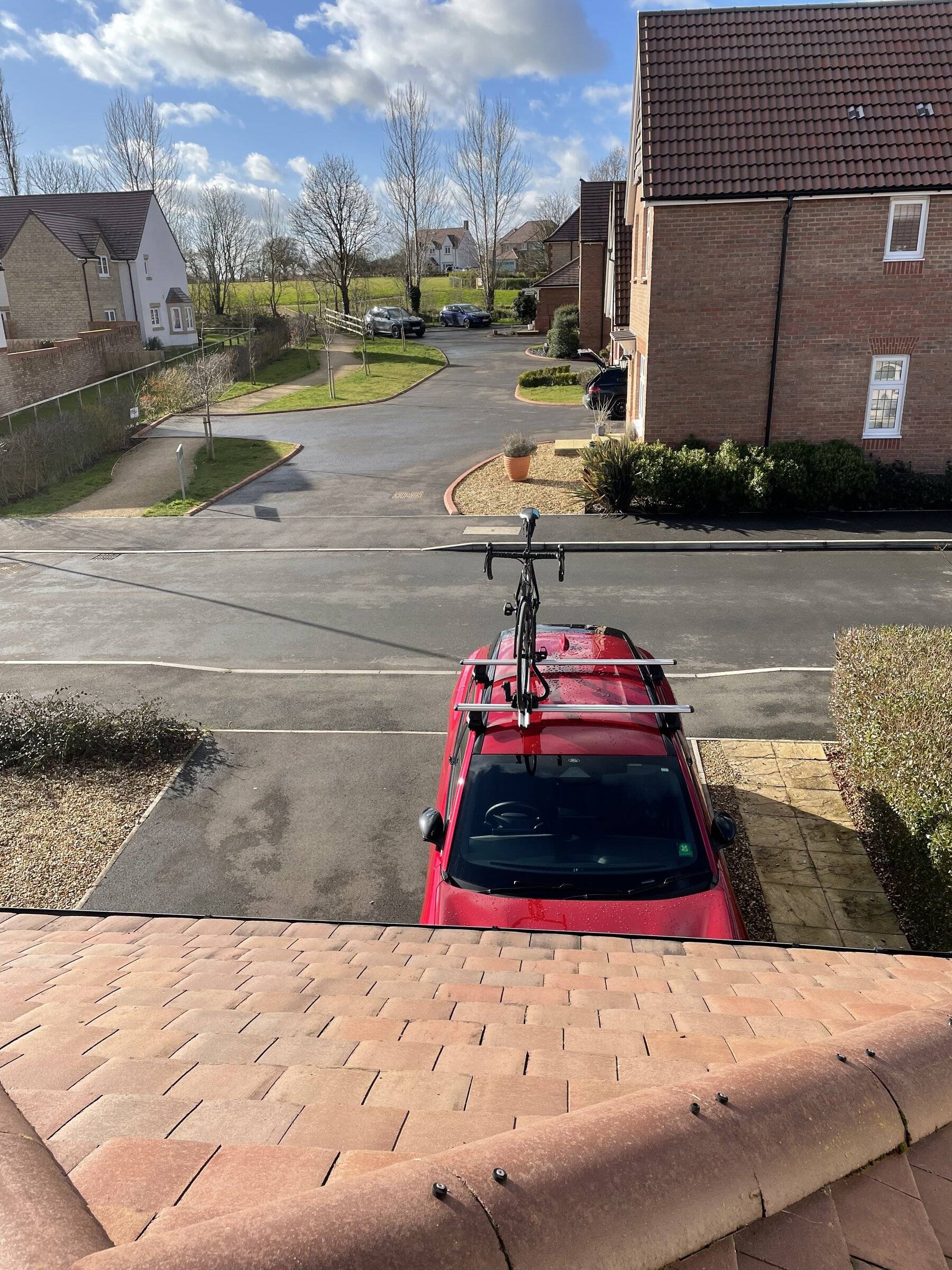

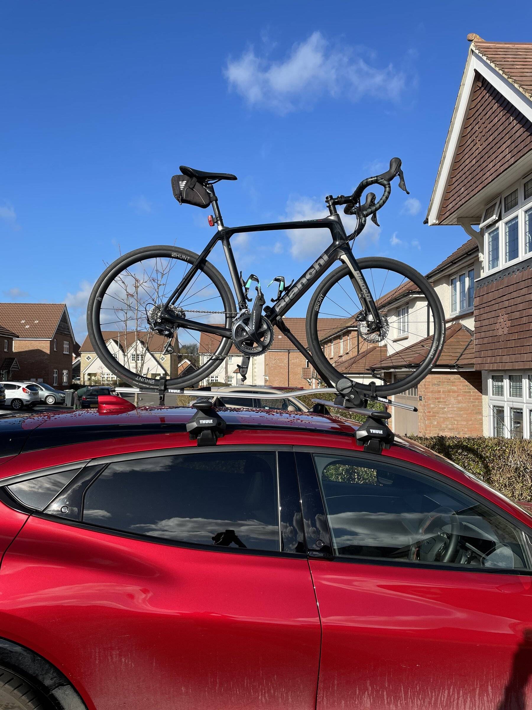

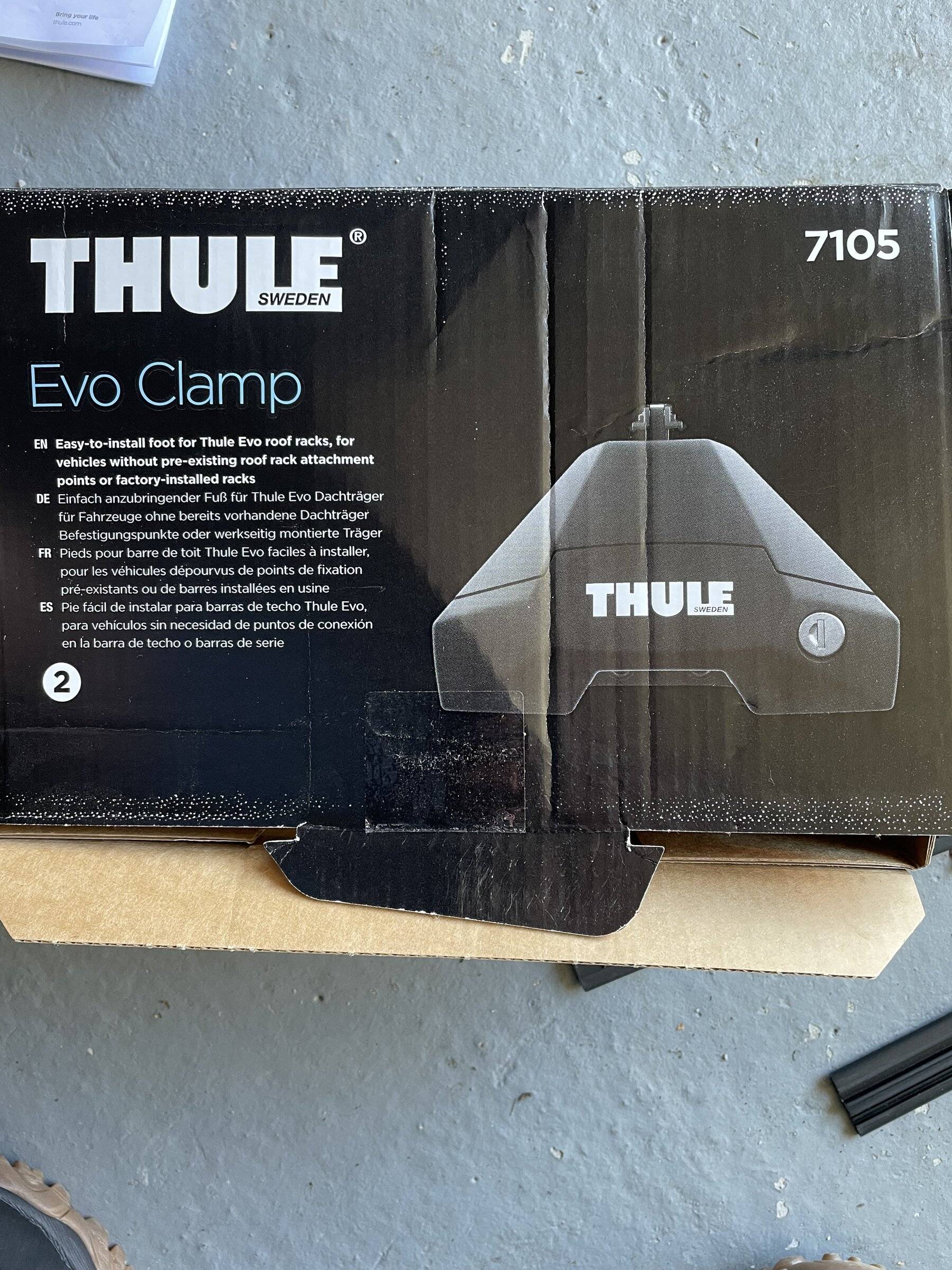

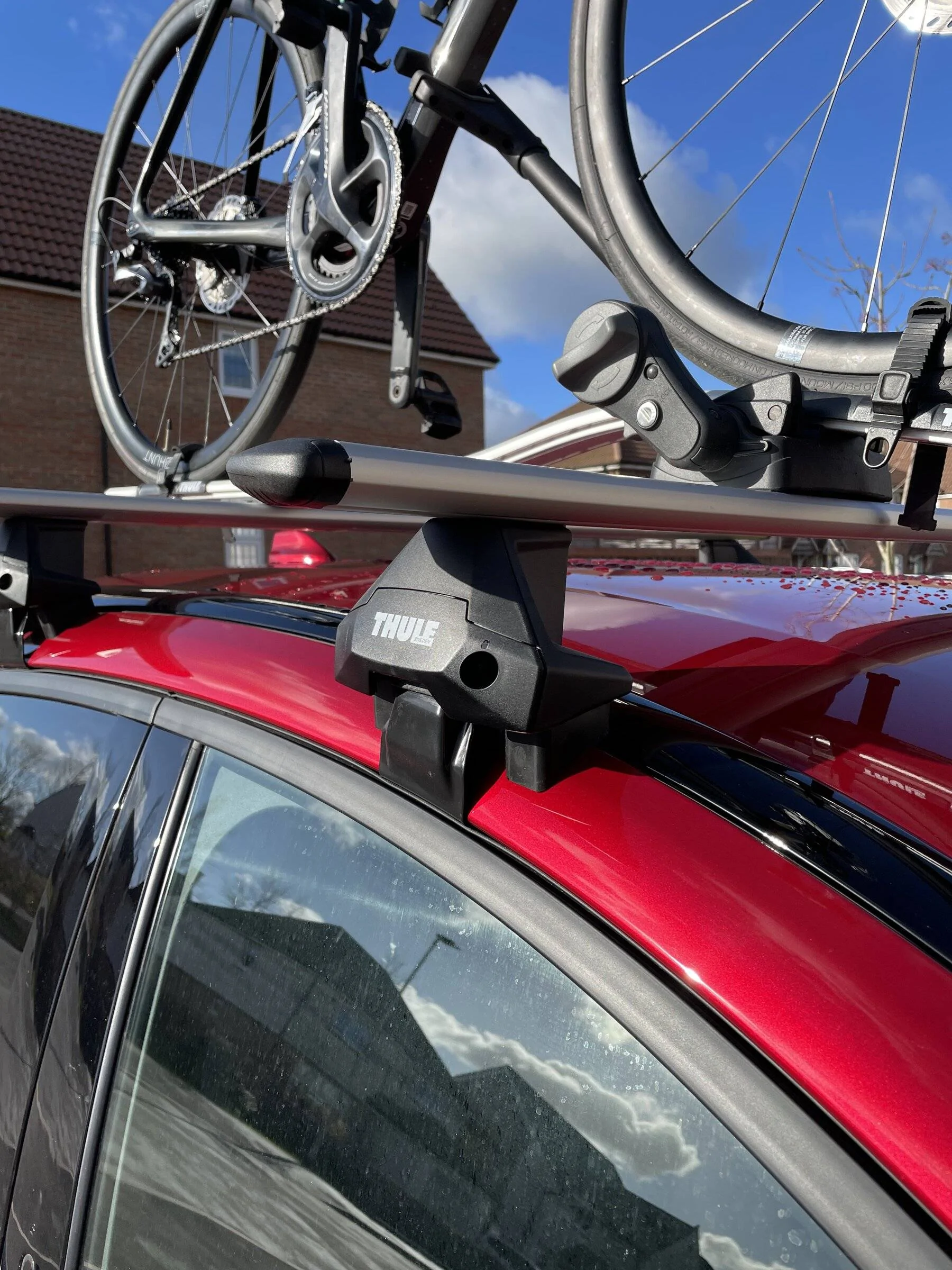

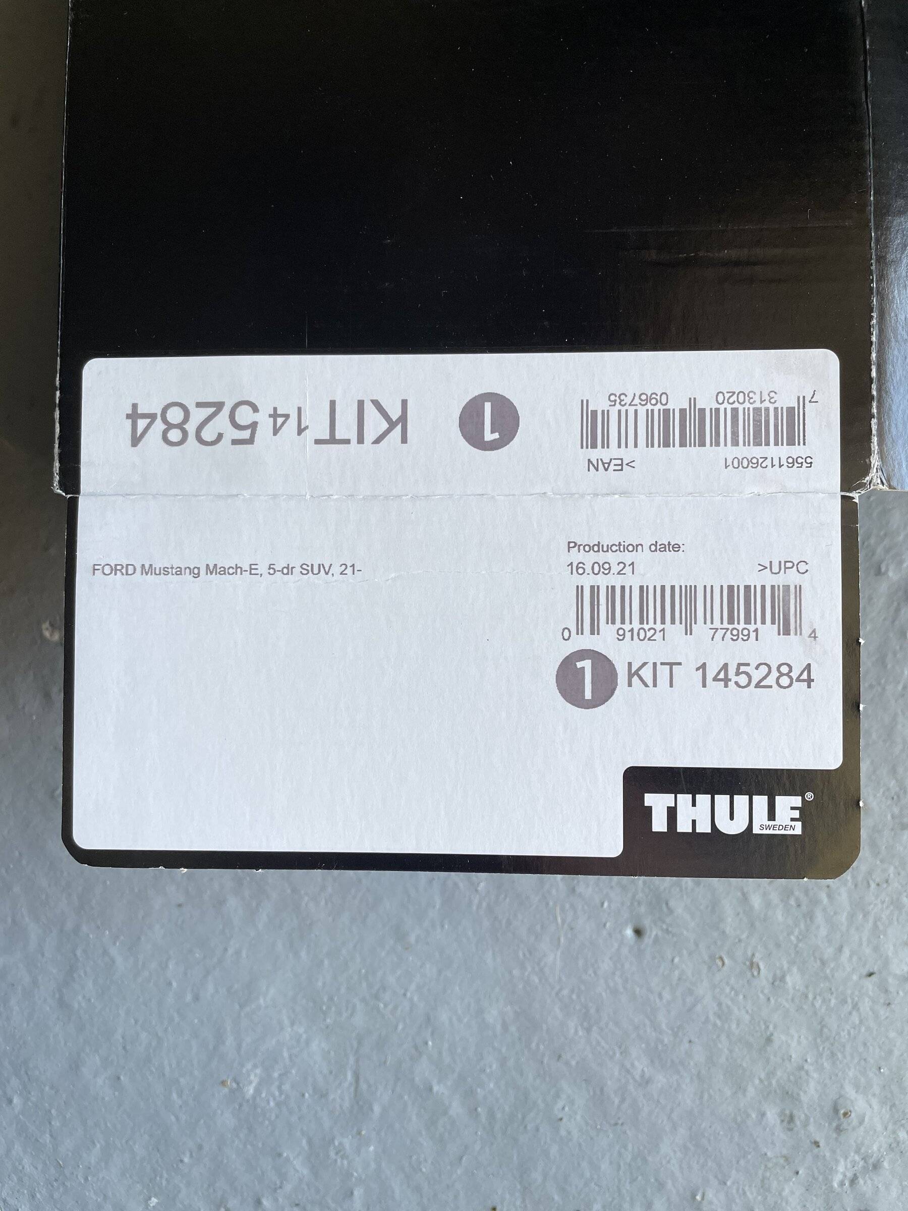

Hi all. Just a quick update on the roof rack situation. I bought everything from Thule.com and all is well. However, I believe that there is no roof load weight for the EU market and it appears the kit I got is no longer on the Thule website. I’ve not finished the fit off completely, not installed the locks or rubber strips yet, but I can confirm it all fits correctly and that part numbers etc. are correct.
