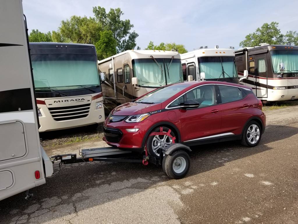

What about backwards dolly towing in a RWD model? Seems like that should be possible.
What I am more interested in is automatic car wash where you have to put the vehicle in N.
You need a good leather belt to tie the steering wheel; then good to go ;) . Think a flatbed, if you can, is the way to go.
You would also need a dolly with a pan that turns.
Some dollies (sadly, like the one we own) are fixed: You have to unlock the steering so that the car can follow along.
Also note that on dolly's with a turnable pan pulling cars with unlocked steering (e.g. just about every push button start car these days) people typically use the seatbelt to tie up the steering wheel to keep it from turning.
So all of the above is one strike why we couldn't tow a Mach-E behind our RV, the other strike is its simply too heavy. We can only tow 5k lbs and thus a Mach-E on a trailer (even if aluminum) would be out of that range....
Thus we'll be bringing an Escape FWD along with us camping once the Mach-E arrives (and the Bolt goes back to GM).
