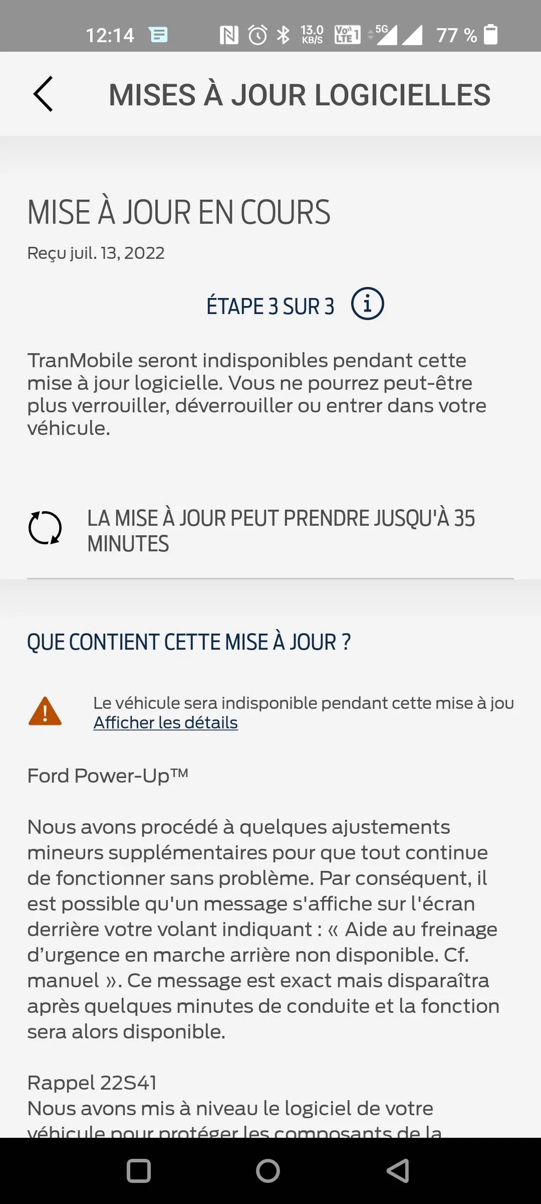

I had a successful OTA update last night and would appreciate you running my VIN again to see what modules were actually updated and to what versions. VIN: 3FMTK3SS6MMA09369 Thanks
I see you haven't gotten a response yet so I ran your VIN again. You are currently showing the exact same updates available as when I ran your VIN on the 9th.
Assuming the OTA update fairy ?‍♀ delivered...these are the module updates that should have been done and the versions as they now are shown in FDRS:
PCM MJ98-14C204-AXK
BECM NJ98-14C197-AE
SOBDM LJ98-14F476-AU
SOBDMB LJ98-14H297-DE
SOBDMC LJ98-14G069-AXH
I ran another VIN this morning for a member who also had the OTA ?‍♀visit and from that I was able to compare the module list from a previous VIN check to determine what modules got updated.
