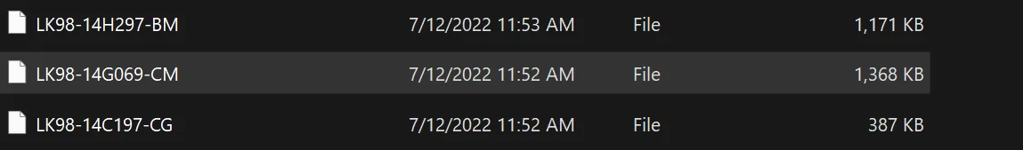

I might have extracted the software version from a JSON file the update tool downloads. I haven't actually updated the car yet.
Code:
Module   Before Recall     After            Next up?
SOBDMB   LK98-14H297-BJ    NK98-14H297-BC   NK98-14H297-BD
PCM      MJ98-14C204-ABJ   NJ98-14C204-UC   NJ98-14C204-UD
Unfortunately, I didn't do this before today to see if it checks out, so speculation at best. (we all like that).
Code:
EDIT: 2022 GT Mar 1 Build.
Interesting because I got different versions. Maybe the difference between the MY21 and MY22?
I think you're correct. I just pulled a random 2021 GT VIN off Cars<dot>com and got the same calibration version out of the JSON file. That car needs a lot of updates...lol
