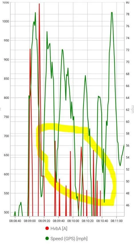

I did my own aggressive drive up a mountain, and while I didn't think about it at the time, the acceleration was pretty poor after the first few presses to the floor.
https://www.macheforum.com/site/threads/i-tried-to-kill-my-hvbjb-and-failed-i-can’t-wait-to-try-again.25554/
You can really see it here. I was flooring it every time the red line spikes, and after the first two, it was severely limited.

At 75 the GT still has a little bit if you have not gotten on it in a while. The massive amount of jail bars happens at 80, where a crappy Skoda wagon will beat the GT. The only races a GT can win or come close to winning are off the line. Even then, there are a good number of cars that will beat it or crush it. ??
