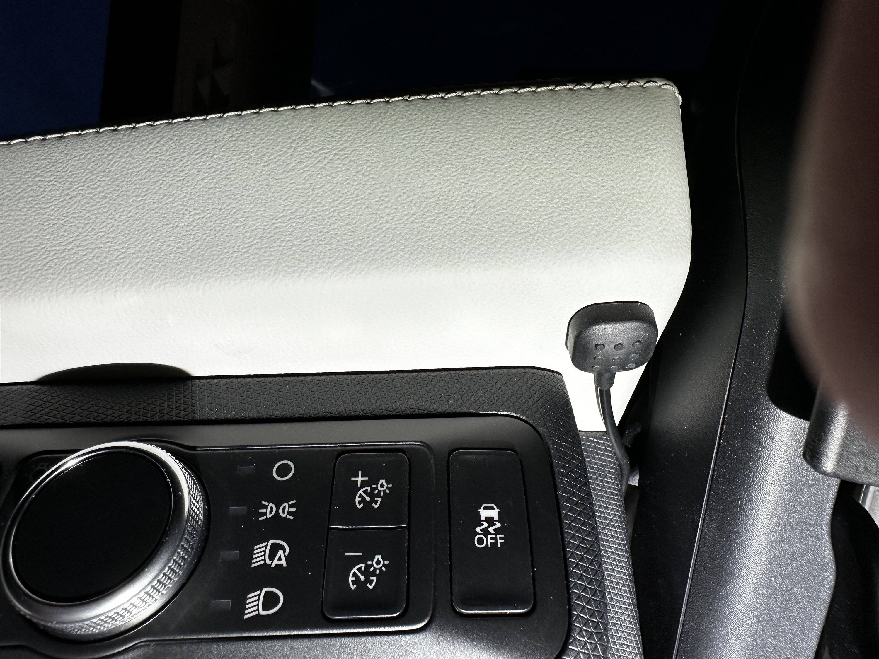

+1 success story, installed the Twidec momentary switch right next to the sub remote volume control below the center arm rest. @markboris thank you again for all of your contributions, I love my mach-e even more (by a lot) after following your guides.

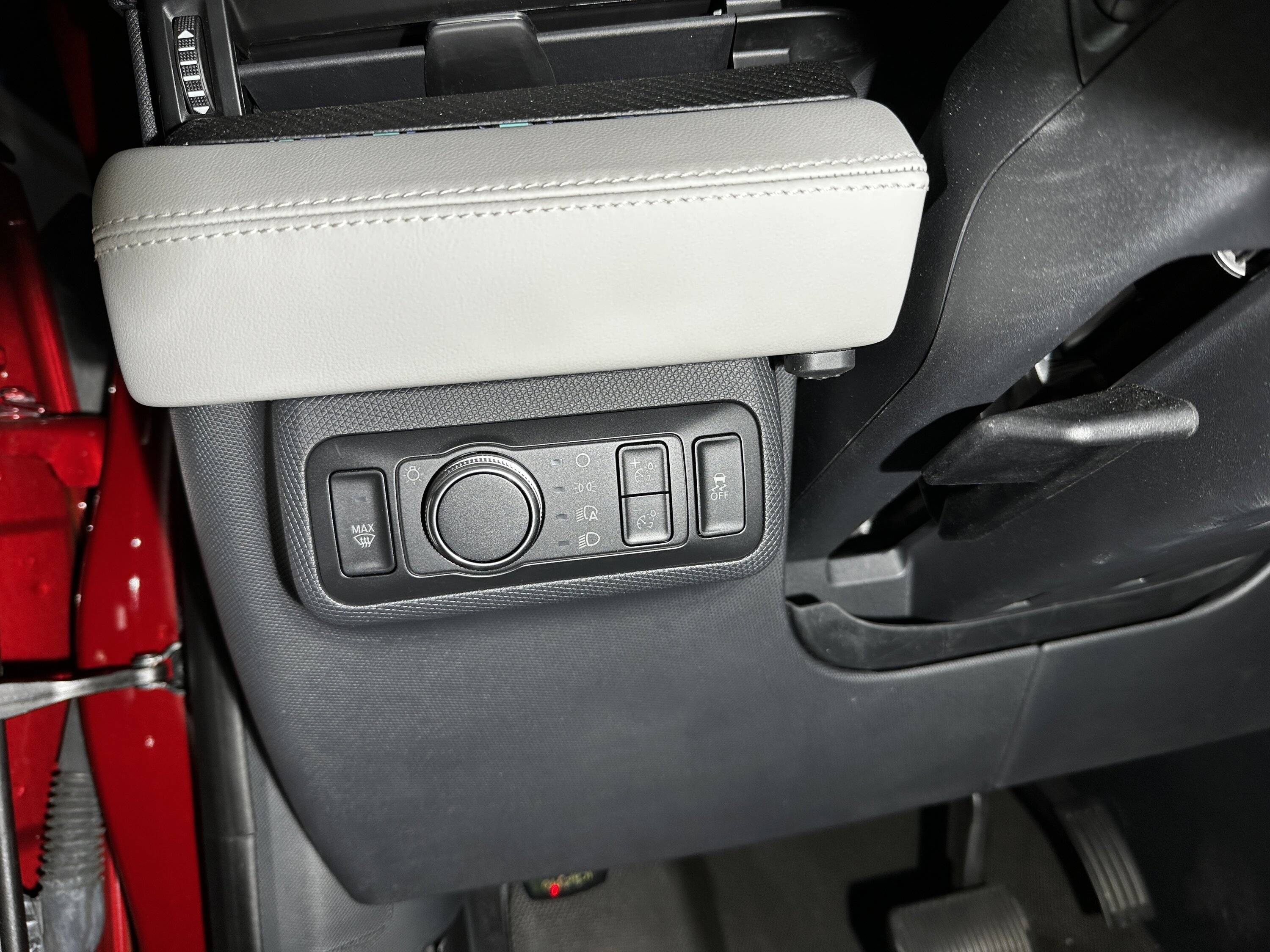

Finally made the effort and installed the switch. The hardest part…I am colored blind so the green and brown wires all looked the same. I counted 4 wires that could have been brown. Somebody wrote that it was a really thin wire. So I put a ground wire on an Xacto blade and probed the thinnest “brown” wire and the tailgate opened. Victory!
it’s a rubberized switch from Amazon. I put it here so it isn’t easily seen.
