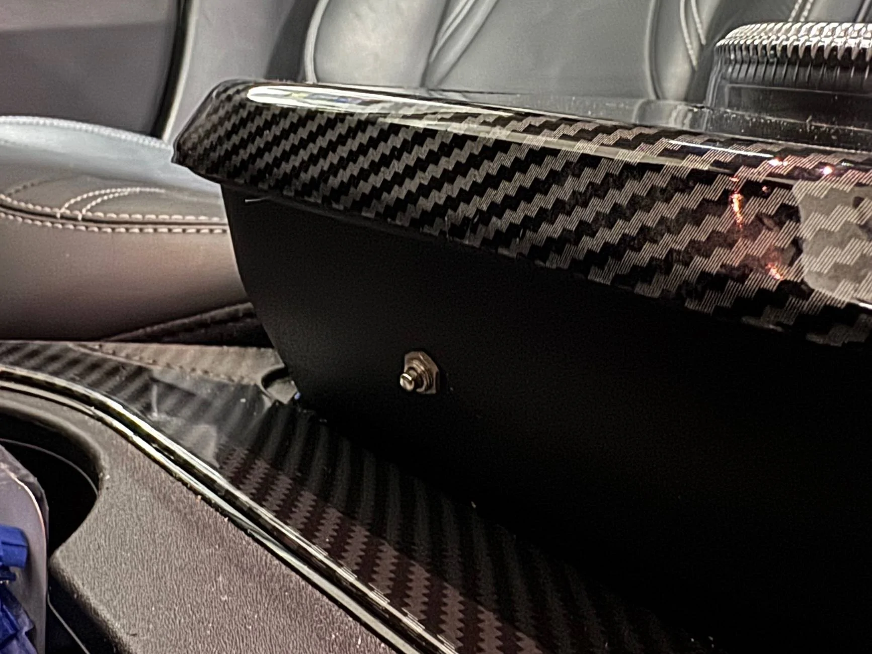

I was at a friends this morning who also has a Mach-E and she said the one thing she misses is a simple power button to open and close the liftgate. She doesn't like having to turn the car to accessory and make three selections on the center screen. She just wants to push a button.
I thought it couldn't be that difficult to wire up a switch to do this and I was right. I took a look at the wiring diagram and found that both momentary switches in the liftgate do nothing more than short an incoming wire from the BCM to ground. The BCM is located at the front passenger footwell at the top. Extremely easy to access just remove the panel that hides it and you can get to the wiring. The wire that is needed to tap into is solid brown and located at the large top plug connection. I tapped into it and ran the wire to the center console where I installed a small momentary switch just below my subwoofer volume control. For the ground I used the black/blue wire going to the parking brake switch in the console. All the black/blue wires throughout the car are grounds. I had this momentary switch laying around but I am going to change it out with one that is much flatter.
I now have a working power button that will open and close the liftgate from inside the car without having your key fob, or phone. The car can be on or off but the doors have to be unlocked and in Park. It works just like the one in my 2014 Escape did. I could have mounted the switch is several easy to see locations but like to conceal my work (like I did the subwoofer volume control) so nothing looks "added on". Just drop your hand down in front of the console and they are both easy to use. Besides if I ever needed to remove it, all I'd have to do is put a little flat plug in the hole and no one would know any different.
It took me about an hour to do the entire thing but now that I did it, when I do hers, probably should only take 30 minutes. I took quick photos of where I tapped into the wiring and it was before I permanently attached and taped up the wires.
Edit: After getting my '21 GT when I did this mod, instead of adding a button on the console like I did on the Premium, I replaced the max defrost button on the headlamp switch with a liftgate button from a bronco found in this post #57
Edit again: After getting my '24 GT, I decided to use the useless Park Assit button to activate the liftgate in this post #276
Thanks for the excellent instructions. My buddy had an industrial grade micro switch that we used. Working great.
