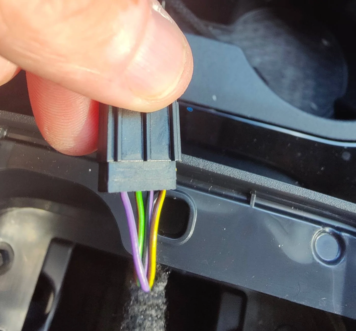

I pulled up on the center console, and this is what I saw. You had mentioned that wr have to splice in to the blue/green wire, right? It is second from the left in this picture.
No, it’s the green/brown wire you must cut and attach the brown wire from the BCM to.
I don't see a green /brown in those 4 wires...

What color is the stripe on that green wire? It looks brown to me in your photo.
Yes, it's green with a brown stripe, or viceversa, in position 2 from left to right.
