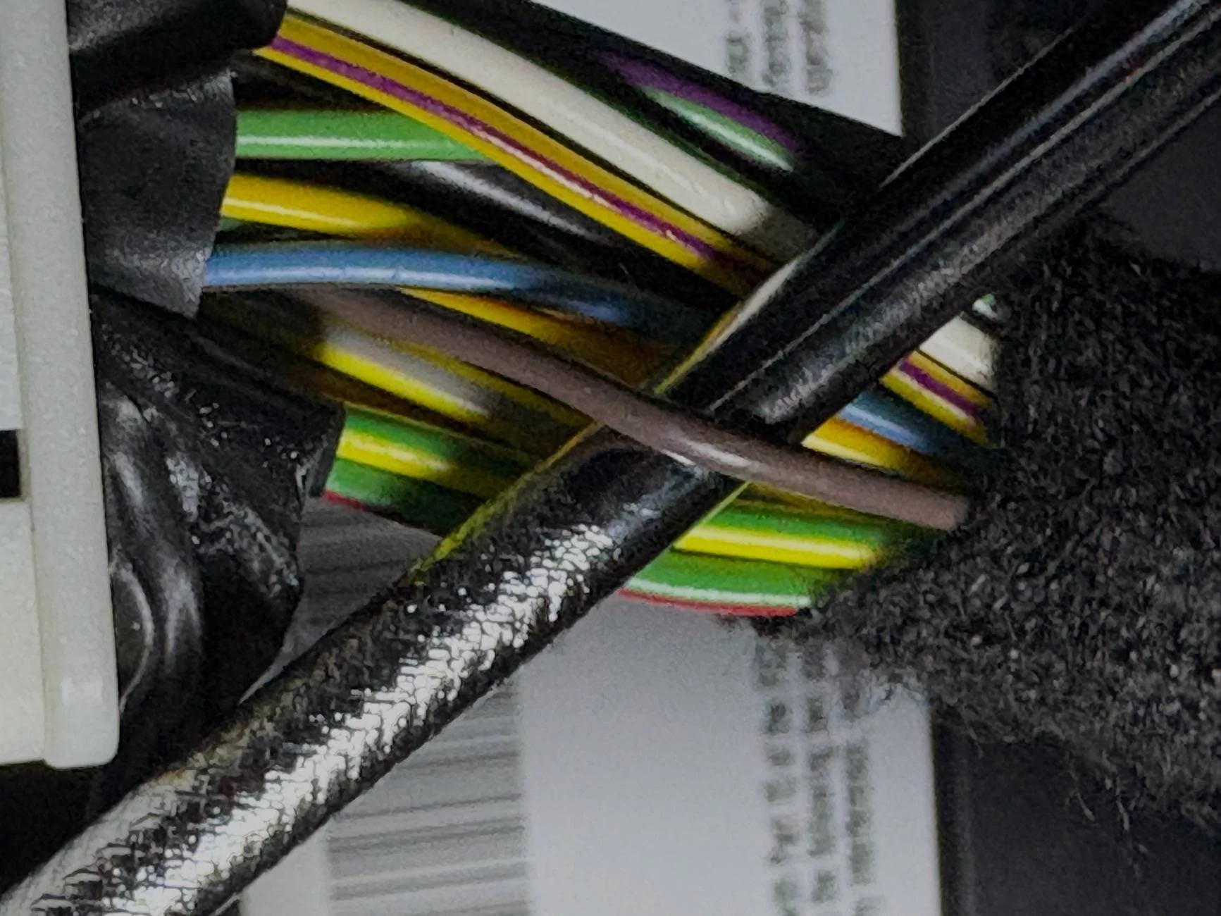

I have been trying to find the brown wire, but I can’t seem to find it. Maybe the color is a little different for my 2023 Mach e . I think my carā€˜s brown wire is more of a purple like color, almost grayish. Does anyone have any advice?

I think that someone in earlier posts mentioned that his was purple. Read most of the thread; it's long, I know.
thank you,
It was this one for mine

It can also be tannish in color. There are only 6 wires that are solid colors. White, Black, Brown, Green, Gray and Yellow

I attempted this 7 hours ago and add these tips:
1. Make sure you're looking for the wire in the bundle attached to the top white connector in that foot panel. You'll see upper white, smaller black, and lower white.
2. You can unplug that white connector to make this a lot easier. The car will make some clicks, but all will be fine. The white plug has a black lever ob top that can be moved by playing with a small plastic lock on the grabbing end.
Thanks @markboris for this tip.
3. Be careful when cutting the black sheath that wraps around since you obviously don't want to cut any wires.
4. Look with good light for that elusive brown or perhaps purple-esque wire. Mine in my 24 premium was dark chocolate brown. Look back a few posts to see it.
