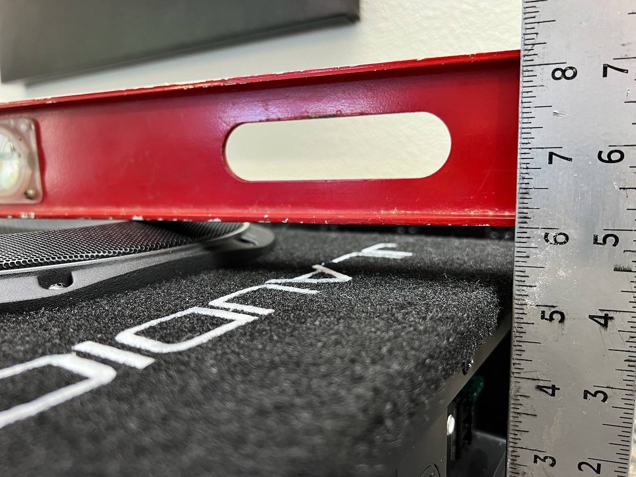

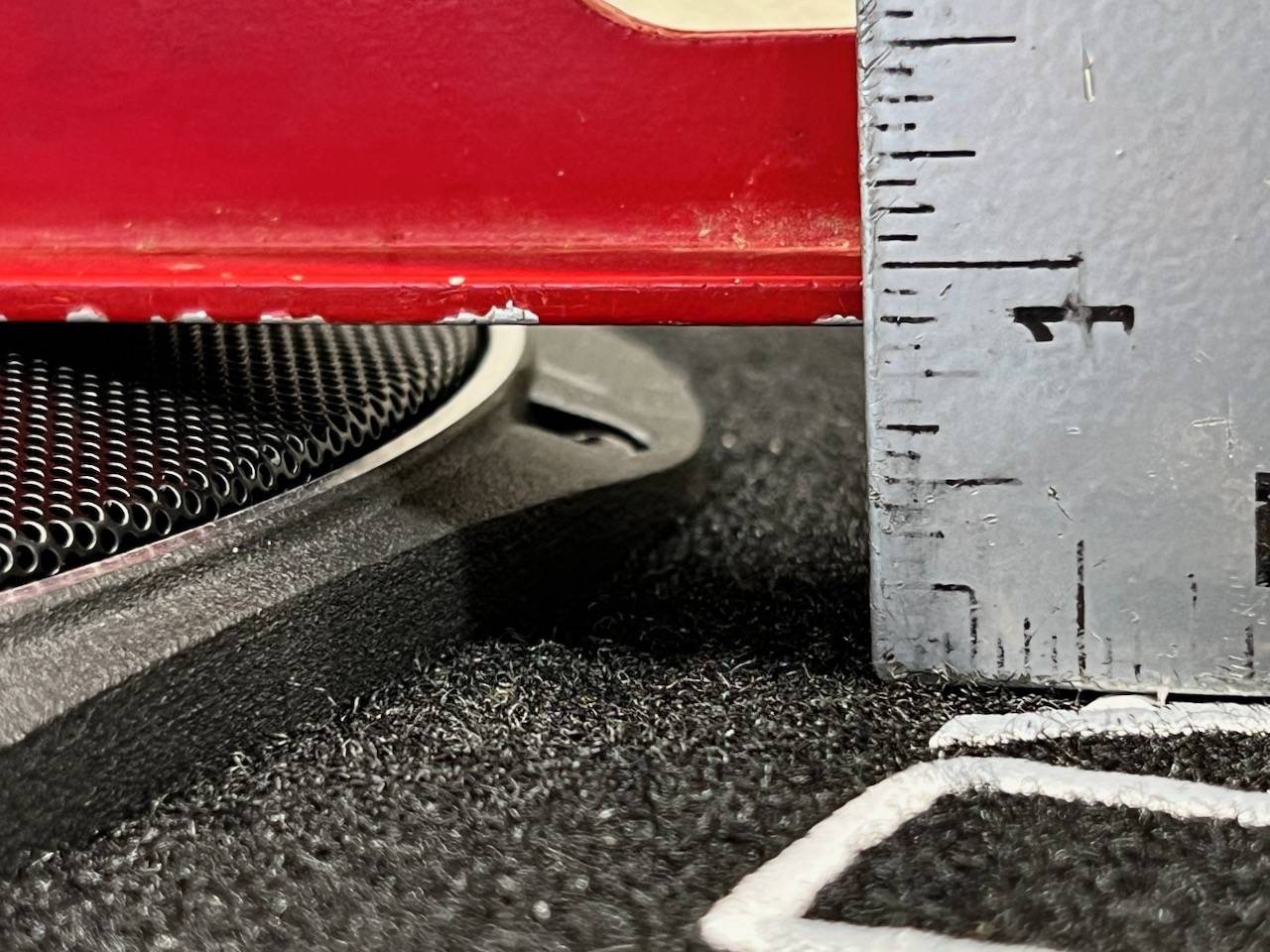

Hi Robert, I just measured the height of the JL 10" sub box at 5 3/16" and the grill protrudes above that just about 7/8" so total is about 6".
I probably should have been a bit more clear in explaining why this 10" JL sub does not fit flush with the cargo floor in the lower position in my GTPE when it did fit just fine in my Premium. I sound deadened both cars which included removing the carpeted lower cargo liner and adding dynamat and 1/4" dynapad then reinstalling the cargo liner. Those three materials together are 1/2". In the Premium I cut out all that material the size of the sub box allowing it to drop down 1/2". In the GTPE I did not cut it out so it is higher and the cargo floor hits the top of the grill.
You won't want to remove the grill as the excursion of the woofer cone gets very close to the grill when fully extended. While that does not happen often, I think it is safer to keep the grill on at all times. I hope this answers you question.
That helps so so much I appreciate it! You’re the best!
for future readers though… I’m not sure if anything changed in the trunk area since your premium, but I shaved my box down to 6” exactly and removed the carpet. It’s still too high by about 1/2”.
