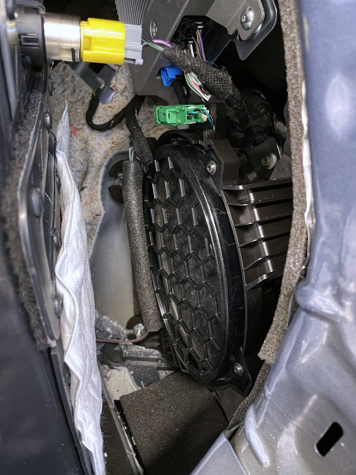

I was finishing up my sound deadening project on the Mach-E (one on of the first things I do to any vehicle besides changing wheels and tires) and in the last trim panel I removed, came across the pathetic, cheap, 6x9 paper cone subwoofer, if you can call it that. I thought to myself, this has got to go. Some cars I revamp the entire system and limit myself to between $5000-$8000 and others I just change out the sub and call it a day. The Mach-E is one of those. I’ve had all the door panels off and even the dash soundbar cover and the speakers in this car are not of the highest quality but they sound decent and get the job done especially if you don’t need to turn it up too loud. Speaking of volume, the amp in this car measures about 5”x5” and powers all the speakers. I am pretty sure it isn’t very powerful so the speakers are obviously very efficient.

In the past I’ve taken many photos while doing mods on my cars but in the last few years have gotten lazy but mostly forget to do it. Below are a few photos I did take while working on this. Removed the panels and storage bin in the frunk to gain access to the positive terminal of the battery. Ran the blue 8 gauge wire from the terminal to a fuse that I zip tied to the negative battery wire. It was a good location for the fuse and if I ever need to access it I only have to remove the one panel across the back. In one of the large rubber boots in the firewall with a large bundle of wiring going into the interior, there was an area that looked like it was intended for more wires but closed off. I made a small cut in that rubber area and again made another one on the inside of the firewall under the dash to allow the wire to come through (it is a double wall boot). Ran the 12+V wire down behind the left side kick panel, under both front and rear kick plates and to the rear cargo area.
I removed the right trim panel in the cargo area in front of the OEM sub and disconnected the wires to the sub. Attached an 18 gauge speaker wire to the two wires that were going to the sub for my audio input to the JL amp. Green/Violet + and Gray -. Just above the OEM sub is the B&O amp and to the left of it is a ground to the metal wheel well. I also used this grounding point to attach my 8 gauge ground wire for the JL amp.
