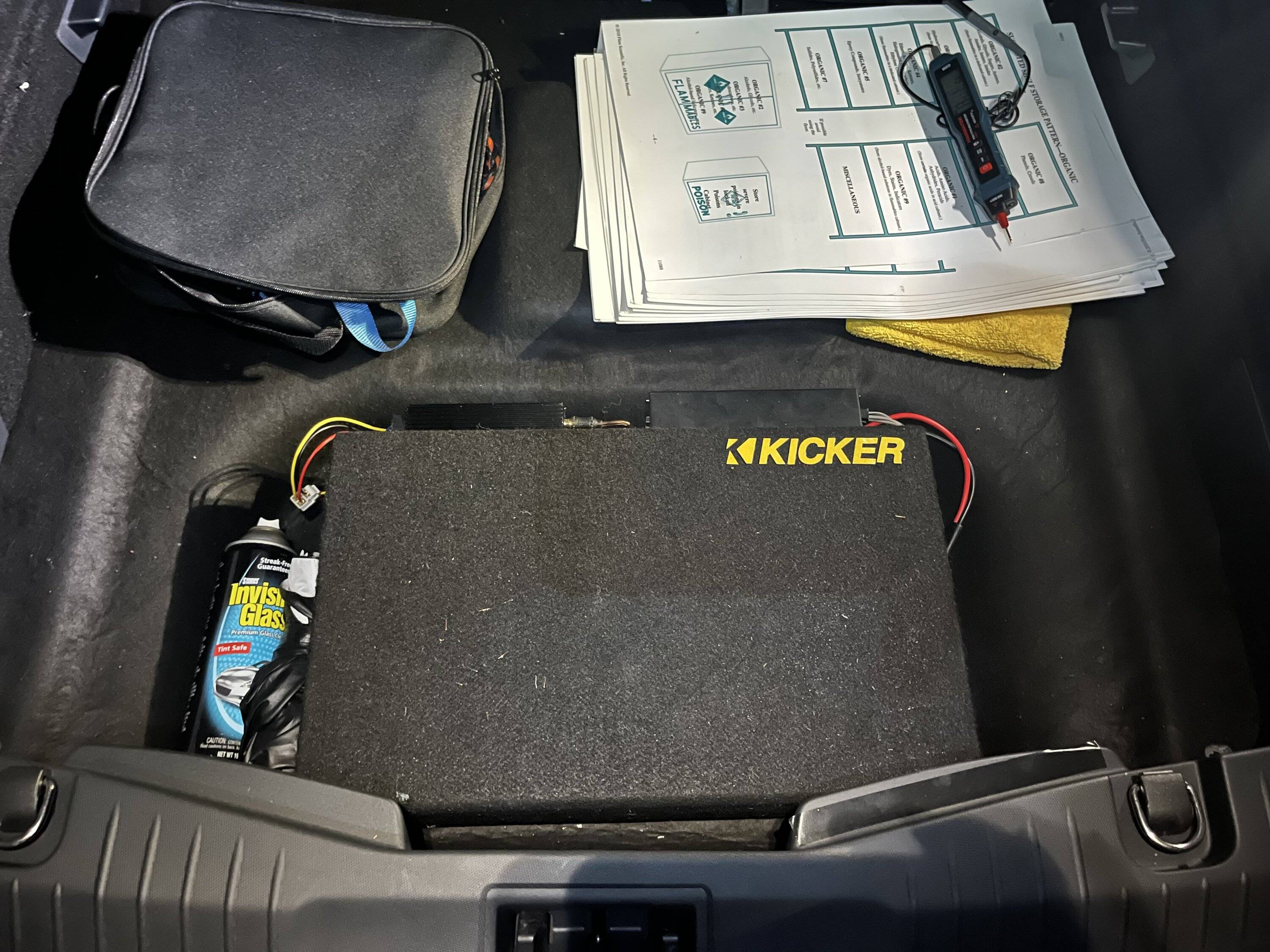

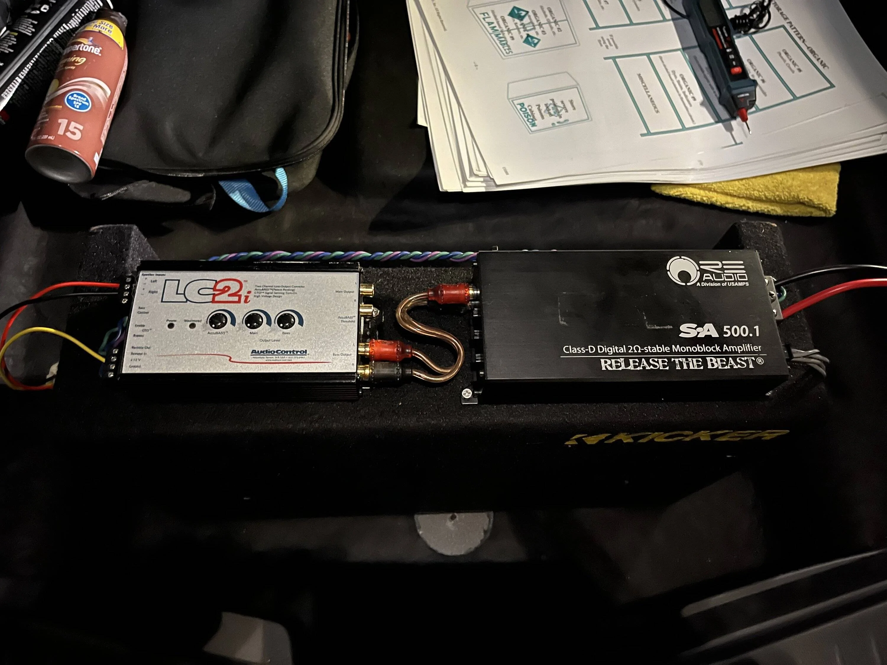

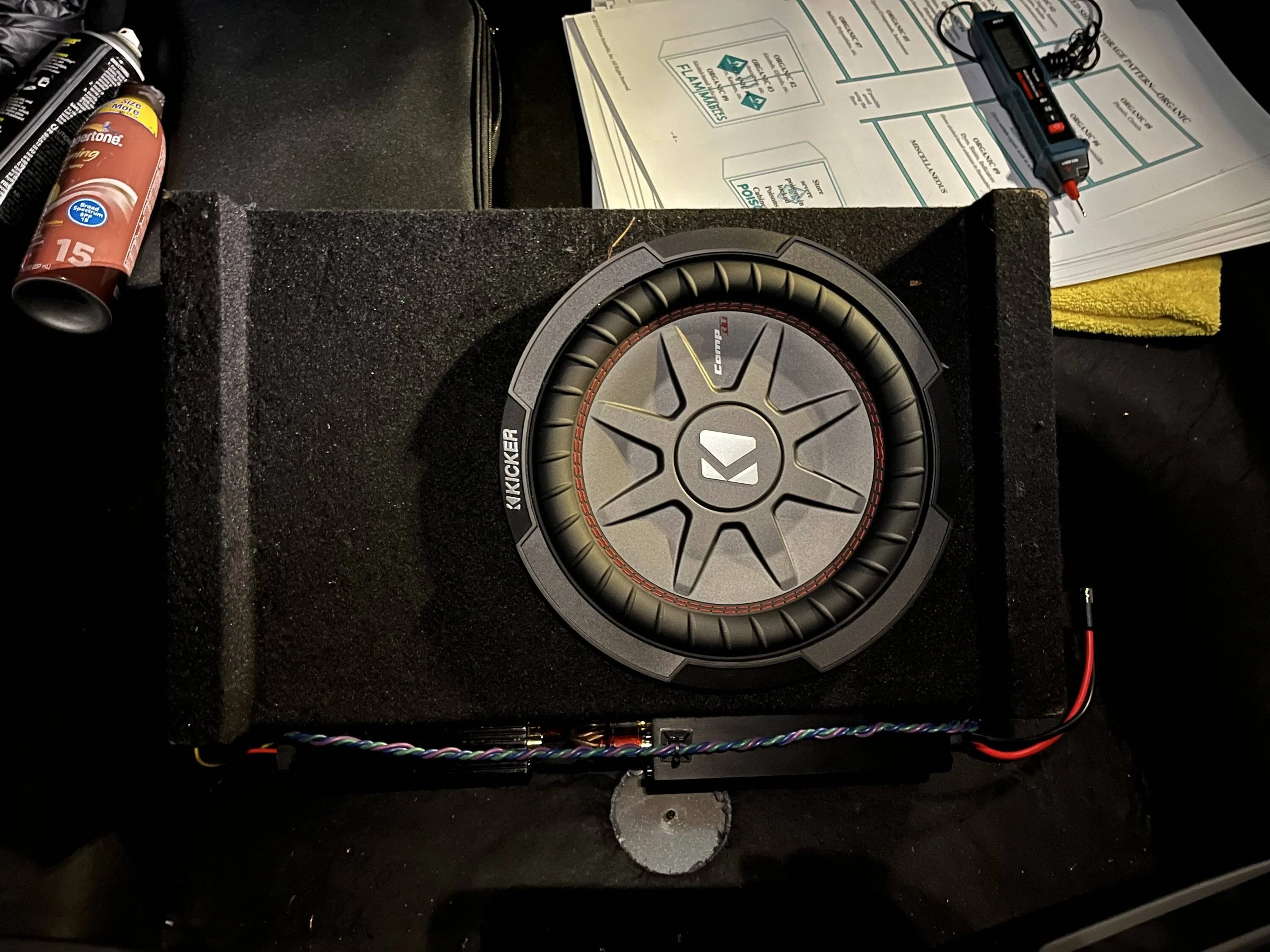

Just finished my install, thanks for the help!
One thing I will say, is that I could have easily went with the 12V outlet if I had known the kick panels would suck so bad. The frunk release got in the way, as well as the battery being more difficult to access than let on. 20 amps from the 12v by the sub is quite a bit of juice. But I’m old school, back from when every install “needed” 0 gauge lol. Seriously, my 500w peak amp will probably need to get struck by lightning to hit 20amps. Anyway, I wasted my time laying 10gauge and it was a PITA.
Had some stuff left over from my model 3 trunk hole. A shallow sub box from Amazon, a kicker 10 inch, an LC2i, and a “500 W” amp.
I used the 12v for a remote switch even though the LC2i has audio sensing. Might as well, you know the 12v turns off after a few minutes. And the weirdest thing with my model 3, is “sentry mode” would somehow trigger my amplifier to sense a signal and turn on all night long. I didn’t know if the Mach-e would do the same thing.
QUESTIONS:
1. Anyone notice that the OEM subwoofer feed tapers off prematurely at about 60Hz? It’s either crossed over to protect the OEM sub, OR the car just eats bass at that frequency. Hell, I even think the OEM sub might do a pretty good job, the bass just doesn’t make it to the driver. Not sure. Im even contemplating using bass boost… a no-no in my 30 years of car audio install.
2. my LC2i can compensate for rolloff of bass as the volume increases. It seems as if I don’t need this, as the B&O seems to boost bass output as the volume increases as usual.
Final Note: the B&O (except bass) is excellent. I’m comparing this to some pretty shitty OEM systems, but I’ve had some “decent” systems like the B&O in an Audi A3 and Fender in a Golf. I had to do some serious mods in my model 3…. The Standard Range model had the tweeters actually installed, but NOT WIRED. BUT, after customizing some crossovers and tapping in to the dash midrange speakers, I ended up with a sweet system. My point is that I do not think you will be able to gut the Mach-e system and replace it with something better.(Trust me, I’ve spent thousand of dollars on customs systems with kickpanels, 3 ways, 12” image dynamics with plexiglass windows and JLaudio amps). It’s all about tuning, and B&O did a good job on the Mach-e. You just have to get some bass in there.
PS with this setup, cargo floor needs to be in the higher position,but I added some connectors to easily remove the whole thing if I need to drop the floor.

Hey Robert, glad you got your system in and working. While it is a PITA to run a wire from the LVB to the rear cargo area, I didn't find it much worse than many other cars I have done recently. My GT500 wasn't that easy either. Where the battery is located, in order to access it to run a wire to the rear had to remove the right front wheel and inner finder liner to penetrate the firewall to get to the interior. There is always a challenge and I seem to get the more difficult ones.
Yes you are right the 12V, 20 amp circuit in the rear might be good for some smaller amps but the JL amp built into the sub I used requires a min of 30 amp circuit with min 8 ga wiring. Not that it is a large heavy duty amp by any means but like you, I am old school and like wiring my power directly from the battery. In my Escape I gutted the entire system and installed a quite high end one with Focal separates (made in France) Moscone amps (made in Italy) and JL amp and sub. I installed a second, high current 12 battery in the cargo area specifically for the audio system.
Yes I think the audio feed to the OEM sub does start rolling off around 60Hz like you say but there is no way that cheap OEM driver would be able to handle deep bass anyway. I have my crossover on the JL set at 50Hz and beings it is has a 12db slope that is fine. I just pump in that extra deep bass the car is lacking.
I agree with you on the overall sound of the B&O system in this car that they tuned it pretty well (except for the lack of actual bass). It is the second car I have ever had and I have owned quite a few, that I didn't gut and reinstall a system of my liking. While it definitely can be improved on by doing this, it would be at a considerable cost and not worth it in my opinion. I do wish at sometimes the system had more power. I did tweak the tone controls a bit and with the added sub it's a very capable OEM system. My GT500 is the only other car I haven't gutted audio wise and it too is a B&O system. It has even more drivers up front with a dedicated midrange speaker. It has a smoother overall sound than the Mach-E but not as punchy. It is all in the location of the drivers and the interior acoustics that change it up from the sound of the Mach-E. I was also lacking in bass and replaced the OEM 10" with a JL 12" stealthbox and dedicated 500w JL amp that requires a minimum of 4 ga wiring and 50 amp circuit.
I noticed the stock subwoofer does put out some good, deep bass but it is over powered by the front speakers. I had my fronts turned down to greatly favor the rear speakers and I can hear the bass really well. It sounds quite good. But I agree with everyone else that bass volume is not there especially if you balance the fade near the middle of the car.
