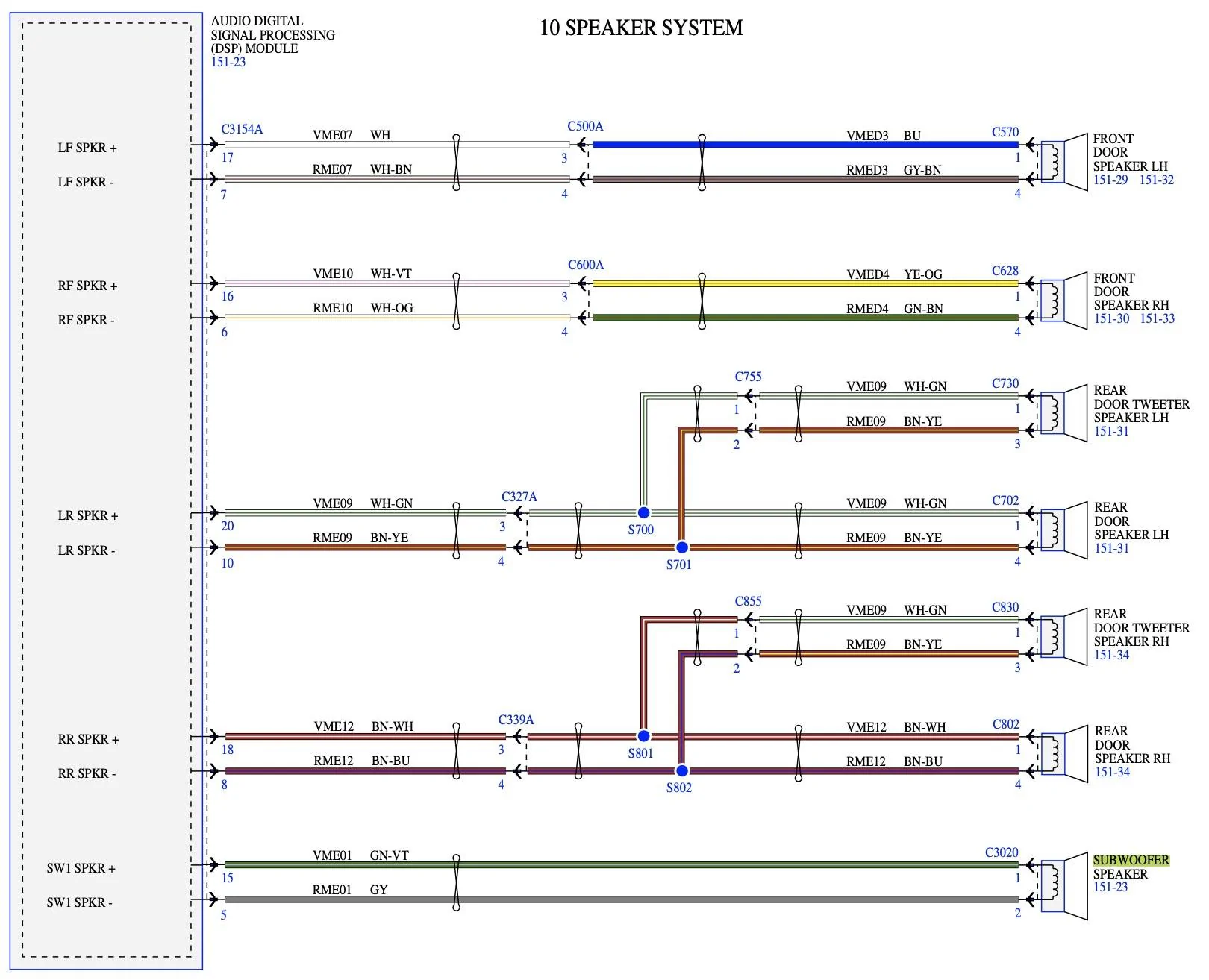

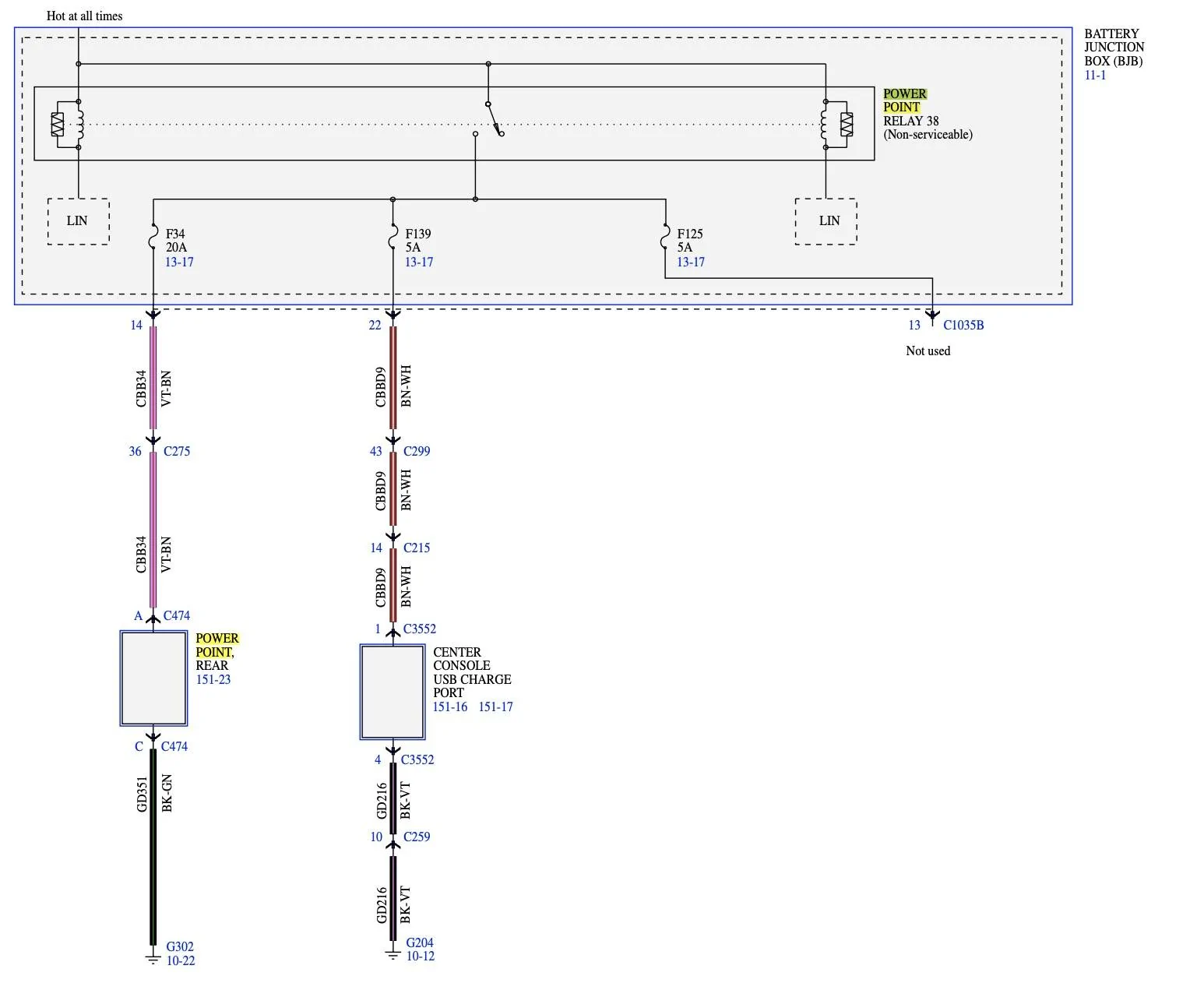

Which wire was the positive on the 12v? The violet/white or the black/green?
Also @markboris - I’ve read green/violet is the positive and grey is the negative but i can’t tell if that’s for the door speakers or the OE sub. The colors in the plug look green and black to me. I would think black would be the negative but i’ve been wrong about simpler things before. If black is negative, do I still need to flip the phase switch or would i just wire it backwards and leave the phase alone?
markboris
markboris
Nov 13, 2019
5,825
16,690
Sonora, CA
Hi Nathan, for the rear 12V power point, violet/brown is positive and black/green is negative.
You want to use the OEM sub wiring in which green/violet is positive and gray is negative. These are the wires coming from the B&O amp going to the sub, NOT the wires coming out of the sub enclosure which are different colors. They change colors at the plug that mounts to the sub enclosure.
As far as the phase switch, I would leave it at 0˚. There has been some confusion about this and have found it sometimes depends on particular sub used but I would generally leave it at 0˚. I won't get into a huge tech explanation on this but basically, when your new sub is wired properly from the OEM sub and set to 0˚, you may have a slight lack of mid-bass because it can interfere with the door speakers. You shouldn't be too concerned about this since you are adding the sub for bass, not mid-bass. You can always turn up the bass EQ in the Sync system and that will produce more mid-bass from the door speakers. If you switch the phase on your sub to 180˚, you will notice a bump in mid-bass since the sub is no longer interfering with the door speakers however, the deep bass will be less. This is why some say they have more bass output when the phase switch is set to 180˚ but what they are really hearing is more mid-bass. This is very easy to see on my audio spectrum analyzer when I change the phase switch on my JL sub.

I love how Mark knows the colors! That said, I personally rely on a voltage meter, which everyone should own! Cheap peace of mind.
markboris
markboris
Nov 13, 2019
5,825
16,690
Sonora, CA
It's not like I know these colors off the top of my head. I look at the wiring diagrams but yes I agree, I do use my volt meter to make sure.
