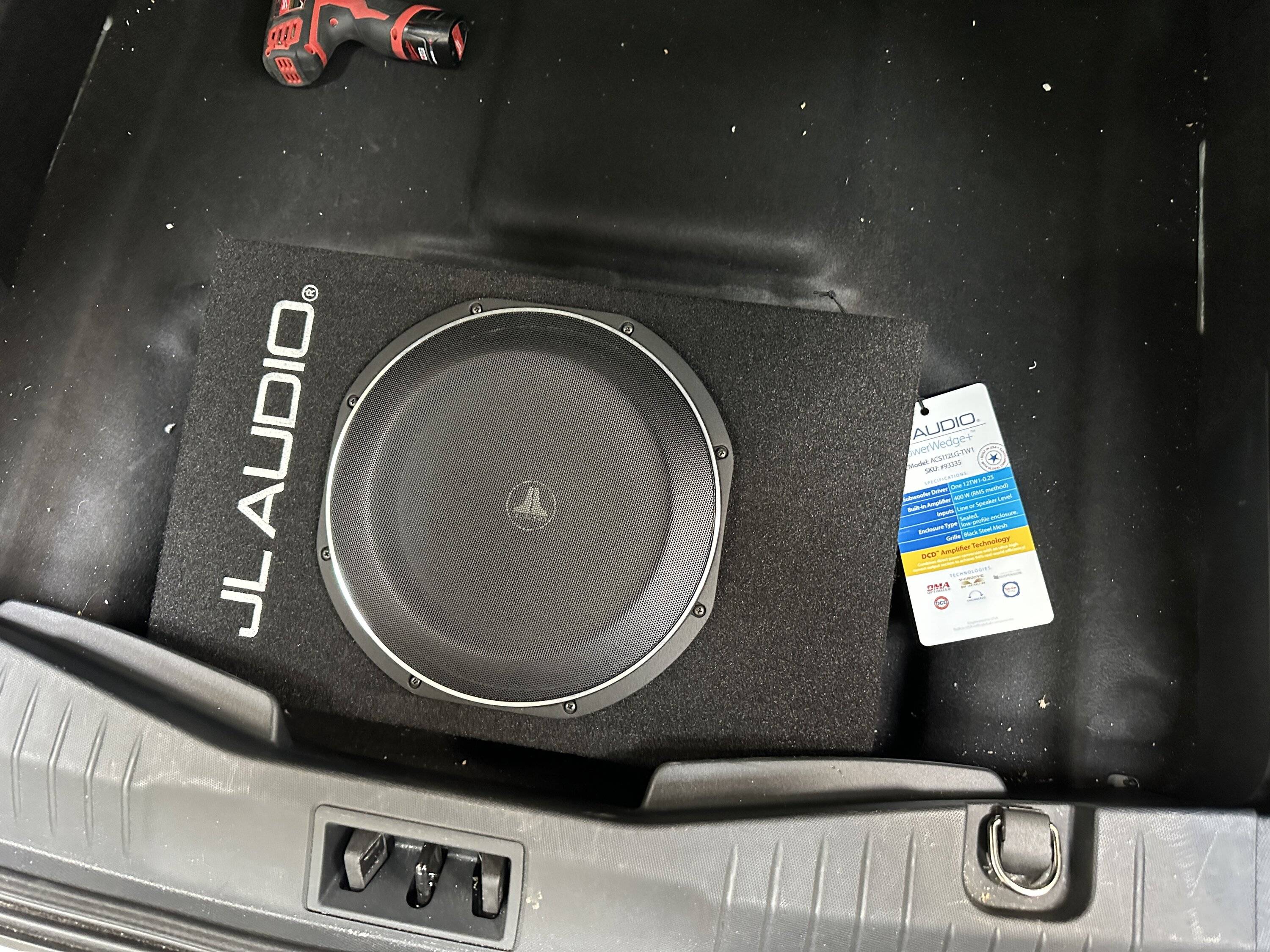

I posted a couple of months ago about my 10" sub running hot after my HVJB replacement. Fast forward to today when my autosound guy finally got the ACS112LG-TW1 as a replacement. The 10" has been back ordered for the past few months and he found the ACS112LG-TW1 in stock at another dealer and grabbed it for me. I was stoked to upgrade to the 12". The only problem is that it doesn't fit in the space that the 10" one easily fit in. I'm embarrassed to say that tehy told me it didn't fit and it didn't occur to me to try to close the flooring panel over it anyway. Looking at the photo MarkBoris posted in #14, it looks like maybe it doesn't go down in the recess like the 10" one did. It's impossible to tell from the photo with all of the other stuff packed around the sub. Can anyone tell me how the 12" version fits?
Thanks
Hi Bruce, yes the 12” does fit. I installed it in the premium I had and also have one in the GT I have now. There are quite a few other members that also have the JL 12”. You do have to remove the two studs that are coming up from the bottom that were securing the styrofoam piece for the sub to sit down in there. Also the adjustable floor needs to stay in the upper position. It‘s a snug fit but it works.
Yup, I also have the 12" installed in my '23 Premium. It is almost snaps in, perfect fit. I tilt the side toward the rear of the car in first, then "snap" the the other side down into place. As mentioned, you do have to keep the floor in the upper position, but it otherwise fits great, and sounds great!

Hi MarkBoris,
When you say remove the 2 studs, do you mean use a cutting wheel to cut off the 2 threaded screws that stick up from the floor? I peeled back the carpet from the sub floor and that's all I see that could in any way impede the sub from being pushed all of the way in. When it's installed, does it sit flush with the bottom of the compartment?

Hi MarkBoris,
Thanks
Yes, cut those off and the sub will fit flat down at the bottom

Hey MarkBoris & Kmp14!
Thanks so much for the extra guidance! Thanks to you both I was able to get the 12" wedged in there. It sounds & Feels Excellent!
