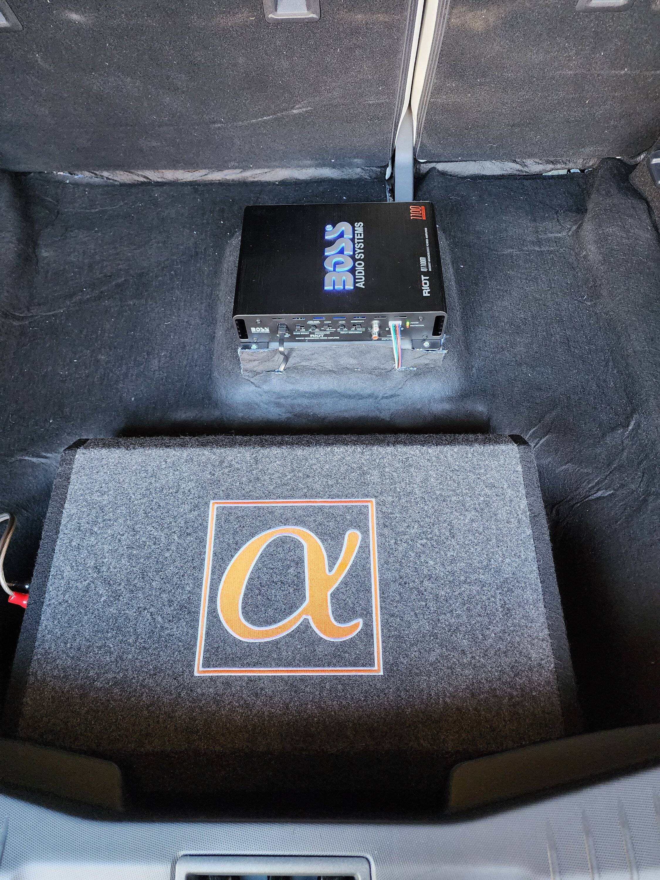

Hey folks. I am one who wired my 12” JL to the 12v outlet supply and swapped to a 25a fuse to match the 12v. For the longest time I hadn’t had any issues, but lately the subwoofer is cutting in and out intermittently during songs- particularly ones with a lot of bass and when the volume is a bit higher (13-16 is high in my book). I have the level under 50% on the sub itself and 2 notches below center on the bass EQ in the car, so I’m definitely not pushing the sub very hard.
Most of the time I can unplug the sub and I won’t run into the problem for a few more days, but then it crops back up again. It’ll get worse as a drive goes until it cuts out for almost an entire song.
Obviously my first thought is the 12v outlet wiring, but I haven’t read of any others having problems and I went many months without a single issue as well.
Anyone have thoughts on this or experienced the same? Curious if I just need to RMA my sub. Thanks!
