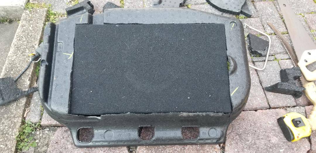

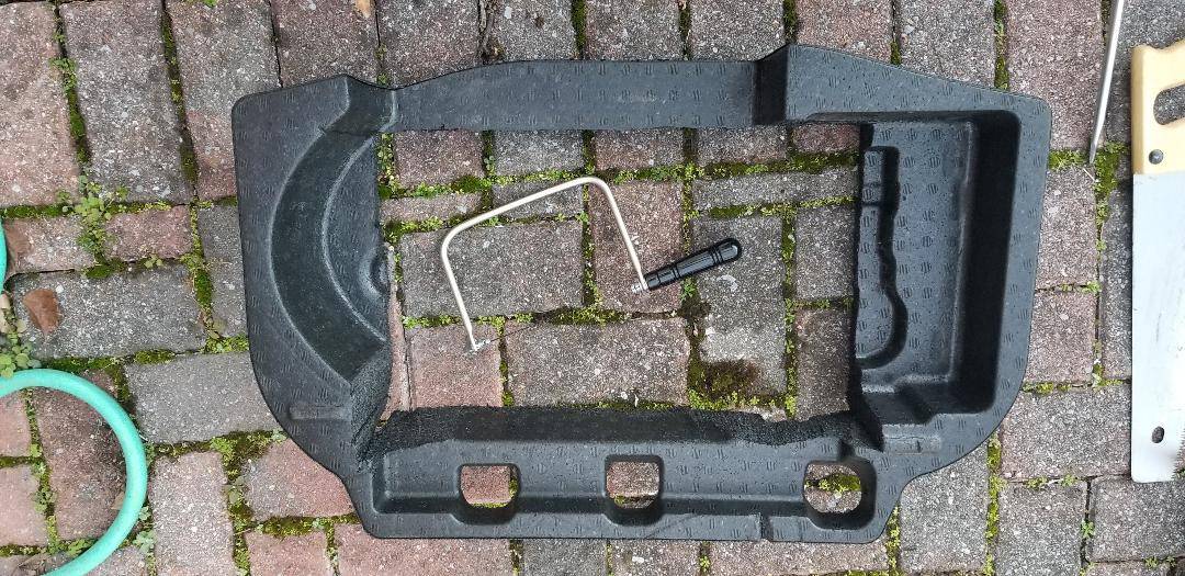

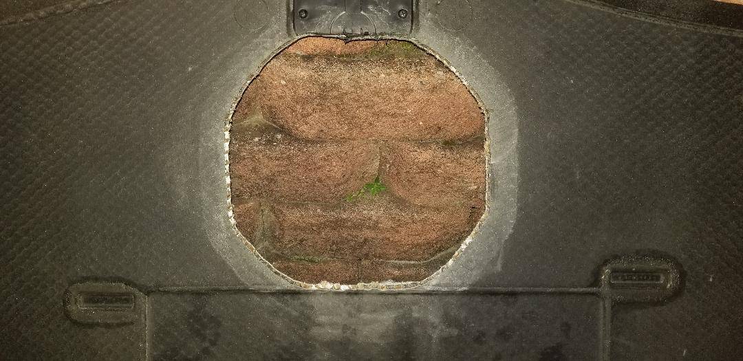

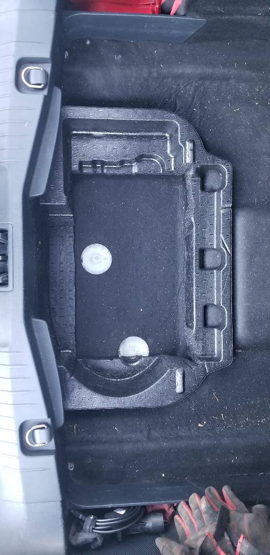

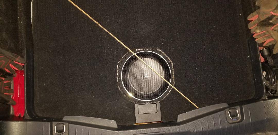

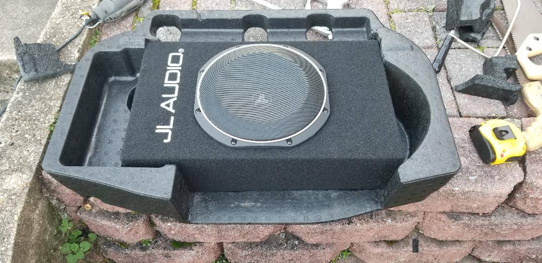

Today in prep for a trip to western Colorado next month I installed the JL 10-inch sub as described by MarkBoris at the beginning of this thread.
My twist is this: I found a way to make the mounted 10-inch JL sub absolutely level with the floor in its lower position when the floor is weight-loaded, the position in which my floor lives. I always carry the ModernSpare spare wheel + jack on the trunk floor, tied into the four trunk cargo rings. With the ModernSpare in its center position, I need all the trunk volume I can get above and around the ModernSpare for the other stuff I carry.
Step 1: I preserved the hard grey under-floor styrofoam, and cut out a rectangular well in the center (well, almost in the center) for the new JL sub. The styrofoam preserves the original floor support height with its thick outer parts, and gives me four small storage pockets around the new JL sub.
...and yes I did Dremel the two vertical floor pins that held the styrofoam unit in position, out as they really have no function once the heavy JL sub is inside the styrofoam. The sub is about 3/4 inch off center because I aimed to preserve as much as possible the styrofoam's thick support "pillars" to bear the weight of the removable floor above it. See the 1st several of the attached pix.
I used a Dremel with the tile cutting attachment for the rough early work, and a coping saw for fine work in corners and a metal hacksaw for longer finishing cuts through this dense styrofoam.
Step 2: at this point, the JL sub was resting in the styrofoam on the subfloor's felt mat, and while the JL's box was even with the top surfaces of the styrofoam, its speaker grille and the grille ring protruded 3/4 inch above the styrofoam's "pillars". I measured a round 10-inch opening for the JL's grille at the appropriate place on the underside of the trunk's removable floor and Dremeled it out, again with the Dremel's tile cutter (heck I can always get another floor from a wrecker yard if I don't like the result, I figured). The removable floor is a heavy cardboard honeycomb well-basted on both sides with resin (that resin gives the floor its drumlike sound and feel), and the visible black felt is glued onto the resin face. The Dremel's tile cutter cut right through.
CAUTION: anyone doing this is well advised to cut out the opening in the removable floor outside because the resin creates a lot of nasty fine grey dust all over the work area.
I then re-measured everything in place and fine-cut the opening a bit more to account for the JL sub's metal grille ring, which has four flat sides in amongst its circular shape. This made everything fit exactly right, whereas my previous circle cut wasn't quite right and the floor's weight had been actually resting on parts of the sub's metal grille ring. See one of the later pictures for this adjusted opening's shape.
RESULT: I assembled the floor onto the top of the styrofoam / JL sub assembly. Nothing wobbled and everything fit as if this was OEM factory-measured. Without load, the wooden straightedge shows a teeny bit of space above the grille (see pic). With my weight on the straightedge, the black floor felt gives enough so that the straightedge just barely touches the grille's top ridge.
I always have the OEM rubber Mach E mat over the floor of the trunk, so the sub grille's top ridge will touch just the bottom surface of that Mach E rubber mat. Therefore, no dirt should fall into the speaker cone.
I now will hunt for some rubber or plastic 3/4 inch C channel to seal the inside edge of the floor's honeycomb where I cut the speaker grille opening.
How does this installation of the JL sub sound? ...I don't know yet. I ran out of daylight (1939 driveway, no garage). I'll run the wiring on Thursday after the rain moves out. Hope this helps others out here.
...and yes I noticed I misspelled "styrofoam" on several pic labels. Smartphone - to email - to laptop, and no glasses on while hurrying up before dark, and all that...
