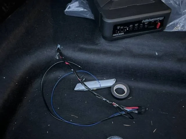

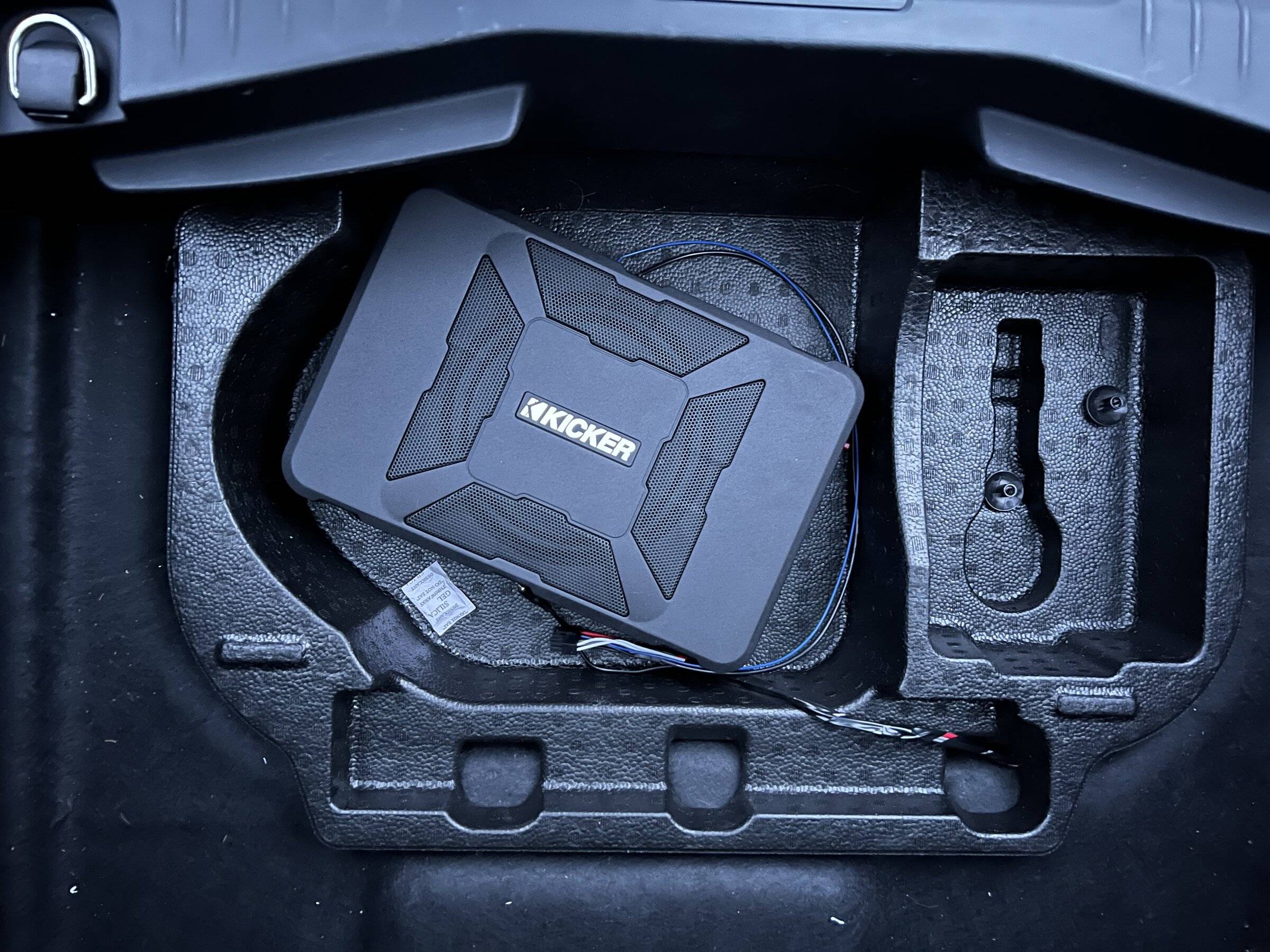

My project started today…. Thanks for the guidance @markboris!!
I cheaped out though as I had BestBuy points - so I paid nothing for the highest rated sub-in-box they carried. I’m probably setting myself up for disappointment; but it can’t be worse than the factory select bass.
Ford Mustang Mach-E Adding a real subwoofer w/amp to your Mach-E 6FBC8A6B-5E72-40BE-95CB-EE7B6EB05DBD
Ford Mustang Mach-E Adding a real subwoofer w/amp to your Mach-E 3021F55E-A1D0-4A9E-B38D-E1F332F20DC4

All hooked up and it sounding great. I even got the remote base control knob mounted where @markboris mentioned ?
Ford Mustang Mach-E Adding a real subwoofer w/amp to your Mach-E 1F29F147-2F1E-4961-A4F3-8CB3D41548CC
One caveat though - that I’ll need to figure out (may be to how I hooked it up…)
12v switched amp turn works (as in I shove the turn on lead INTO the power connection)​
The DC Offset (speaker level offset turns on amp) will not turn on the amp - the guide says it needs a 6v differential to turn on the amp. I have only hooked up the left channel; wondering if both left AND right are required to trigger the differential?? Would think it’s just signal based, but that is not turning on the amp.​

It’s a bit MacGyver but could not get the darn DC offset to trigger turn on the amp. So, I tapped into the 12v switched power outlet in the back for the remote turn on signal. It’s a blue moon when I’m driving without the stereo anyway. All buttoned up and loving having the additional low end again!!
