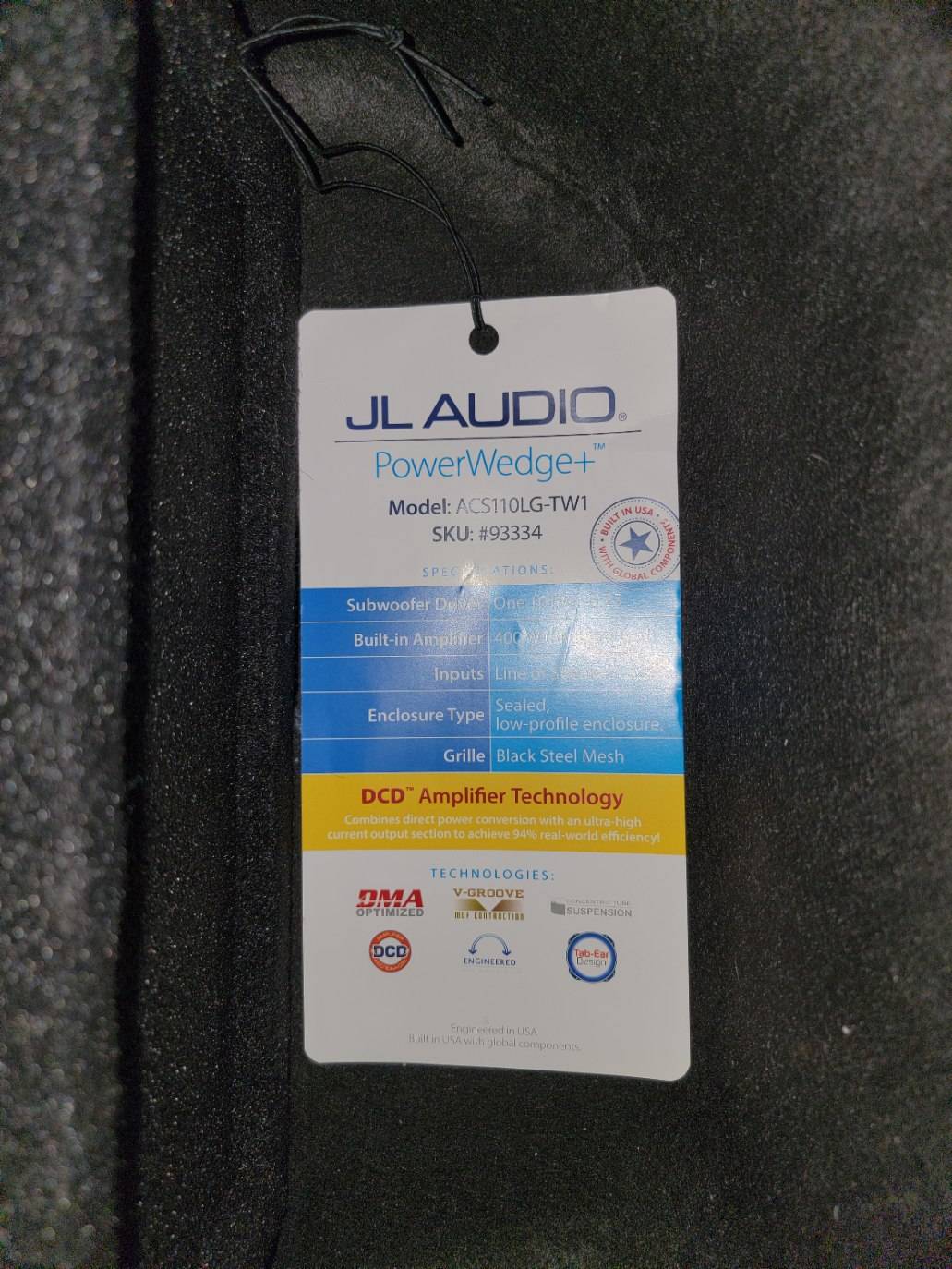

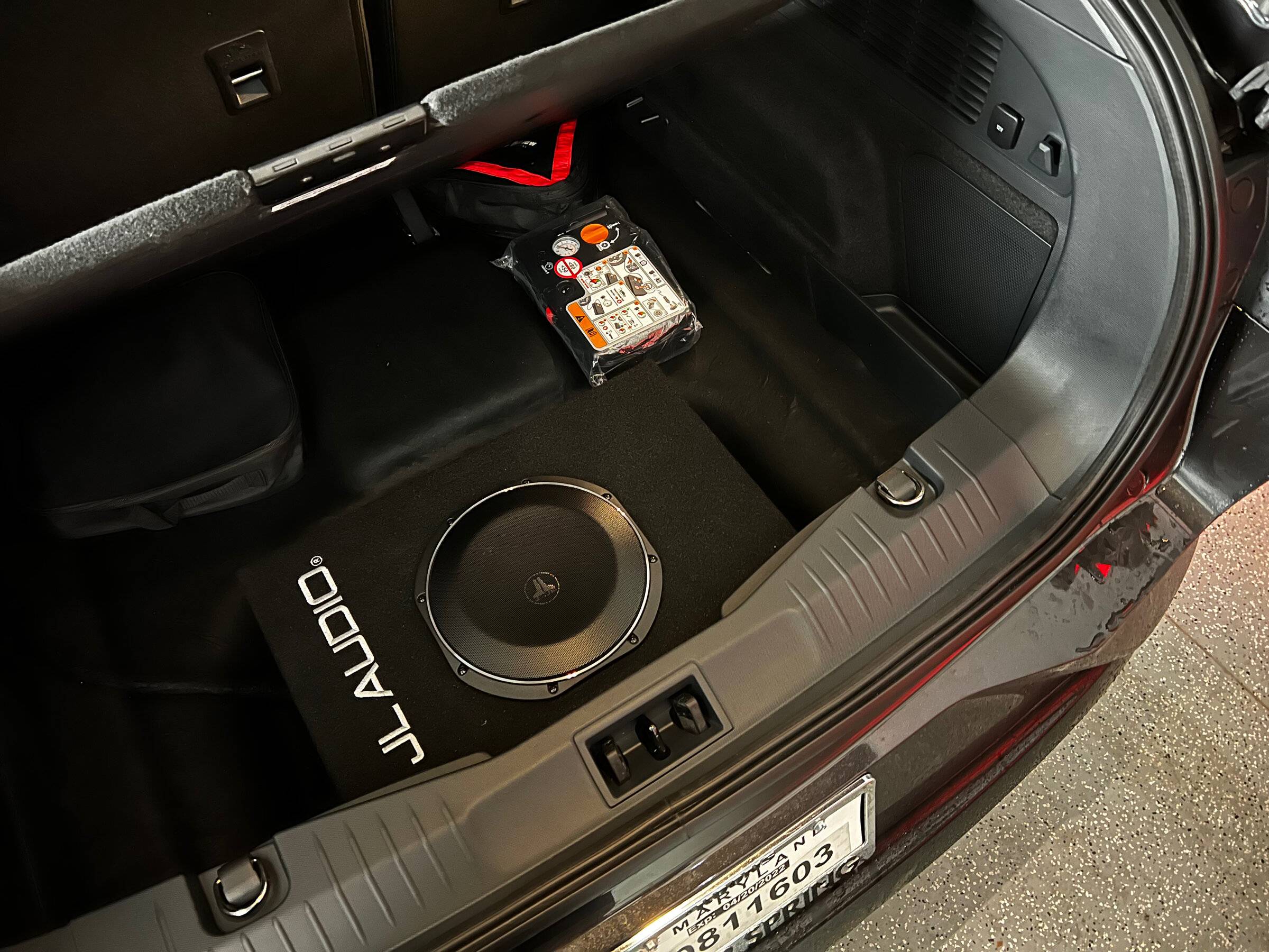

I have the Mach E Premium RWD and I can attest that the OEM sound system is "not bad" but definitely underwhelming (for a car in the $50K+ range and considering the B&O hype). So, after reading the numerous posts in this thread it was somewhat refreshing to hear I wasn't the only person with this sentiment.
Added the 10" PowerWedge (ACS110LG-TW1) a few days ago and I must say I am quite impressed. This thing thumps, trust me. If you're on the fence, don't be. It was almost too much thump at first, but I adjusted the settings (as @markboris suggested) and it sounds great!!! Only difference is I have my input intensity set all the way to low. It fits perfect and is a nice clean setup (few pics below). Worth its weight in gold in my opinion.
Thanks to all for the insightful comments/recommendations!

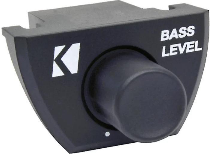

@Polar how did you mount the bass control knob? I have the Kicker sub also but my bass knob is one big assembly like below. Was yours the same? It doesn't feel like the knob pulls off.

The knob does pull off. I thought the same too when I went to work on mounting mine - get a thin flathead and use it as a lever.
Once you have it off take a good look at the design and depth as if your going to hard mount it like @markboris or I did this is a long unit once the cord is attached - you’ll have to line it up space behind it (where the cover attaches)

Ahh, thank you. Got it. I was afraid of using any force as it's plastic.

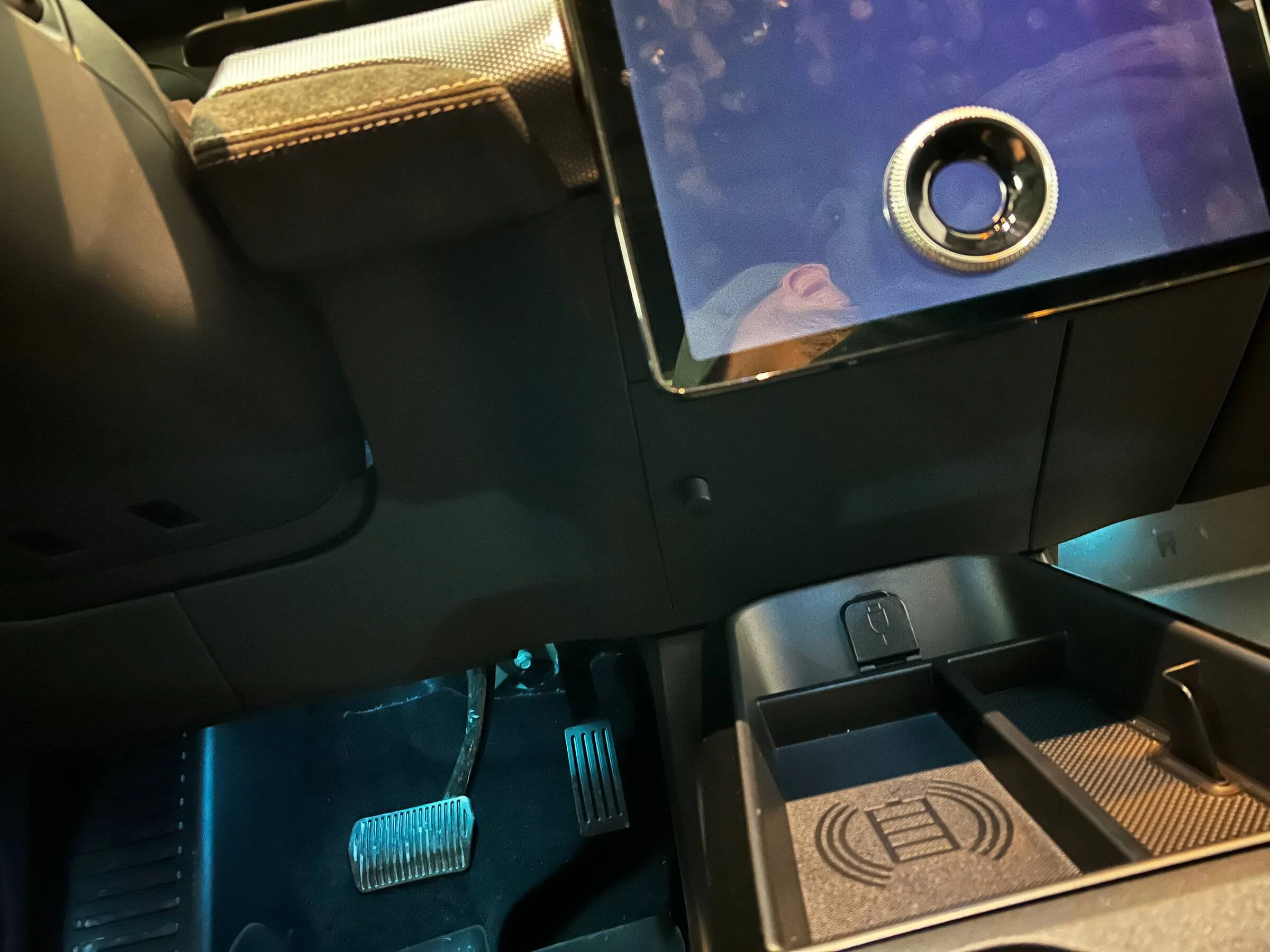

Thanks for this thread, had a local installer add the JL 10TW1 Microsub and remote to mine today... The surprised me with the remote install, but def not noticeable, and easy enough to access. Very nice upgrade to the low end for sure! Thanks for the writeup and review on this @markboris
