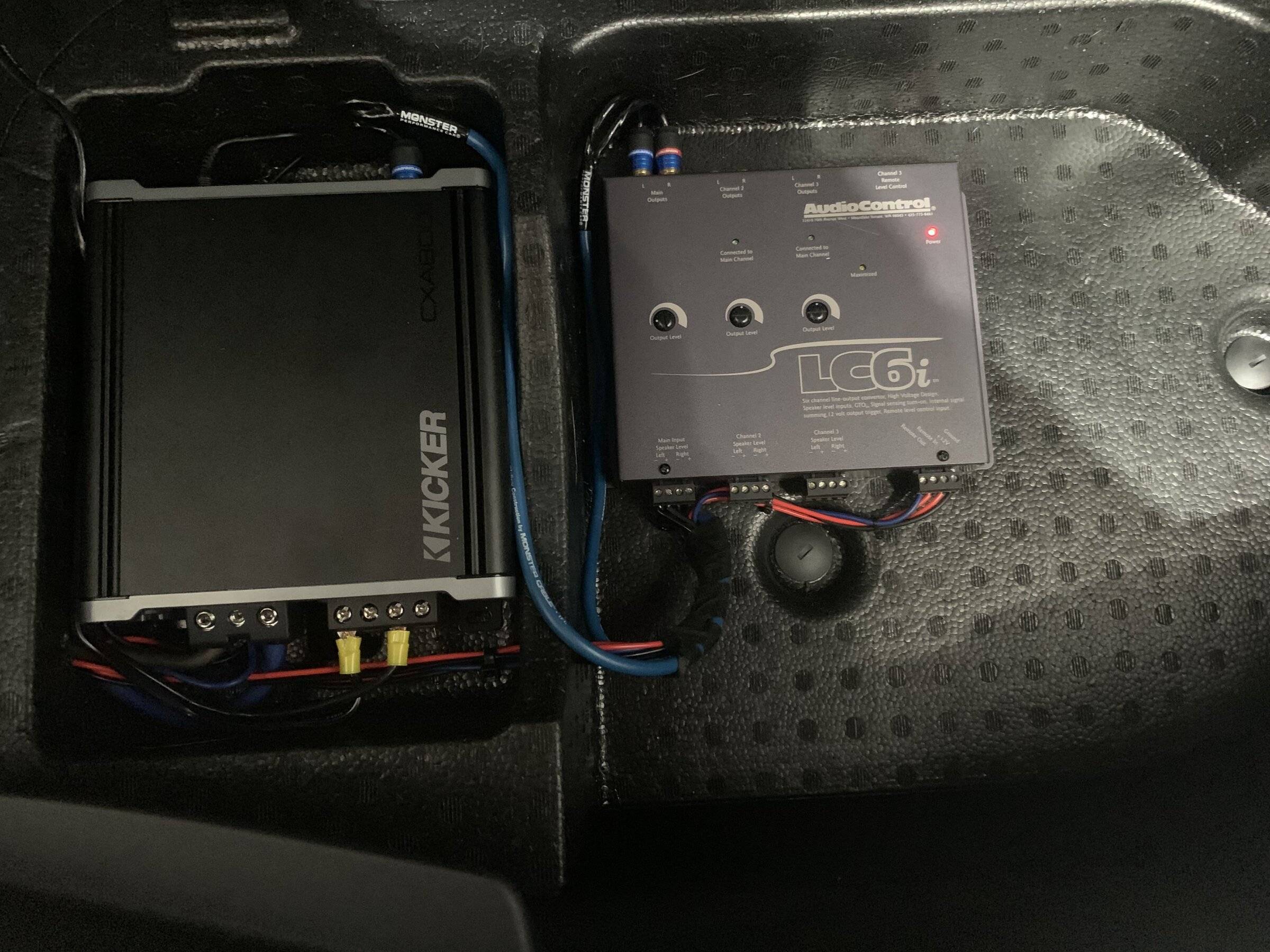

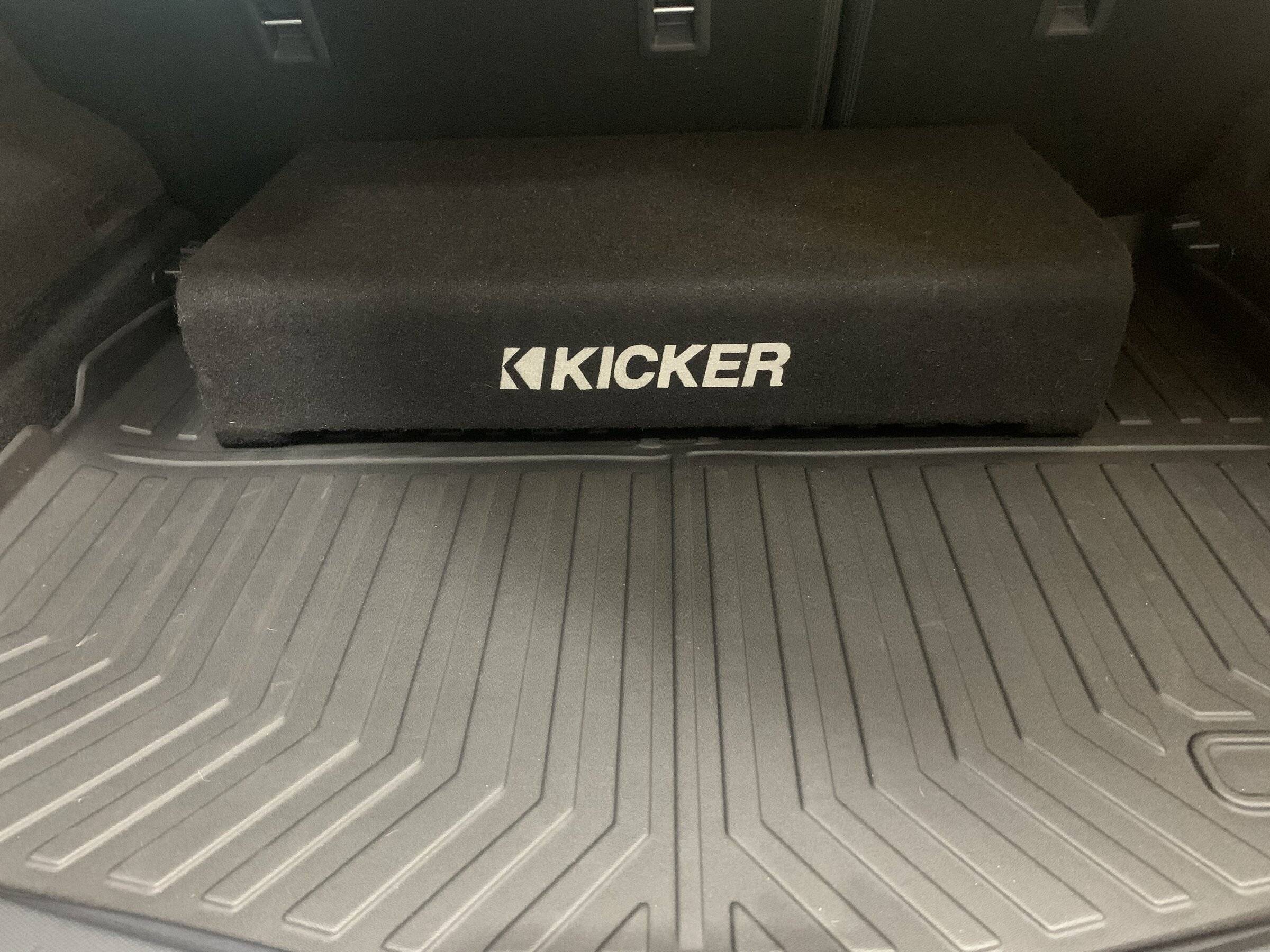

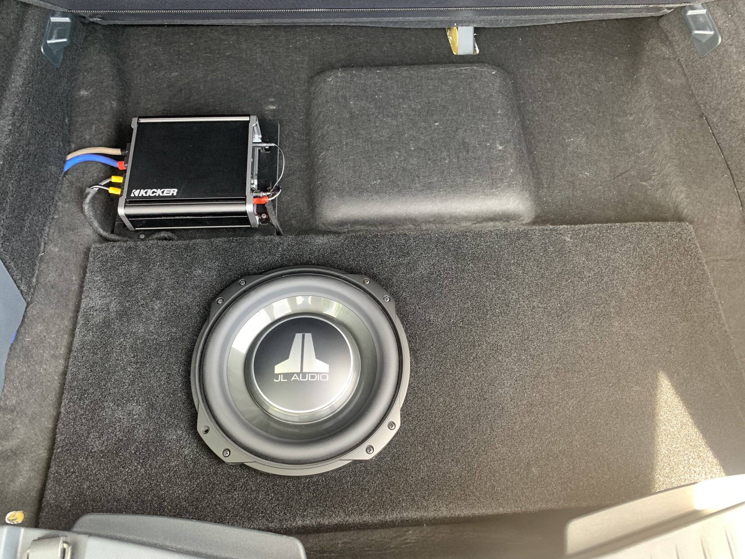

It took a while but it’s done
With the help of my friend, grabbed the power, ground, signal all from the left side of the MME. The only reason I didn’t go the route that Mark did was I had extra equipment from my other car. The back up plan was to get the exact JL sub with built in Amp and a whole lot faster.
Nevertheless
Here is my equipment:
Kicker flat 12” sealed box, Kicker Mono Amp CXA800.1: 300 watts RMS, Audio Source LC6I converter which is for multiple amps but since I had might as well use it. 8 Gauge wiring kit
Thank you @markboris for all his write ups/support. He is the Man!
Nevertheless
I couldn't leave it alone......
Had an audio shop customize a fiberglass box underneath the floor board so no box will be up top.......Kinda like what @markboris did but my Sub/Amp are separate....
Man does the 10" Flat JL Audio slab nice/tight...It sounds pretty good with stock speakers but knowing myself.....Next is to replace all stock mids/highs and add a DSP to it.....

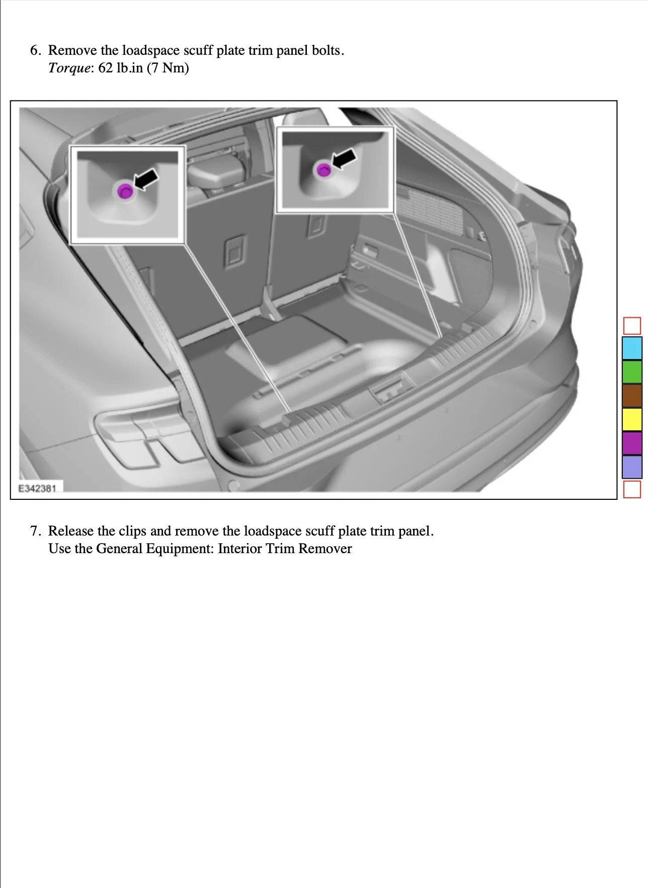

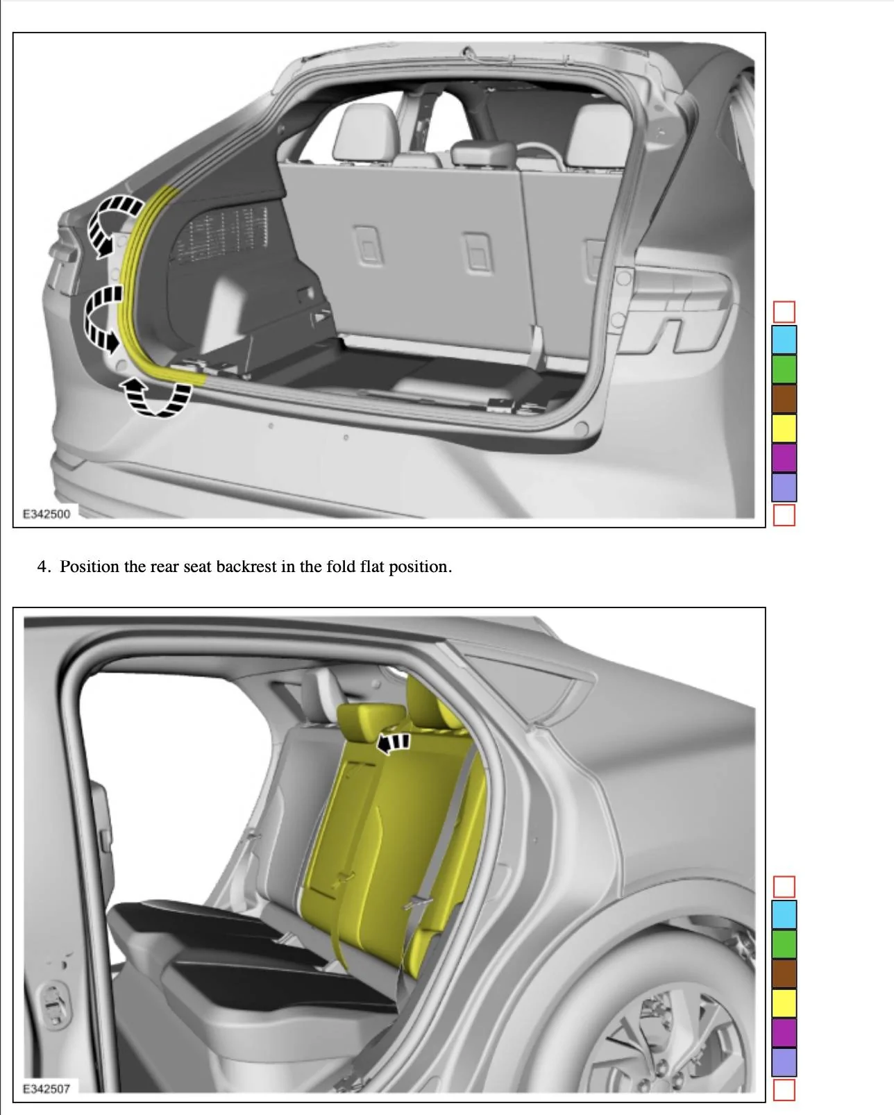

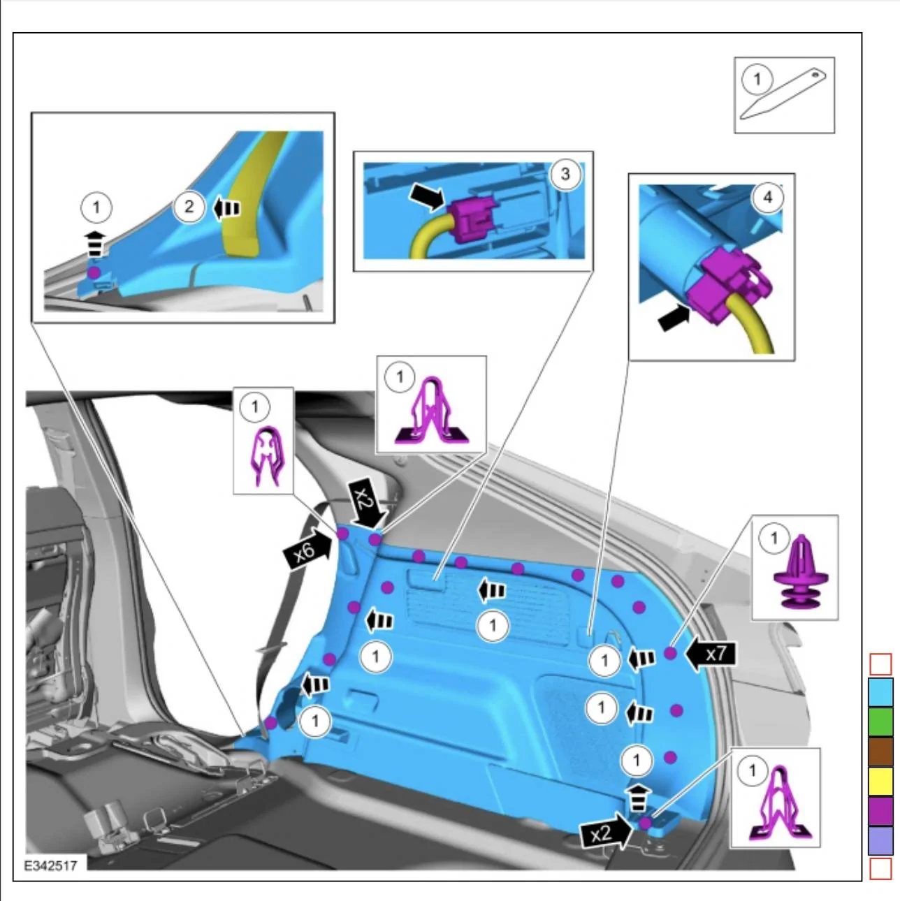

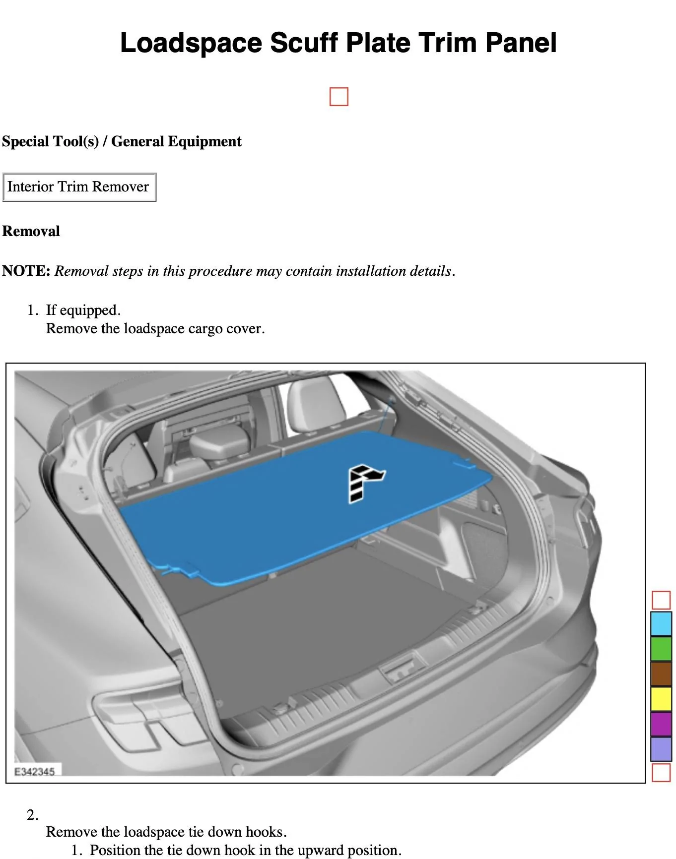

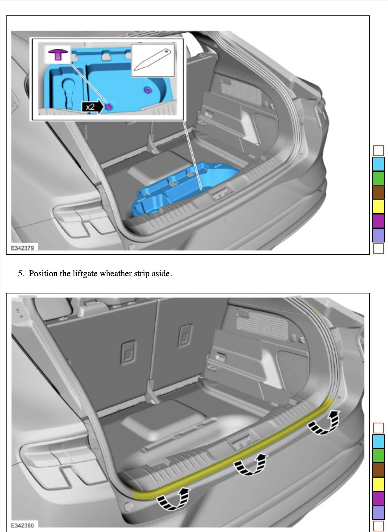

Do you have any diagrams for removing the paneling for where the oem subwoofer is?

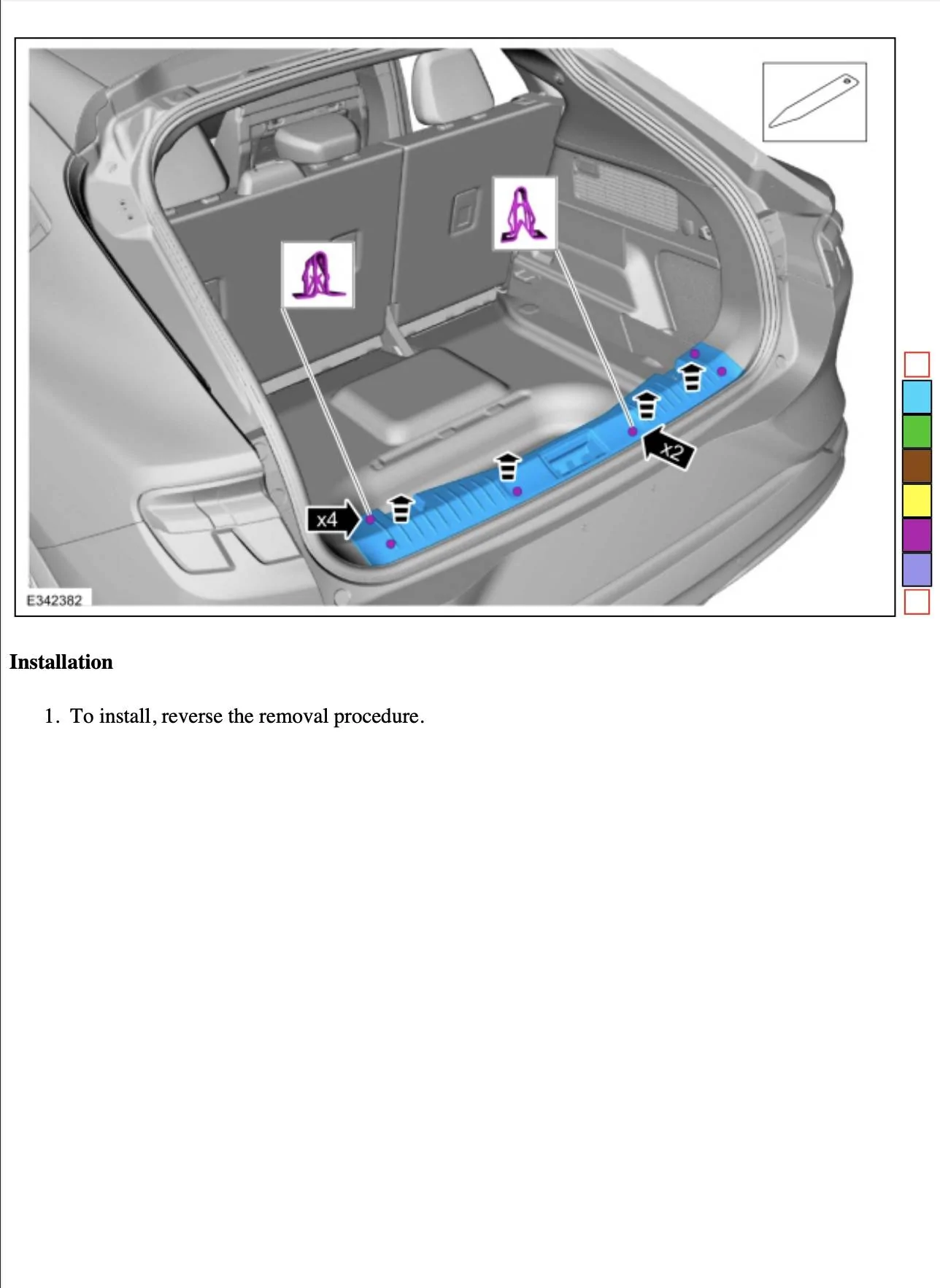

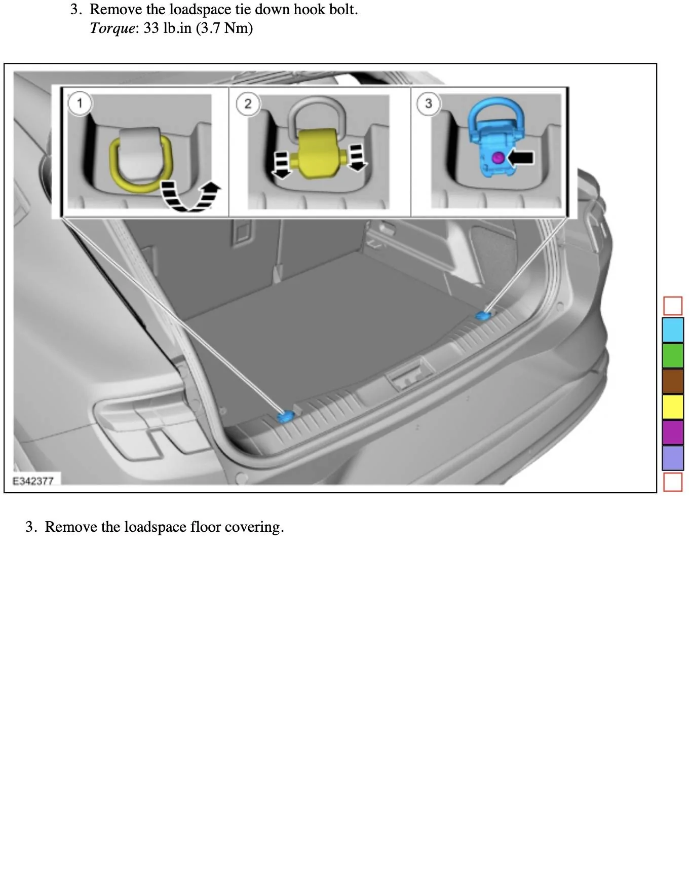

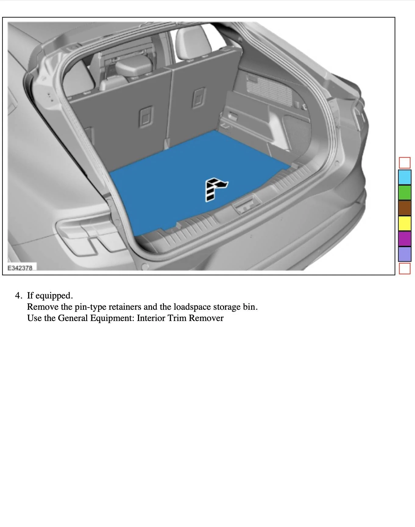

Hi Dan, you don't need to remove the entire panel as shown in the last photo. Just pull the rear half out and then you can get to the subwoofer. In order to remove the entire panel you need to remove a bit more than what I posted in these photos.

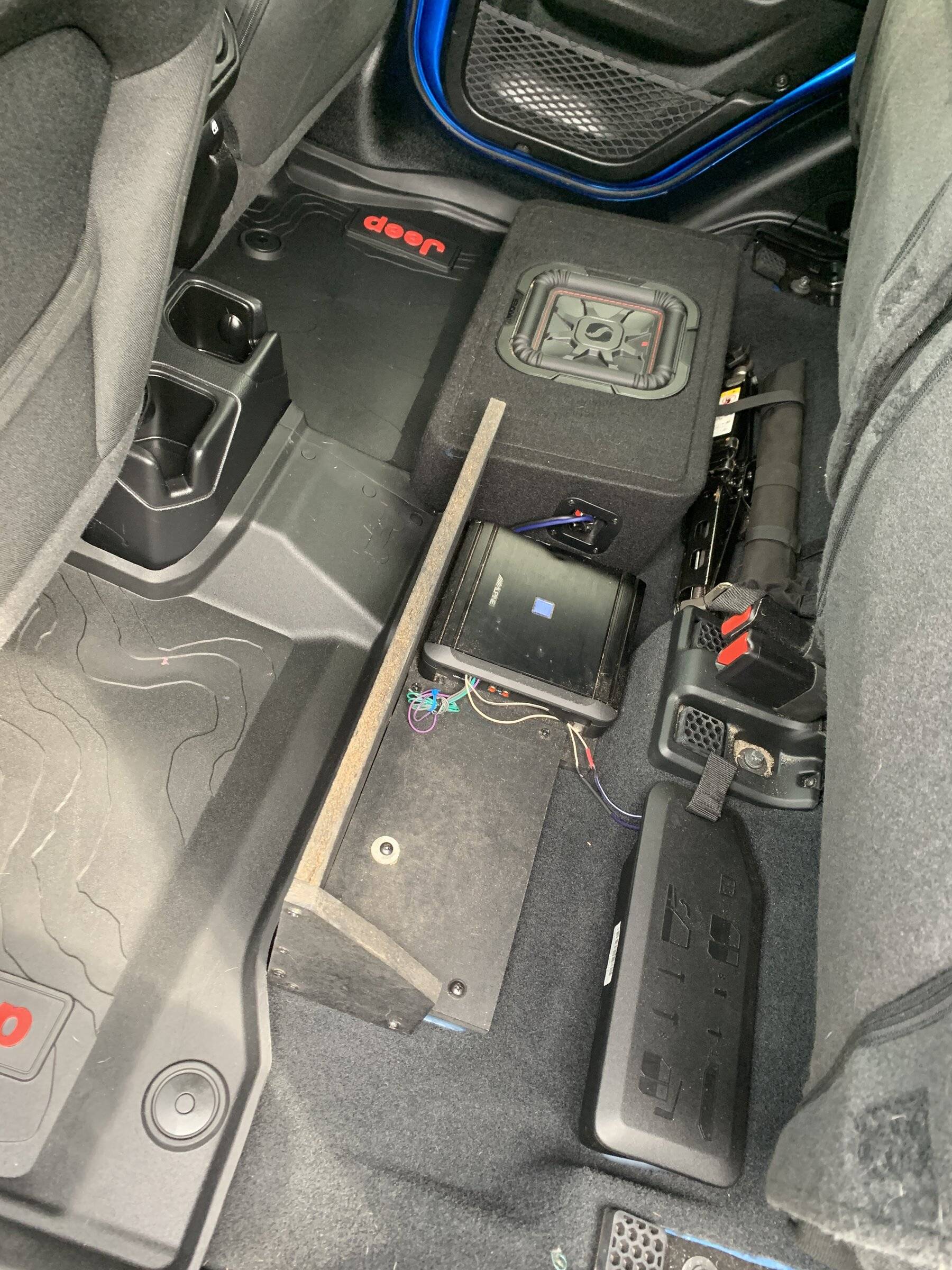

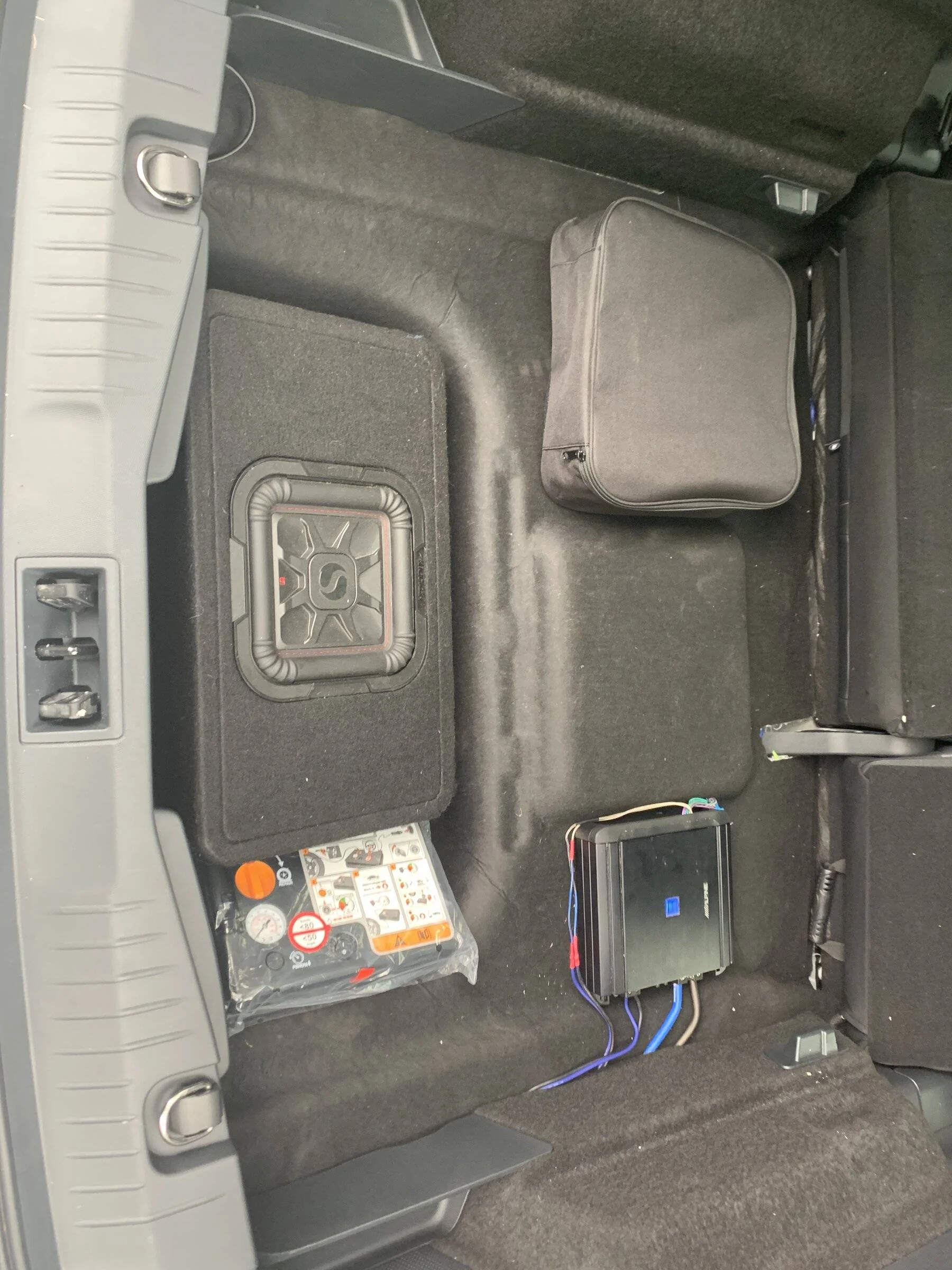

Thank you so much to @markboris for posting this.
I recycled this kicker 8” square and alpine amp previously installed in my gladiator…. I was worried the kicker box wouldn’t fit but works great with floor in top position.
This required 4ga wire but it still fit through the same grommet. I followed some other directions for how to completely disconnect battery/fuse box with that green pull tab.
Here’s the setup in both the gladiator and now mustang
