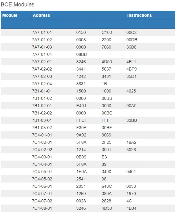

You can edit asbuilt data. However, the problem is that no one knows what any of the values are to change. There are a ton more values on this car than any I've had before.
This is an example of what the data looks like:
Ford Mustang Mach-E Ambient Light Missing in Settings 1617919304289
