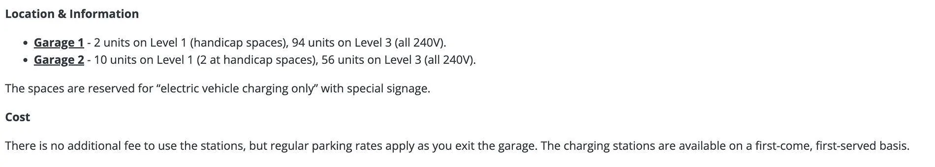

It's an L2 charger at my airport's garage - they have 150 of them there.
