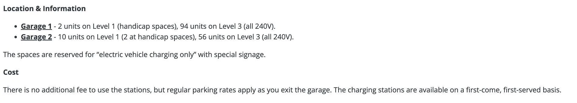

I've never seen a public charger, L2 or otherwise, that allowed long term parking. But the car does not lose much charge when simply parked, even if it is cold. I noticed it does not want to be parked with a LOW charge on cold days ... it warns about it.
This sounds plausible for my situation. The chargers - and there about 150 of them and they’re always full- are L2 chargers.

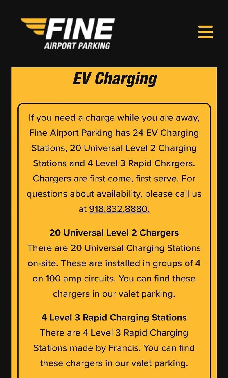

One of the parking garages at the airport here in Tulsa has chargers for their customers. It is definitely a thing

It's an L2 charger at my airport's garage - they have 150 of them there.
