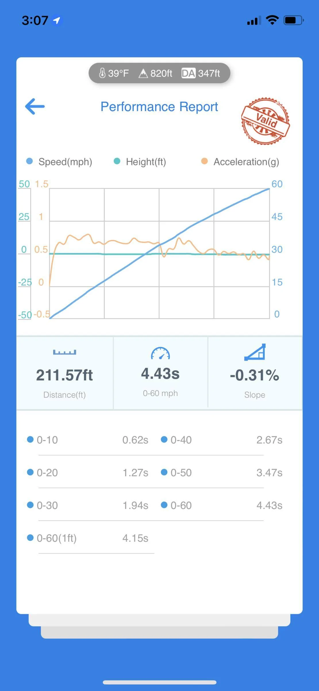

Reading this thread and got a little chuckle about ICE rwd vehicle traction control performance vs. EVs. Some makers have better TC programming than others. For sure. Here is what GM/Holden came up with for my ‘14 SS Sedan - stock was 415/415 hp/tq, I’m at about 465/465 right now. This run was on Continental ExtremeContact Sport SUMMER tires in 39F conditions on a regular road, no grip of track surface or burnouts. Traction Control on.
Ford Mustang Mach-E AWD better in Midwest 56B5C3C8-8C98-40AB-8107-8A529854F489
For reference, the best our 4X has done from 0-30mph so far is a 2.1. I know it’s apples/oranges, but, GM, Porsche, BMW, MB all have TC programming down so well now that on the street you’re a fool to turn it off thinking you’ll be quicker. Track is a different story altogether.
