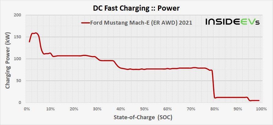

I highly doubt the curve has changed for <80%. I've performed several charges since then, and the behaviour is essentially the same. The only reason mine might be slower is because of the cold battery at the start, but the battery warmed up not long into the charging session. Above 80%, it now takes about an hour to get to 100%, mostly because after 95% ish the charging rate drops down to almost a trickle, and the last couple of % takes forever, as it was before. It does stay at about 44kW up until 93% or so, though.
Per Darren Palmer on InsideEVs, the DCFC profile was optimized for the best conservative 15 minutes of charging and to go 10% to 80% in 45 minutes. But there were two expected changes before winter.
  • 80% charge cliff moved/changed
  • Faster charge times
So it sounds like you're saying that we're only seeing the 80% cliff gone but so far, no difference from 10% and it still looks like this profile to 80%:
Ford Mustang Mach-E Customer Satisfaction Program 21P22 - Software Calibration Update img-ford-mustang-mach-e-er-awd-2021-dcfc-power-20210308
Yup, I believe the exact phrasing for the satisfaction program states "faster total charge time", which includes that 80% cliff.
I understand your concern about the restarting thing, though, so if no one makes a video by next week, I'll record my sessions when I make my 600 mile roadtrip. The trip involves hitting all the EA chargers I can hit, so hopefully I'll be able to record a good session without having too much range anxiety ?
