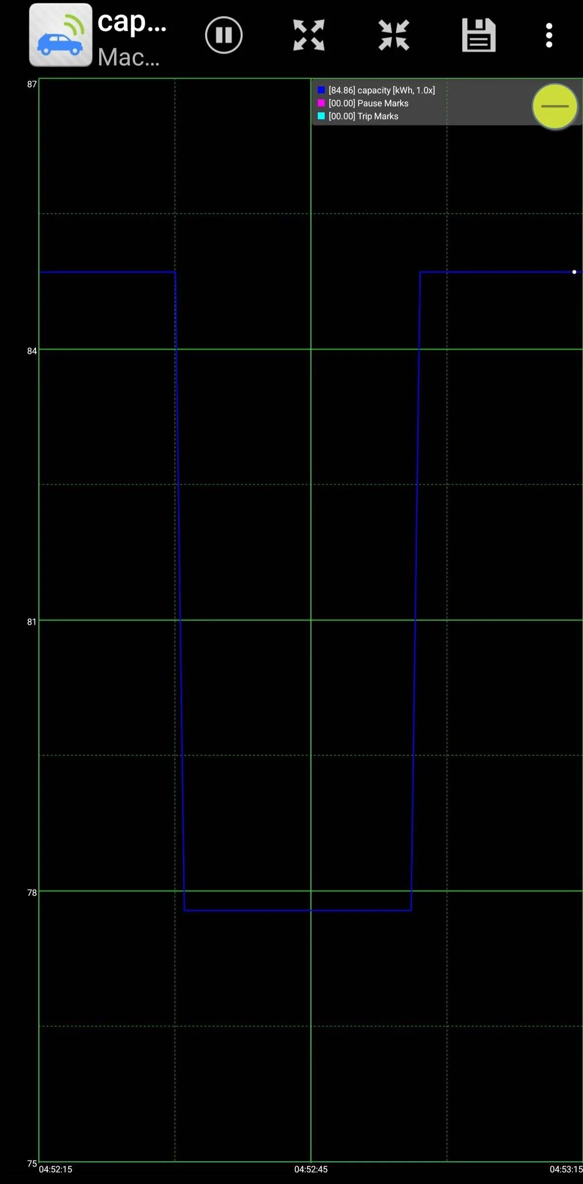

Make sure you are using the SoC Displayed parameter. There are two. One is the overall Pack SoC, including the buffer. The SoC displayed is what is actually shown on the dash and useable.
At 100% charge, Energy to Empty, and the Calculated Capacity should match.
And Like I said, its not always accurate. That Energy to empty value seems to jump around a lot.
Here mine seems to want to jump between 77.7kwh, and 84kwh.
If you charge to 100%, what value do you see for HVB Energy to Empty?
I did it yesterday and I had 60.79 kWh (100% displayed SOC, 95.38% real SOC%). I'm not sure it's reliable. Battery temperature was 30F
I've noticed it gets less accurate when you're just sitting not driving. It seems to jump back and forth between a few values. I'm not sure if its an issue with Torque reading it or what. It seems like if I view the Energy to Empty value by itself, it shows accurate. And then when I go to the calculated capacity value, it jumps back to a lower number, like that calculation is messing with the actual data.
But if you say between 77 and 84 it's far from accurage since you're supposed to have 88 or 91. What is the maximum you saw at 100%?
11,356
24,986
Remember the available battery capacity will go down when it's cold. You'd have to check in +25ĀŗC conditions if you want to compare directly to the 88/91 kWh spec.

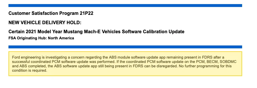

I totally disagree on your definition of CSP. It is a voluntary recall generally.
Usually a CSP is mostly seen because something is broken or can break resulting in increased warranty claims. Several CSPs on other Fords have been PCM updates that keep engines from blowing up. In recent history the 1.5L EcoBoost had one to run the electric coolant pump after the engine shut off because they had issues with them blowing up from sitting with hot coolant.
Let’s be completely real though…CSP 21P22 fixes a lot of software bugs that I would count as broken stuff that the car was released with. The cars mostly worked without these updates but there were issues. My FE had serious bugs! When was your car built? Have you experienced an early build cars software woes? The CSP for PAAK also was to fix something that was broken.
Honestly the more I think about it almost all CSPs are to do with problems and not improvements. Granted it is an improvement if it solves a problem.My truck had a CSP to get first gear replaced because the transmission would eventually blow up if you didn’t. It would likely have blown up out of warranty too but Ford was trying to avoid a lawsuit over it down the road. So in this case…my truck would not have worked fine without the CSP being done.
