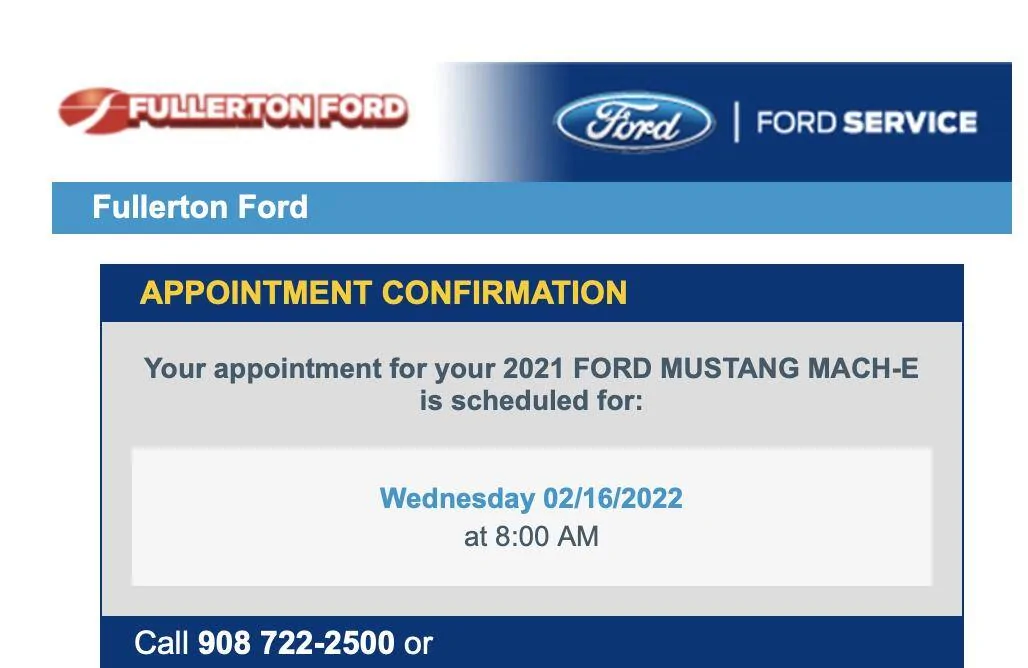

I scheduled an appointment with my dealer yesterday to have the updates done, I was shocked at how far out appointments are?
Anyone else experiencing this?
I am not getting the roof or windshield done, but when I inquired they told me they are not doing them right now since replacement parts are backordered. Mainly if the windshield breaks you are going to been in for a long wait.
Highly recommend calling to make your appointment. Make sure their EV tech is on duty when they schedule you for. Make sure they don’t have a single bay devoted to EV’s that will already be in use. Scheduling online just books their next available spot, not necessarily the time they can fix your EV.
Guess I should have said this as well, but I made the appointment directly with the service manager over the phone. I asked why so far out and the answer was that they are jammed packed busy right now.
When I scheduled me I asked what parts are needed? They tell me the gadget for the glass roof gets replaced not reused
