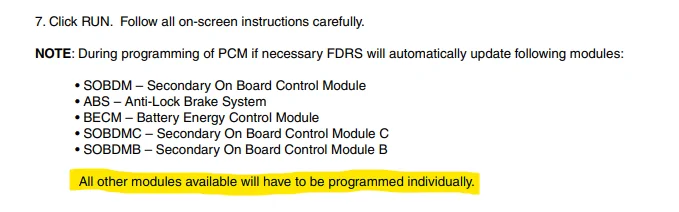

Sounds like the dealer only did page 1 of the 21P22 instructions (that happened to a friend of mine too but we caught it before they left the dealership). They totally skipped the remaining pages.
The dealer thought that all of the modules updated automatically with the PCM update, but they don't.
Page 1: says to keep going.....
Ford Mustang Mach-E Customer Satisfaction Program 21P22 - Software Calibration Update 1645564934360
Page 2 has the BCM, OBCC and door modules etc.
Thank you very much for pointing this out. Based on experience with Ford’s instructions to customers, I can see this as a mistake a tech could easily make, reading those instructions. To be honest, I really want to move onto a new dealership and just let my previous bad experience stay in the past. I’m just gonna let that previous shit go and give a new dealership a try as my 10K service is just around the corner. I’ll ask them to perform the same update.

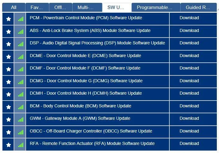

Hey Neil, could you or anyone else run mine as well? Would really appreciate it!!
Got mine "done" last week but I still haven't noticed any charging speed improvement beyond 80%. Starting to think they didn't fully update all the modules!
VIN: 3FMTK3SUXMMA03611
Thanks!

Well, you win the shady dealer lotto. They entered in 21P22 into FDRS so they could bill it and did NO updates. Below is what is STILL available.
LOL! I knew it! It was too good to be true when they called me in so quickly. Now I'm wondering if I should just wait until the BC in-dealership update or maybe I want these updates done so that I can get BC OTA...

What software version have you received OTA? If you're on any of the 2.XXX updates, then I would think you're fine to get BC OTA. It would all depend if you really want anything in this update or are having issues - Fan noise while level 2 charging, PaaK reliability fixes, door issues (front door not unlocking unless another door is unlocked first), charging curve improvement, GOM accuracy improvements, etc. Doesn't look like you have an APIM or TCU update available, so I'd think you're on at least 2.1.0 with 2.3.0/2.4 being next since you have the GWM update available?
Also, keep in mind it might be harder to come back the longer you wait, if your dealer is a lame-O, to do all the updates. And since they already billed it for your VIN, it will be tough to find another dealer willing to take it over, so to speak.
