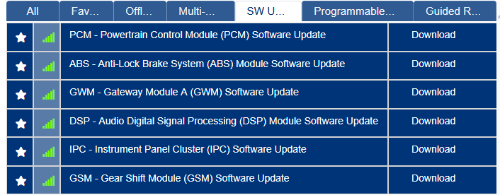

Well, you win the shady dealer lotto. They entered in 21P22 into FDRS so they could bill it and did NO updates. Below is what is STILL available.

Hi Neil,
Just had my update done last week.
could I trouble you to run mine.
3FMTK3SU0MMA00667
I haven’t noticed any increased range.
All I have noticed is that when it starts charging, it is much quieter while charging. The normal charging groaning noise on the car has disappeared.
thanks in advance!
Happy to, looks like you have a few remaining updates available and can cross check these with 21P22 to see if any were missed, but I believe the only one was OBCC. It does look like they did do the ABS update but that one bugs and doesn't clear. They also do appear to have done the OBCC update but I'm unsure why it wouldn't have cleared by now, it didn't throw any errors. Your car appears to have the GWM bug where it says ethernet failure with IPMA. I'm surprised they left this and didn't even apply the GWM update you have available...
You can google "DSP Mach e bulletin" and find the relevant TSB for that one and the others not part of 21P22 and try and get the dealer to do them by claiming the relevant issue in the bulletin, if your dealer is unwilling to just do them all for you.

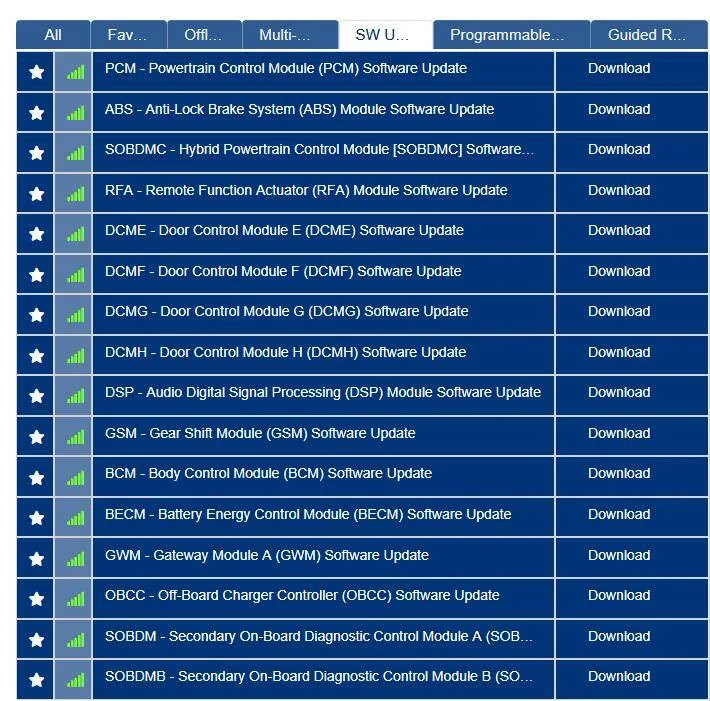

Sure, here are the updates still available for your car.

That is accurate, ABS doesn't clear when its done successfully, it is bugged. But these updates are not that new, I don't believe. So him saying they just came out isn't correct, I think they just stuck to 21P22 and ignored the rest. Super odd when they were getting that error and still chose not to do the update to try and fix it. Hopefully they're kind enough to do these for you.
269
18,230
28,656
That's literally the list from 21P22. And that's all you're entitled to free, unless you have a demonstrable problem solved by a TSB. Keeping every module updated is not part of the dealer's responsibility, nor of your warranty.

The PCM update likely wasn't successful since it's still on the list.
