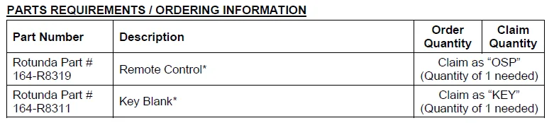

22B10 calls out a very specific part number that the dealer is to order to fulfill that program. It's likely the same fob you probably have now.
Ford Mustang Mach-E DIY: Key Fob with Frunk Button ! 22B10_fob_164-R8319

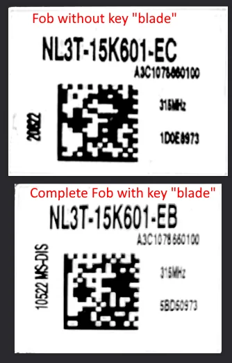

The Lightning fob part number I got directly off the fob I got from my dealer's part man.
There are three different numbers depending on where you look. NL3T-15K601-EB is the entire Lightning fob with the uncut blade. You can order it without the blade (backup key) and just use the one you already have cut...and that would be the same part number but ending in an -EC instead. Ford also uses another part number for the same item and it is a Rotunda part# 164-R8304 (or run together 164R8304).
And then there's the FCC ID Number that was registered by Continental Automotive Systems (the same people who make tires make car security and engine immobilizer systems). And the FCC ID for this key fob is M3N-A3C054338. I saw where somebody posted that their dealer's parts guy said it wasn't valid....well that's where I got mine, from my dealer's parts guy using Fordpass points. So I know the number's good.
These are the actual stickers from the back of the fobs when I got them:
Ford Mustang Mach-E DIY: Key Fob with Frunk Button ! Lightning_Fob_Stickers
