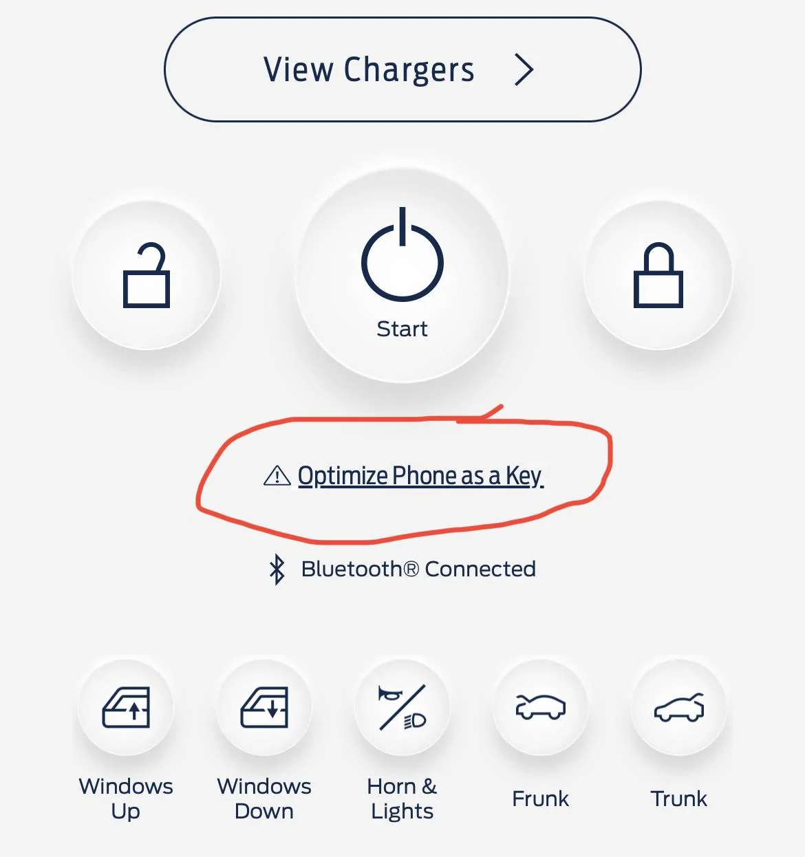

With Fob = 100% unless car is in sleep mode, then just like a laptop, one press to wake up & one to activate.
PAAK= well this is where it’s tricky. I have figured out that my phone is a key is actually pretty close to 100% accurate if it has been utilized recently. If my phone has been away from my car for some time like overnight it will not connect to the Bluetooth. I have to essentially close the app and reopen the app and then it connects automatically works perfectly. But as you can imagine that’s kind of a pain in the backside. But I still exclusively use the phone as a key on weekends when I don’t need a key to the office.**and the App has to be open on the screen to work. I don’t believe that’s the case for Elon’s crew
11,400
25,122
Having the app open certainly helps, but doesn't have to be open provided PAAK has been fully optimized on your phone. If you see this message on the home screen, click on it and follow the step to correct the settings so it works in the background.
